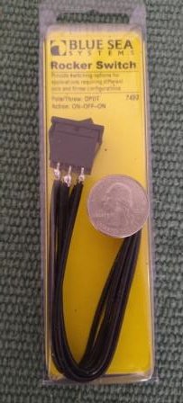

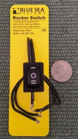

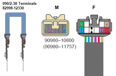

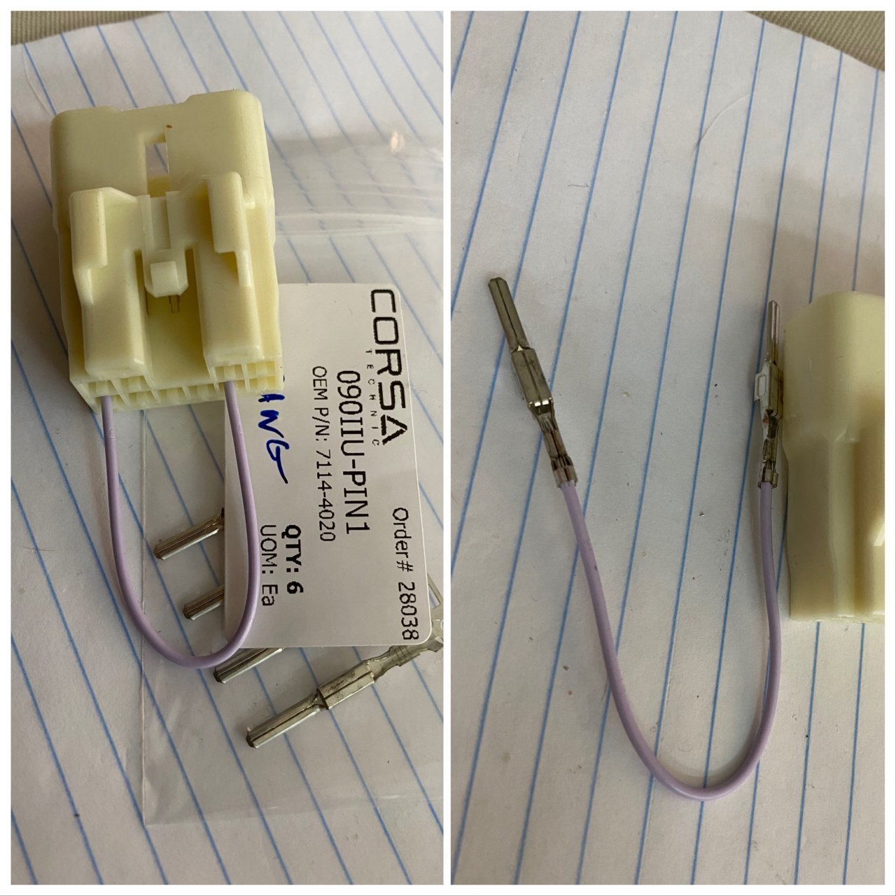

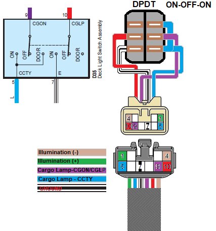

    No need for the OEM switch if you get a jumper wire and connector.
    They would be ON with unlock/lock like the cab illumination.
    Or add a small dpdt switch wired same as OEM switch. There are options.
