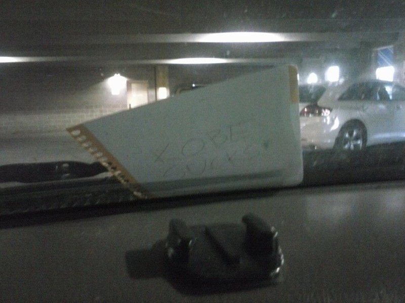

    In fact here is a pic. One of my Fantasy Basketball foes left this one on my window at work but you can see how my GoPro mount is set up. Had to dig through my phone to find this one! haha
