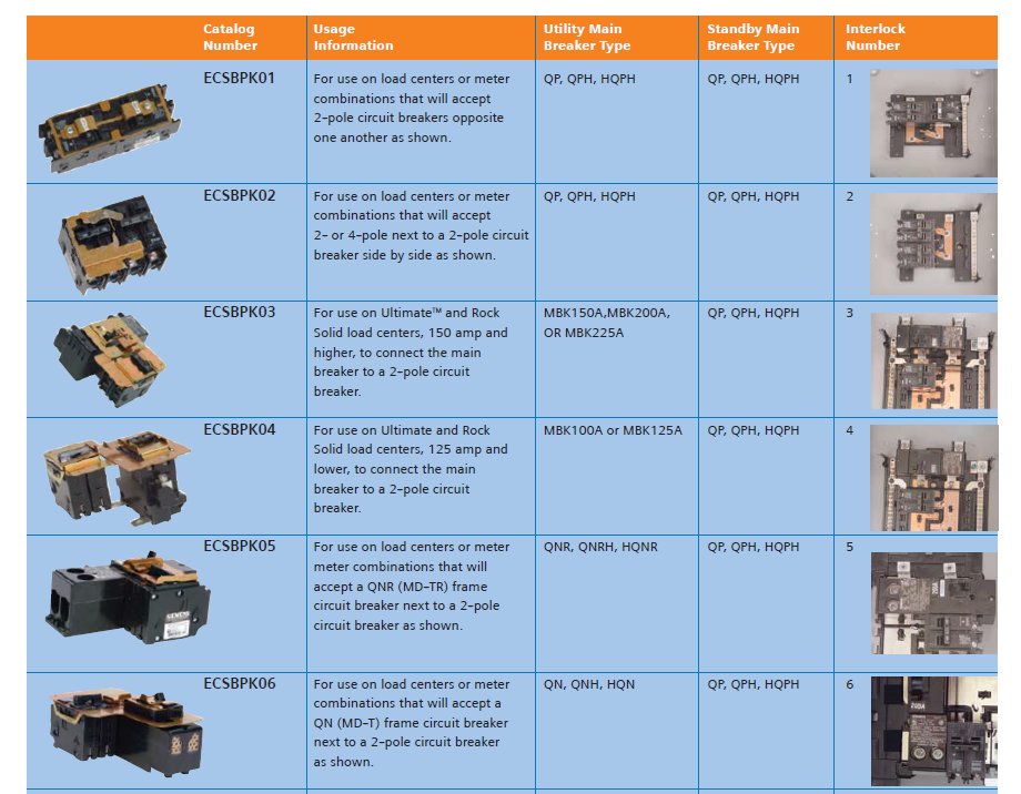

    Depending on the breaker panels, some can be LEGALLY (UL rated) retrofitted directly with a manual generator interlock kit for pretty cheap. I have one inlet on the meter can, and a second on house panel.
    I am using Siemens for the house panel, so that is what I am used to:
    https://pimmedia.winsupplyinc.com/pim/CUT/082019/_ECSBPK02_78364354002_CUT.pdf
