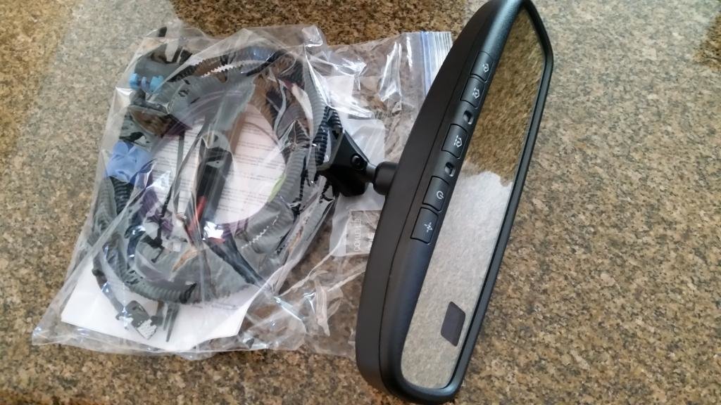

    I got the mirror from Bob!
    Great shipping, excellent price (better than Amazon or Autoanything), brand new product, has everything I need to install.
    I'll be installing it in the next day or so. Thanks Bob!
    Update: I couldn't wait so I installed the mirror right now. It looks/works great! :)

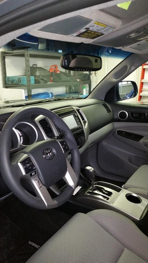

    Posting this since it may help some other dummy. I first thought I had received an incorrect harness, since it did not mate up with the one in the headliner of my 2014 Prerunner.
    Big thanks to Bob for setting me straight. For some reason, Toyota totally wastes a mating plug, using it as a dummy on the end of the factory harness. Once I pulled the "dummy" off, everything was good.
    It's not really a dummy....it is the mating connector with no pins in it. Go figure...
