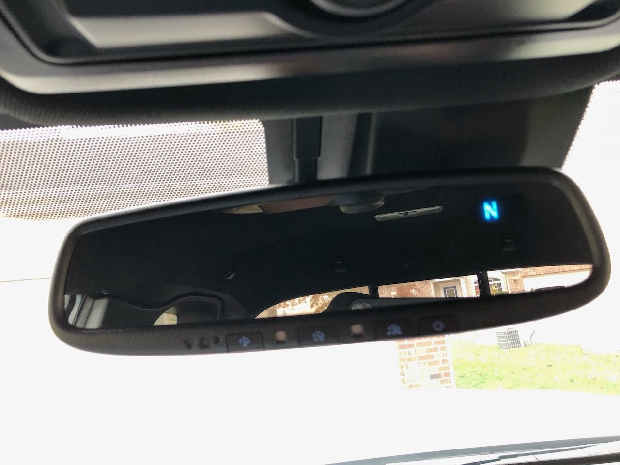

  5. Jun 8, 2020 at 7:08 AM
    #65
    SticksMcKinley
    SticksMcKinley New Member
    May 25, 2020
    #329301
    2020 Tacoma SR5 4x4
    Thanks to Bob for his help with my Homelink mirror replacement! He could not have been more helpful and with the information he provided, made the replacement a breeze. I'm very happy to have integrated garage door openers once again. Thanks very much, Bob!

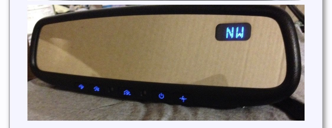

    Quick question. I have a 2018 off-road and the back of my mirror has a 12 pin connection. I have been looking at adding a dash cam that will use that 12 pin connection for power. Do the mirrors you sell have the 12 pin connection on the back too? Thanks.

    According to the first post, it does:
    And here's a nice adapter if you plan to use USB for power:

    Correct...the Homelink V4 and V5 mirrors with blue compass & blue backlit buttons we have available have the 12 pin connector on the back. Now with that said, some of the other mirror options we also have available do not, but for the mirrors that do not have the 12 pin connector on the back, an adapter harness is included that has the appropriate mirror connector on one end, and the male 12 pin connector on the other end, so even in these situations, the USB power adapter will still work, as you would simply plug it into the 12 pin connector on the end of the adapter harness.

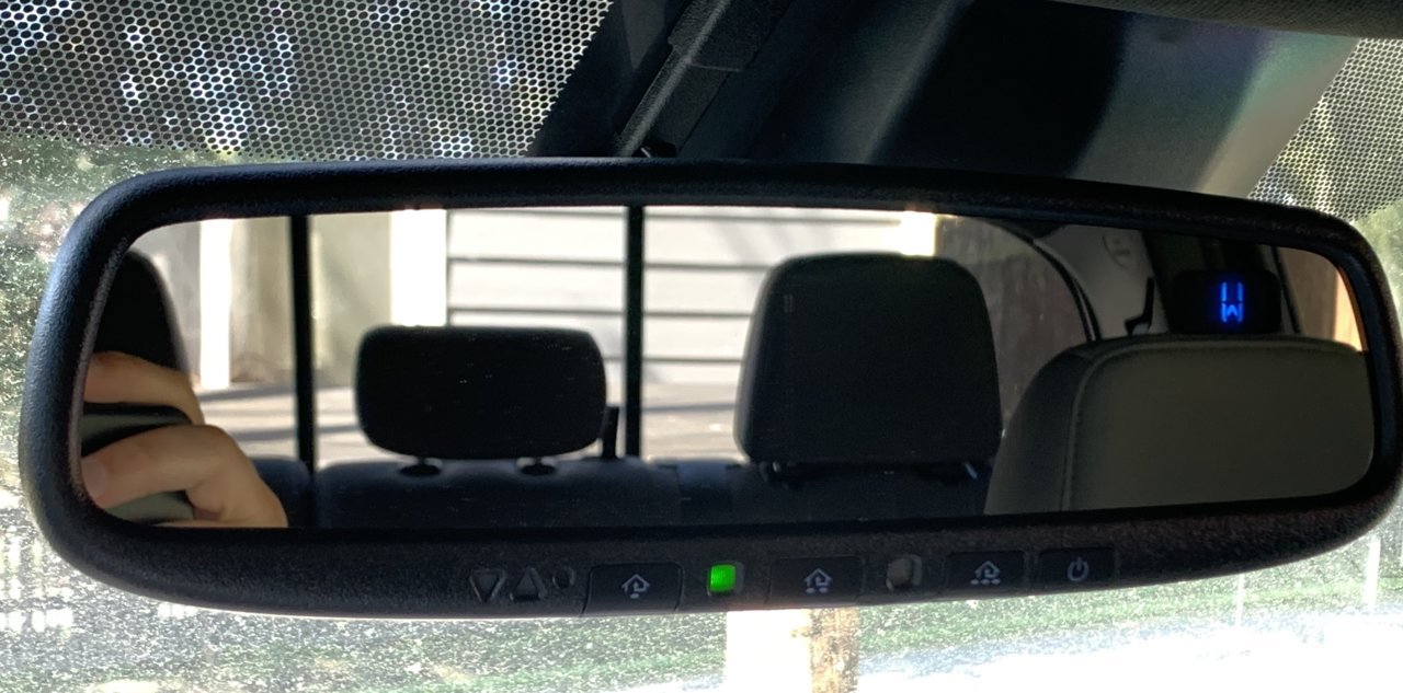

    I need some HELP and perhaps some of you can assist.
    I have a gentex homelink purchased 2 years ago for my 2018 Tacoma Trd Sport. I ended up selling the truck 3 weeks ago to purchase a 2020 Tacoma Sport. I removed the mirror to reinstall it to my new truck. The compass and dimming is working fine but the homelink to open/close the garage is not working. The green light is always on and does not turn red even if I press down the outer buttons to reset the mirror for 20sec. I tried to browse as much as possible but can’t find a suitable solution. Any help I can get from someone would be appreciated.
    I did email and text Bob but no response as of yet. Below is the exact mirror I have.

    I’m out of town til Tuesday...in the meantime, read my original thread, the notice in red explains the issue with 2020 trucks. You’ll need that adapter harness. I’ll get back in touch with you once I return.

    Thanks Bob, I really appreciate your help and looking forward hearing from you back!!... this thing is driving me crazy, lol.

    A huge shout-out to Bob @RJP869 I received my plug and play harness yesterday for my gentex mirror and now im able to use my garage opener again on my new Tacoma 2020!!!:bananadance:
    To anyone who wants a gentex mirror homelink this is the way to go!!!!:thumbsup:
