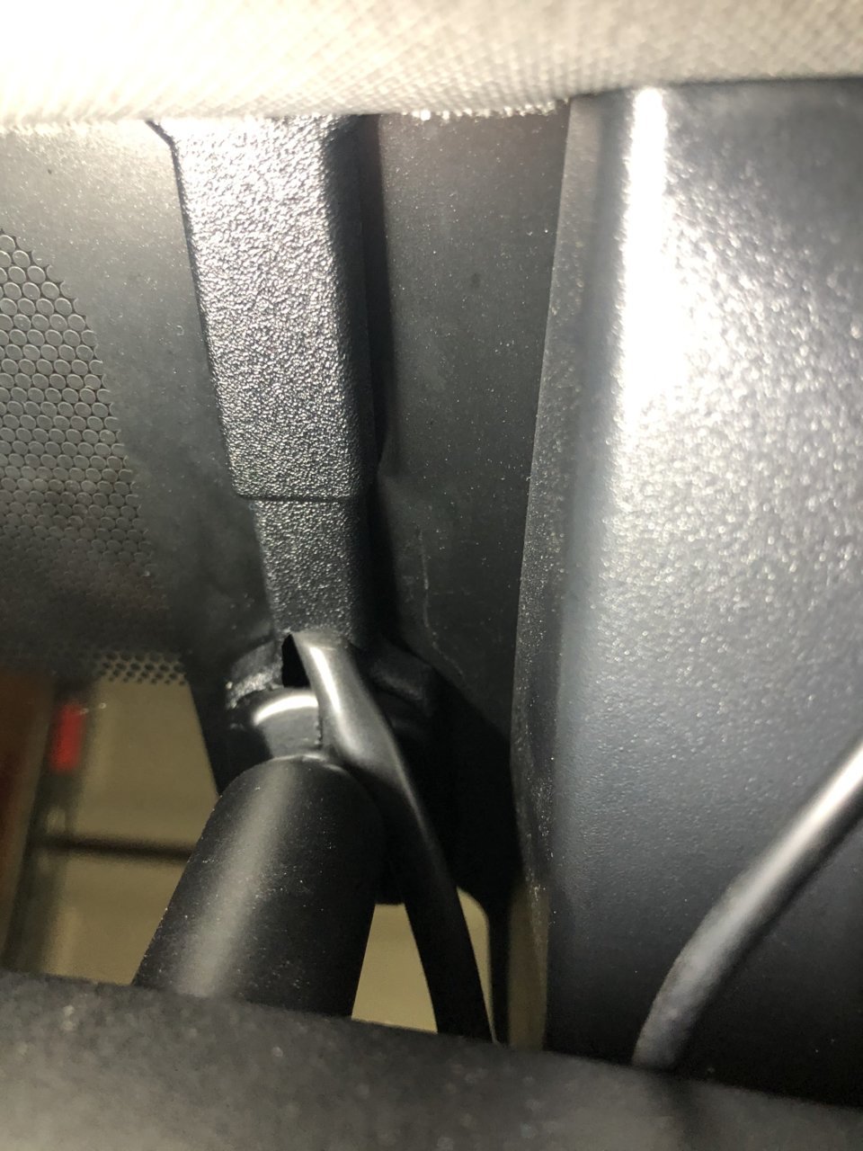

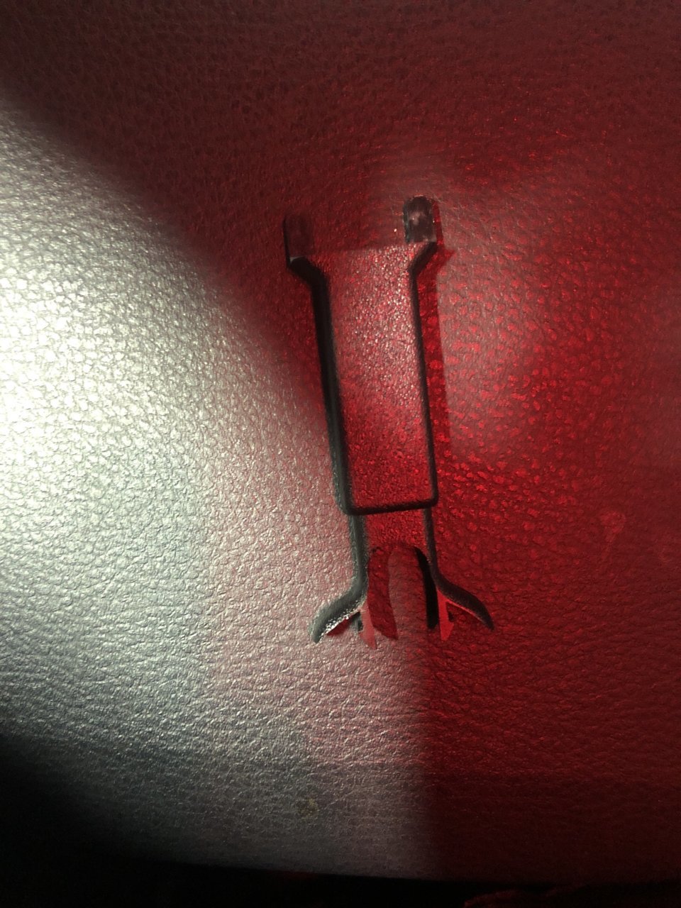

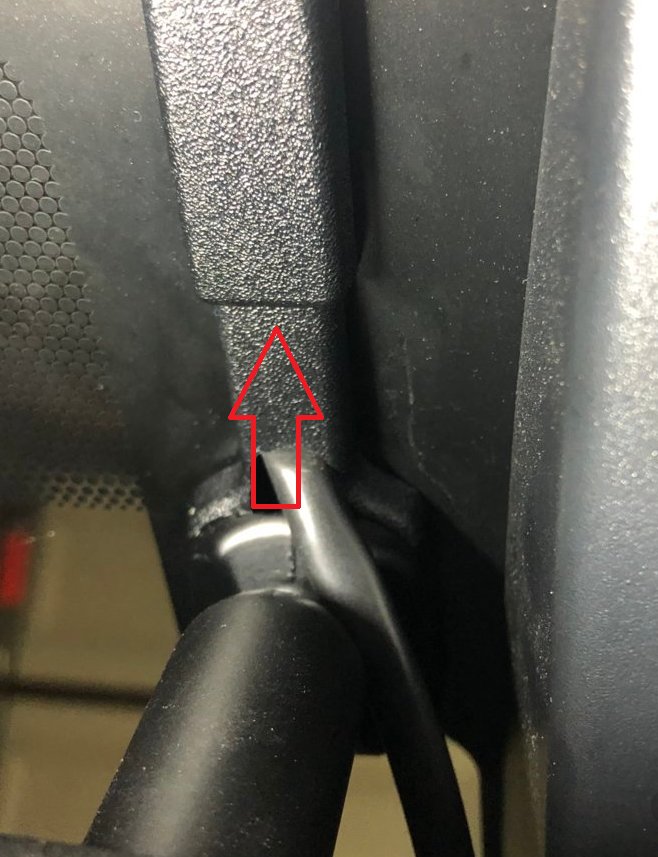

    Center console organizer.
    Push that smaller part up and it'll come right out.

    Got it! Thank you!
    You're da'MAN!!! The rest should be easy going, but if you have anymore issues... come back and let us know!

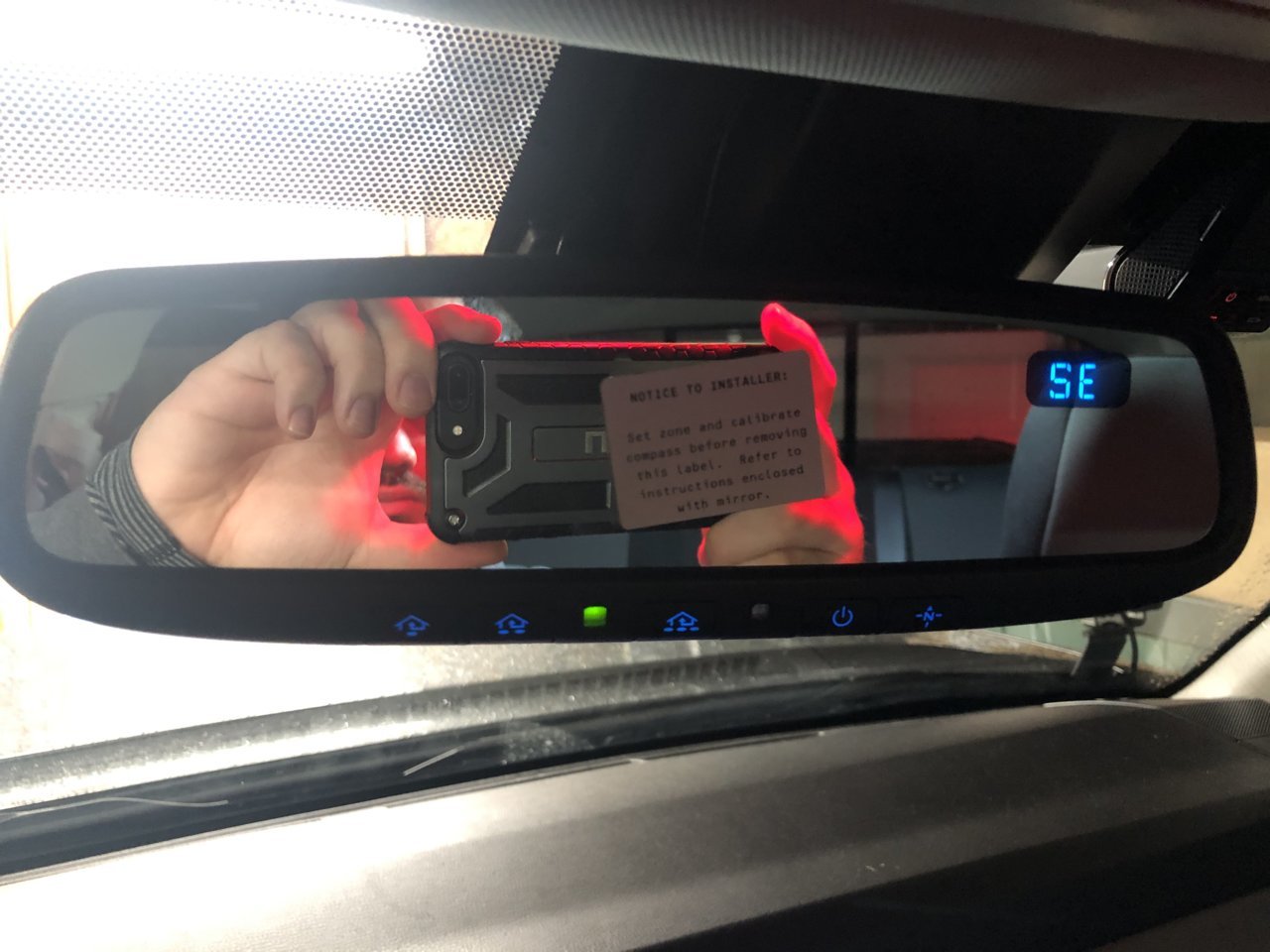

    That’s a fine looking mirror, got everything working. Thank you for your help!

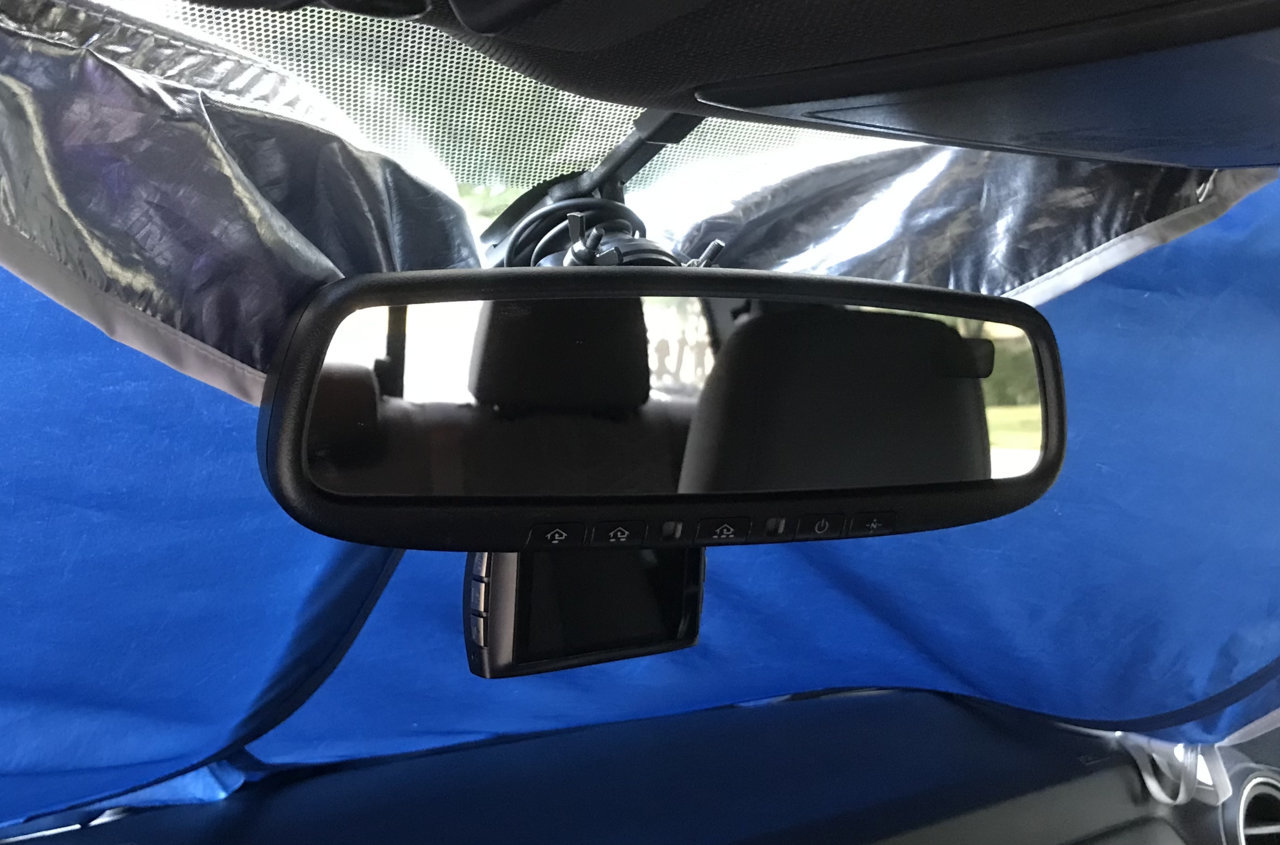

    Just got mine and it installed easily. Took me longer to reattach the dash cam mount than to install, calibrate, and program the Homelink.
    Thanks Bob!
