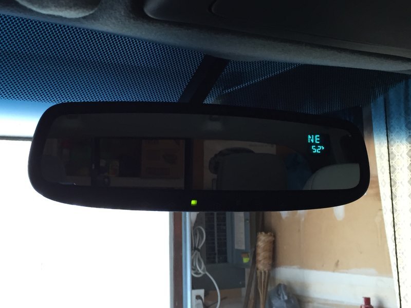

    I received mine from Bob on Tuesday and just installed it today. Took about an hour or so to install. Hardest part was getting the wires through the firewall! I used a hard plastic straw then ran the wires through the straw. Works great and the home link was easy to set up.

    just where the instructions showed. in front of the radiator and underneath the factory temp sensor. the compass i think needed to calibrate itself, which it did from driving around the block a few times. now its exactly what the gps compass is.

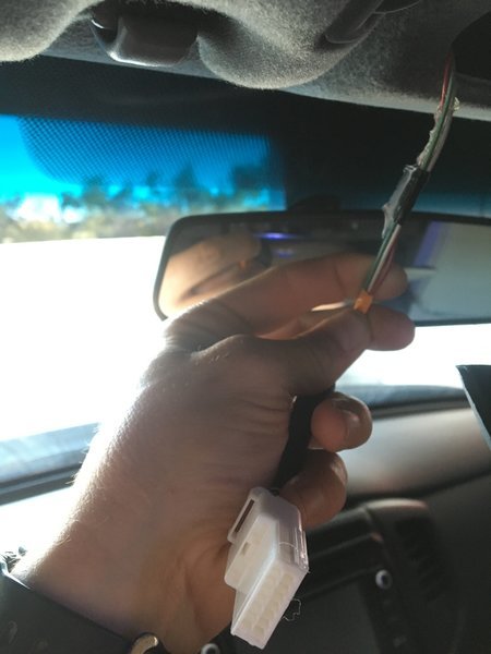

    This is the most useful mod I've done to date. I use the temp feature every time I'm in the truck. Not sure how I lived without autodim before this and Homelink's a definite bonus.
    I like this mirror so much that, when my first 2015 was totaled by a red light runner, it was one of the accessories I made sure I pulled from it. A new wiring kit from Bob, and voila, mirror installed on the new 2015.

    This is what's in the headliner for those with a 2015 Double Cab SB TRD Off Road
