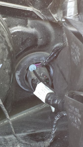

    Was a bit bored on my lunch break, since I bring lunch and eat at work, so decided to go out to the truck and do a bit of prep work for the mirror install tomorrow.
    Popped up the overhead console and removed the visor as well. Found the plug "hiding" up there but mine didn't have a cover on it. All good.

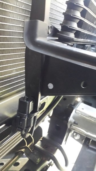

    Installed my mirror today! Question about it all. Does the temp and/or compass need to be calibrated somehow or does it do it by itself? And how do you program the Homelink? Can it be done if your garage door motor doesn't have a "program" button? Yeah, old house with old technology problems.
    Here are some pics. Hardest part was removing the trim pcs and then running the wires through the grommet. Even taking the grill off to make the installation of the sensor was easy.
    I put the sensor maybe a bit lower than what the instructions said. Hopefully that doesn't make a difference. Also ran the wire a bit differently but don't have pics of that, sorry. Was too into it and forgot to take more pics.

    Out of curiosity, where did you mount your temp sensor? Did you mount it at about the placement the instructions had, higher, or lower?
  13. Apr 19, 2016 at 3:29 PM
    #113
    big_jarv
    big_jarv Well-Known Member
    Sep 21, 2015
    #164805
    2,103
    2020 TRD Pro
    I put mine where the instructions suggested.
    I think you should be fine with the placement of yours as it's still in the same general area.
    Any reason you put yours in a different location?
    Also how did you run the wire differently?

    No reason really for the different spot. Well, sort of. Felt like it would be better a bit lower because of the other temp sensor that was already in the area for something else from the factory. The wire I ran a bit differently. I didn't run it along the hood release cable. I ran and tucked it around some other wires and areas. A bit hard to explain but I can try and snap pics tomorrow in the daylight.
