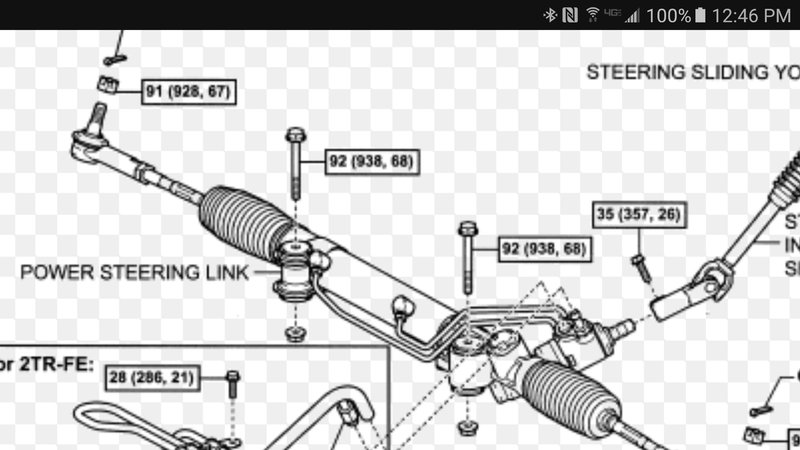

    Sorry I just got this message. So we did fix the pop he had in the front end today. It was indeed the steering rack. I did not take any pictures... sorry about that. There are 2 bolts that run through the steering rack they are toward the front of the truck behind the bolts that hold the diff in place. Our solution to his problem was tighten the piss out of them. That seems to have worked. I'll let you know of it comes back in the next few days.
    So when looking at what caused the problem... we believe the rubber bushing that is in the rack that the bolts run through... well that had a metal sleeve inside of it and I believe that is slightly over sized. So it was causing a bind when he turned. Then at certain points when he was backing up would cause the pop knocking he alignment slightly off (and back in place on occasion).

    Is there any way someone could upload a picture of these 2 bolts that need tightening?

    This is the best I can do from work atm
    It is the 2 bolts centered in the picture labeled 92(938,68)

    Perfect, thanks. I just got back from going under my truck real quick and thought those were the ones. They didn't look loose, but Saturday I will be checking everything at my buddy's shop up on the lift.

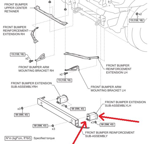

    turned out to be the bumper reinforcement bar creaking against the metal brackets. Im gonna put rubber washers in there behind the cross bar and behind the brackets where they attach also.
    I have regular washers in there now behind the bar and the noise is gone. The frame flexing was creating the noise in the brackets or the cross bar. The noise was traveling through the frame and couldnt be traced until we actually started to pull out all the bolts up front...

    Yep crazy... Still makes the clicking with the metal washers in there, but it's alot quieter. We'll see what happens after i put the rubber washers in there or put some type rubber padding with cutouts for the bolts.

    I'm having this same problem. I just tightened my LCA bolts, and it still does it. I'll have to try this. I did install a bullbar recently. I'm gonna try this and see what happens.

    I took the whole thing apart and put in pliable rubber washers in front and back of the piece that is vertical across the truck and the 2 mounting points behind that piece also. I also used 12 nylon lock nuts instead of the oem nuts so i didn't have to torque them down all the way so it would leave some wiggle room and allow the pieces to move around instead of rubbing against each other and make the noise. Now all is well.
