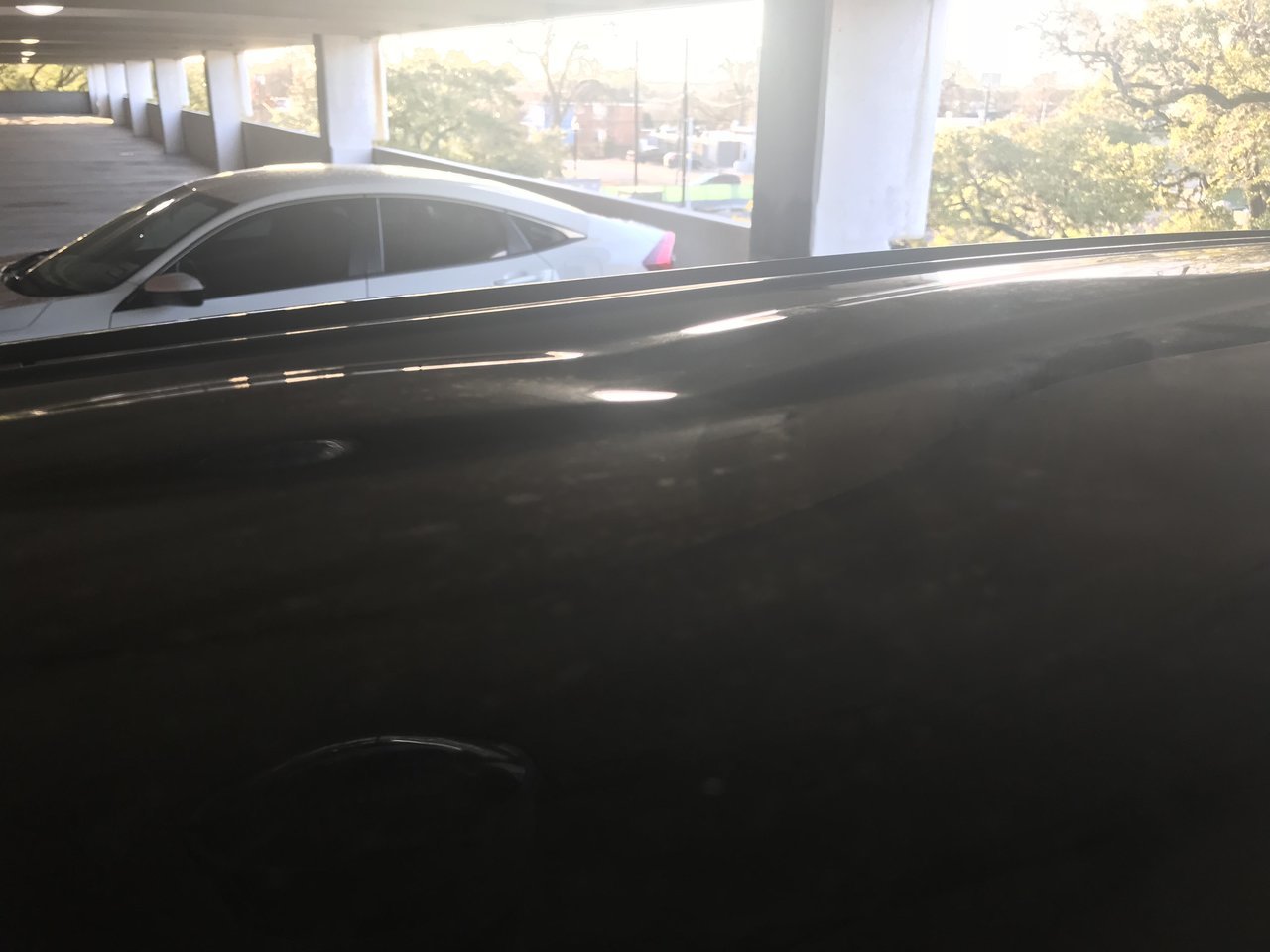

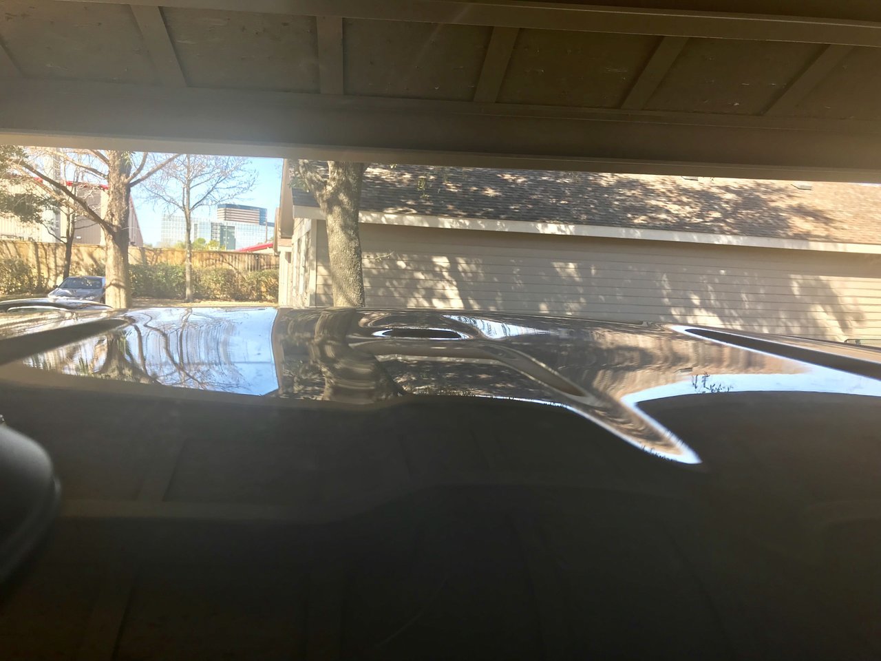

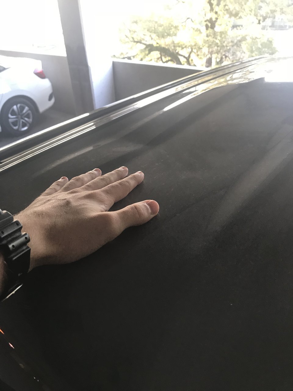

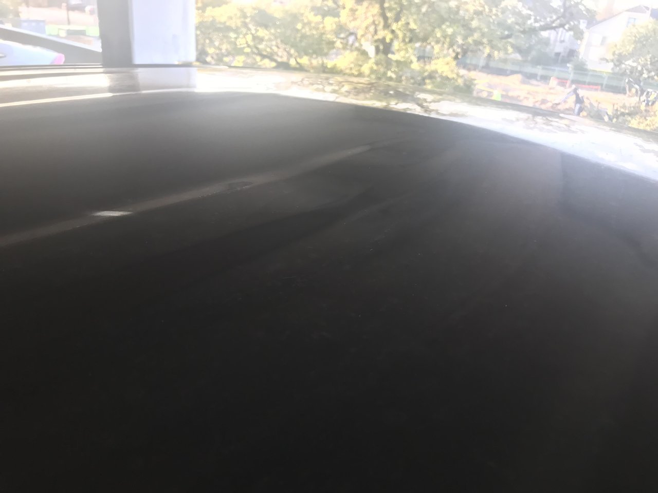

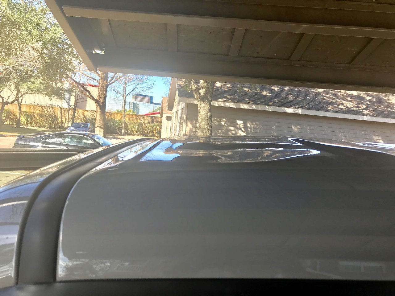

    Hey guys/gals. Came out to my truck from work last night and found these massive dents in the roof. I go so far out of my way to keep Bender safe from DBags around him but how in the hell to I protect from assholes ON him?? Anyways, I don't think it could have happened at work, being as it's in a low hanging garage, but how did I miss these?
    FB110EDF-3F3A-4AD7-AC3A-E3CED5636EA9.jpg A01B45F6-DFB4-4D64-9C5F-5D8EFFBBF9F8.jpg D5F2DE85-1A4B-4CD4-AF26-0128C1D39CF4.jpg CF3004C4-B085-4AA4-842C-59C2A385EEC7.jpg 6137FE34-BA58-4D8F-986D-1429AA0451FE.jpg C6E90A6B-9EF6-4203-8111-275B30EA2250.jpg How do I fix these and do I need to do it professionally?

    Holy crap! what kind of area do you live in that people run over the top of your truck. You can try to pop them out slowly with a no drill puller. Amazon has them pretty cheap, you use a hot glue gun and sucky thing to slowly pull them out. As long as there are no cresses.

    Looks like it can be pushed out from the inside. Taking the headliner down isn't fun but not too hard.

    remove headliner and tap with a rubber mallet from the inside of your cab to push it back out
    Also, since it seems to mostly be flat surface (unless I am wrong?), pour boiling water on your roof and pull it with a toilet plunger (did some friends doors like that. Should work for a roof too)

    Don't strike the dents to hard with the rubber mallet. You may just place one hand of yours over the other at the dent and push easy will pop up, but if any of the dents on a body crease it will still show. Be careful
