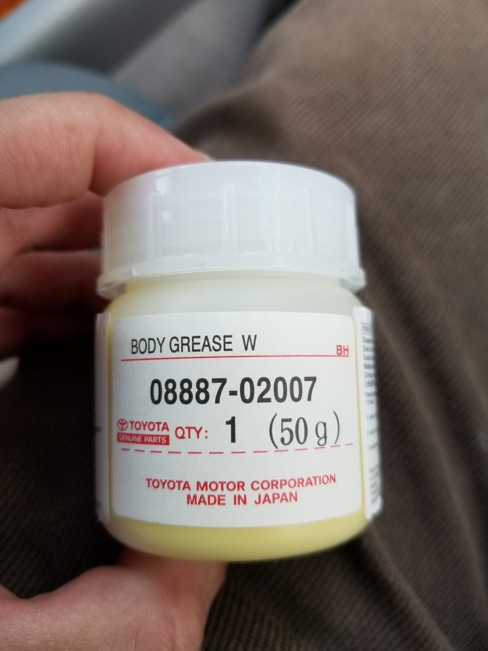

    If anything you also maybe dodged a bullet.
    I went in for the same exact issues as you and thought I was coming out ahead getting the clutch squeak tsb done. I ended up with a screwed up clutch assembly and broken tabs on panels they removed. This is highly dependent on your dealer, but its a very awkward position to work in and im sure the techs would start getting a hissy fit after little time.
    The biggest contributor to the temporary squeaky clutch fix is cleaning and re lubing the clevis on the junk pedal assembly. I highly doubt the master cylinder is to blame here. If you want you can order the oh so special toyota body grease W from your dealer and slather as much as you can on the problem area. I ended up removing the whole pedal and relubing everything. Super quiet and most importantly, assembled CORRECTLY.
    You can check my thread about my botched squeak TSB.
    Picture of mythical grease:20181030_161435.jpg

    Body Grease, huh? Hmmmm, where to apply it? :rofl::rofl:

    I mean the name can't be any more clearer ;)
    It is rebottled Dow corning molykote YM-102. For plastic to metal sliding surfaces. Its 40 bucks for 50 grams. You can probabaly do 100 clutches packing it in liberally or display it on your dashboard to show how much of an OEM badass you are.

    Sheesh though. Honda Assembly Lube is about that size, mostly Moly, and why less $$:
    https://www.amazon.com/Honda-HN-08798-9010-MOLY-PASTE/dp/B0083BWUYW
    It isn't fun to work with though. Definitely paste and hard to get out.
    I'd go disk brake grease if I get the squeak.
