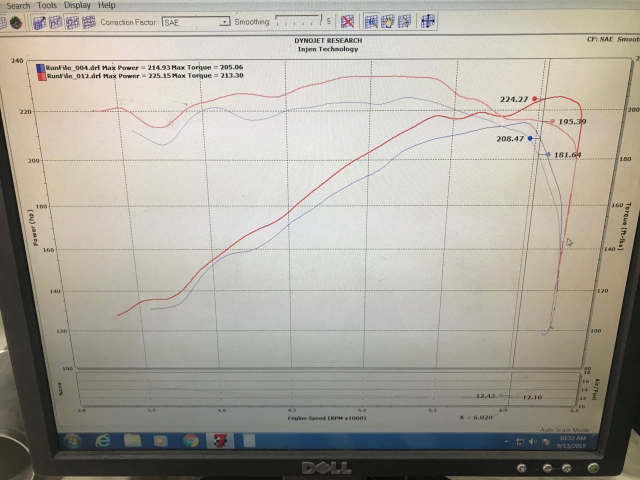

    Everyone needs to look at the dyno a bit closer. Look where that 16 hp difference is. It is at 6,000 rpm, where the red curve keeps going up and blue (stock curve) has started to go down. Not sure how the red curve keeps going up past 6,000 rpm because my truck shows the redline at 6,000.
    Take a look at the difference in power elsewhere in the rev band. It is about 5-8 hp or so. So that's just about what you expect one of these systems to give you. You won't notice this power increase anywhere but at the very to of the rev range.

    Yep... he’s correct. And that 5-8hp is what you actually feel driving normally as you do

    Where is the dyno chart?? Would like to see the 15 hp claimed on paper.

    To be honest, 5-8 horsepower for $400 is not that bad for just a CARB legal intake. I'm just skeptical it'll even give me that much power.

    Any gains would be minimal at best, the one guy on here that put a 3rd Gen on the Dyno made Zero extra power with the filter removed so a high flow filter is basically worthless.
