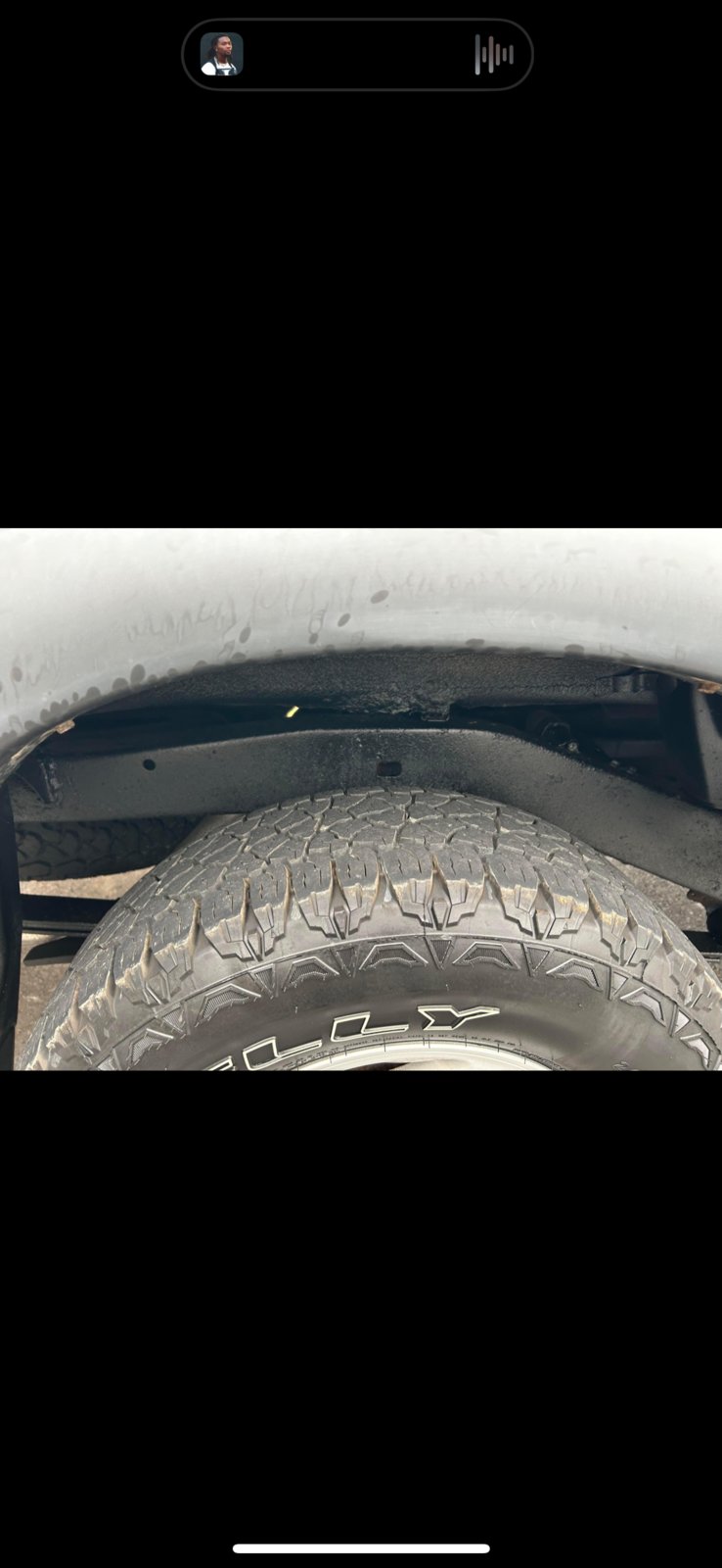

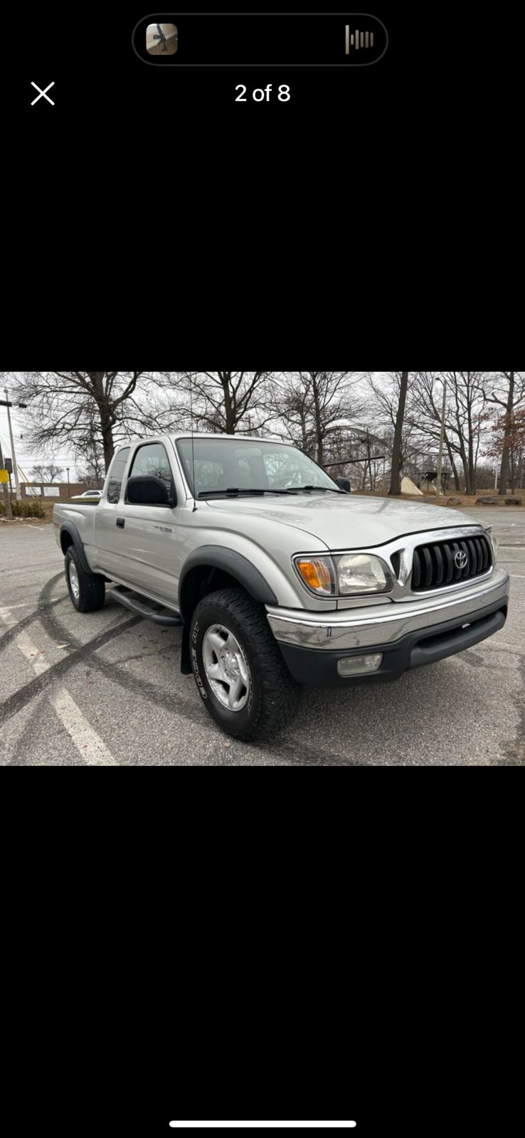

    Hey everyone. I’ve found a 2002 Tacoma for sale near me. I’ve attached some some pictures and a video. We are in the northeast so it could be subject to some rust. Just looking for some advice before I go check it out. She has a new bumper she hasn’t put on yet.
    225k miles
    Asking 7k obo

    The exterior looks excellent and the interior is fair. The bumper rust spot in the third pic (along with the northeast location) makes me wary, but just bring a flash light, lay down, and take a look at that frame.
    It'd also be worth checking if 4wd still works, it doesn't look like the owner uses it much with that phone mount :thumbsup:.

    The bumper is very likely the least of the rust concerns on that truck.

    Excellent? You and I have a very different view and definition of excellent.
    Peeling clear coat on the cab is not excellent. Typically, the clear coat peeling also apply to the hood which leads me to believe the hood been respray because the grille is also painted. A giant softball size rot on driver side fender also. I can only imagine how bad the frame will look since there's no picture.

    The hood has a vinyl wrap on it, looks carbon fiber-ish. Clear coat is probably trash on the hood like on the part of the roof you can see. Rust hole all the way through the front bumper you could stick your fist into, doesn’t bode well for frame, control arms, leaf springs, and every nut and bolt under that truck.
    That’s a $3k truck tops.

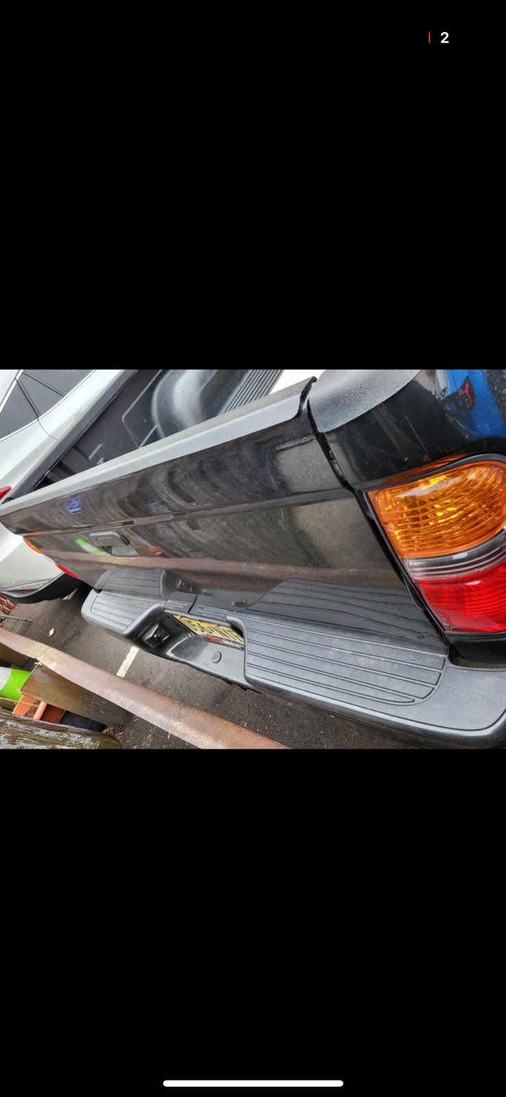

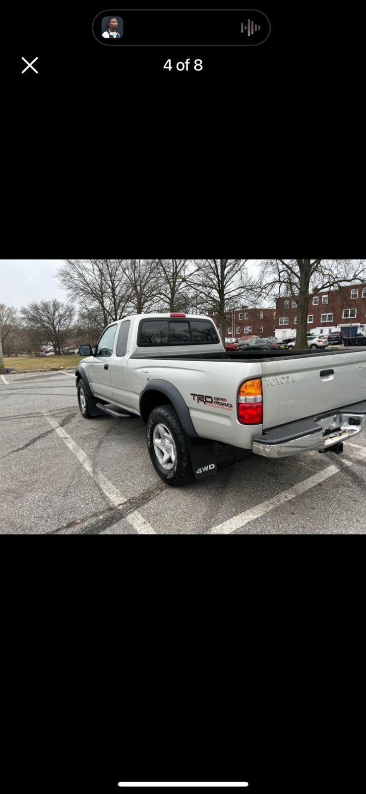

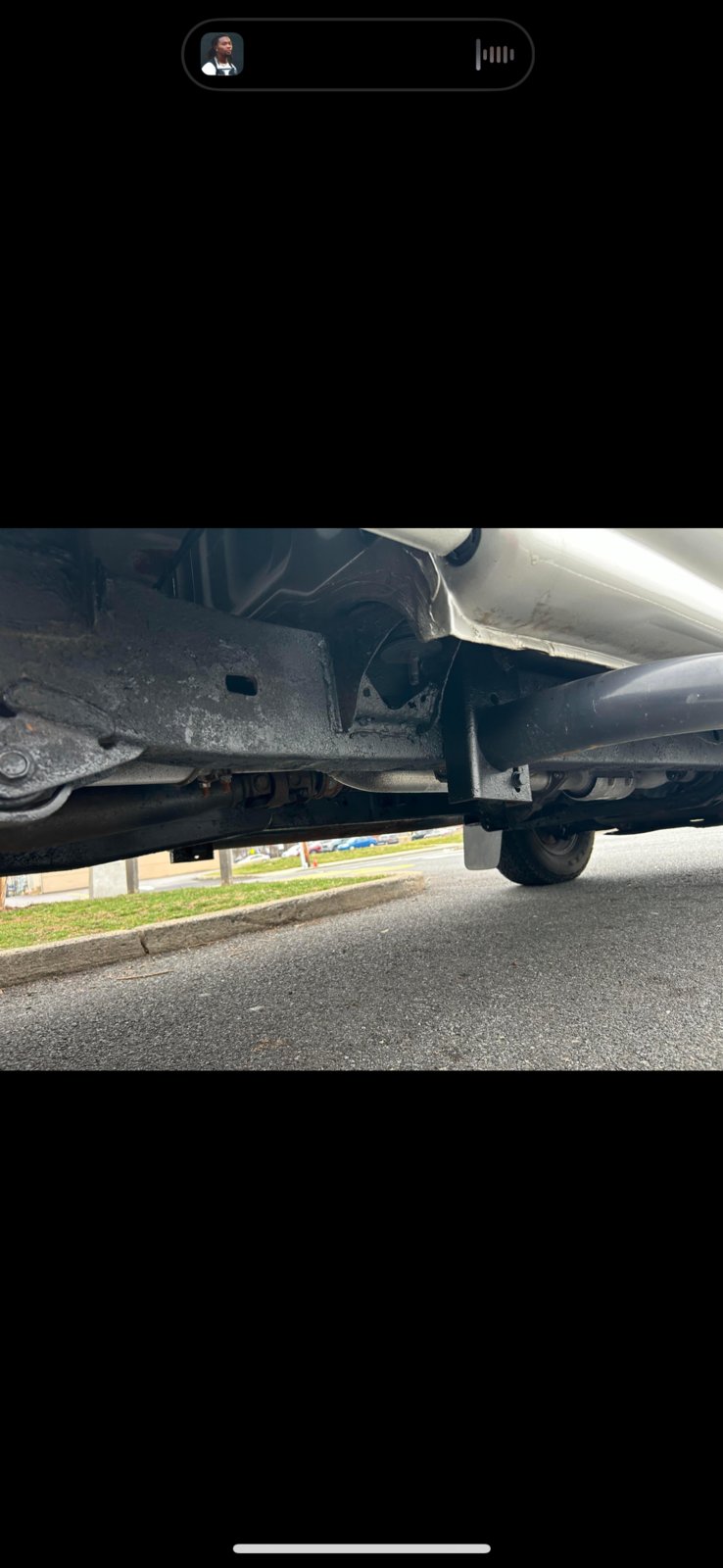

    Ok I went to check that one out and it wasn’t that great. I was able to get her down to 5k but I wasn’t really feeling it. I did happen to find another one, and it looks a little better for the same price. It’s about 2 hrs away from me and he says he painted the chassis. Is this something to look out for? Rust on back bumper. I have attached more pictures.
    2003 TRD OR 154k Miles

    Paint hide rust, that's it. I would pay close attention to the frame, especially by the spare tire carrier, fuel tank, and leaf spring mount area.

    tons of rust scaling under that paint (on the frame)
    stay away
