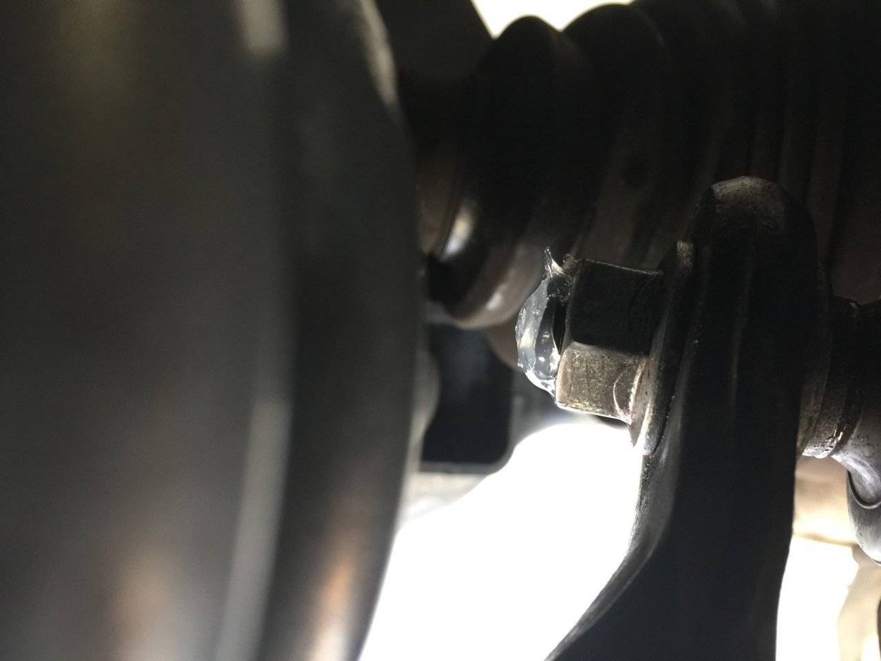

    Could you cut the bolt shorter?

    I get why you did that but how about cutting off some of the exposed threads instead?

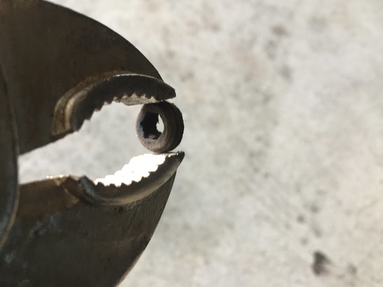

    Makes sense. Without the hex hole you'd have to hold that joint with vice grips if it started twisting on you while taking that nut off. That usually destroys the joint or at least the rubber. I vote for the relocate kit.

    Well after seeing how bad it made the joints and the boots all tweaked I did actually cut it off. Just a small piece and then added some rubber silicone to the end of the bolt in case it does make contact (doubtful). I think it will work out great. I would just get a whole new rod when this one dies. :thumbsup:

    Are both sides like this? Could the sway bar not be centered in the mounts to the frame?

    I checked everything, it was literally 1/8" of bolt touching at articulation on both sides, so I just trimmed the bolt. Problem solved

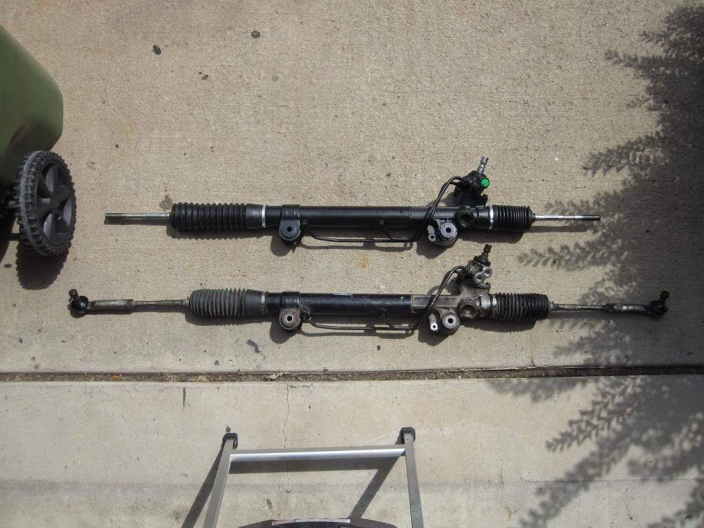

    I've had all the same symptoms - checked all the things listed here (i dont run a sway) - except for the steering rack... how do i tighten it?

    Ok bear with me here. And I hope I don’t sound like a dick. Do you know what your steering rack is and where to find it?

    Those two round things are where the rack bolts to the frame. If you look at your rack you can see them and check the tightness.

    If you pop off your front skid it’ll be very visible where they are. Good luck!
