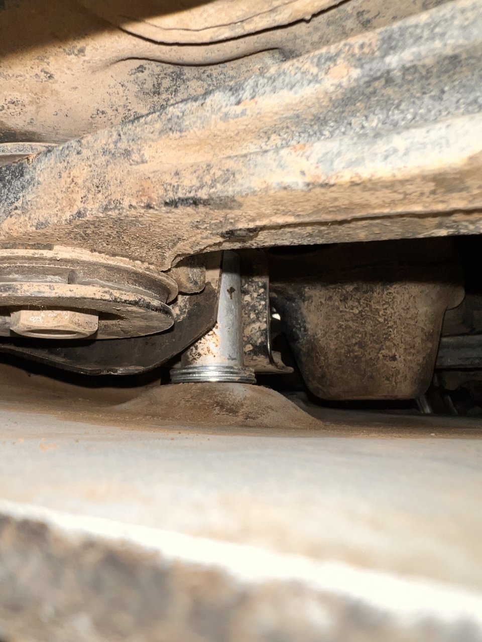

    Can someone share a picture of where the RCI skid is rubbing and needs a washer? I got the clunky sounds and have RCI skids too. Thank you in advance

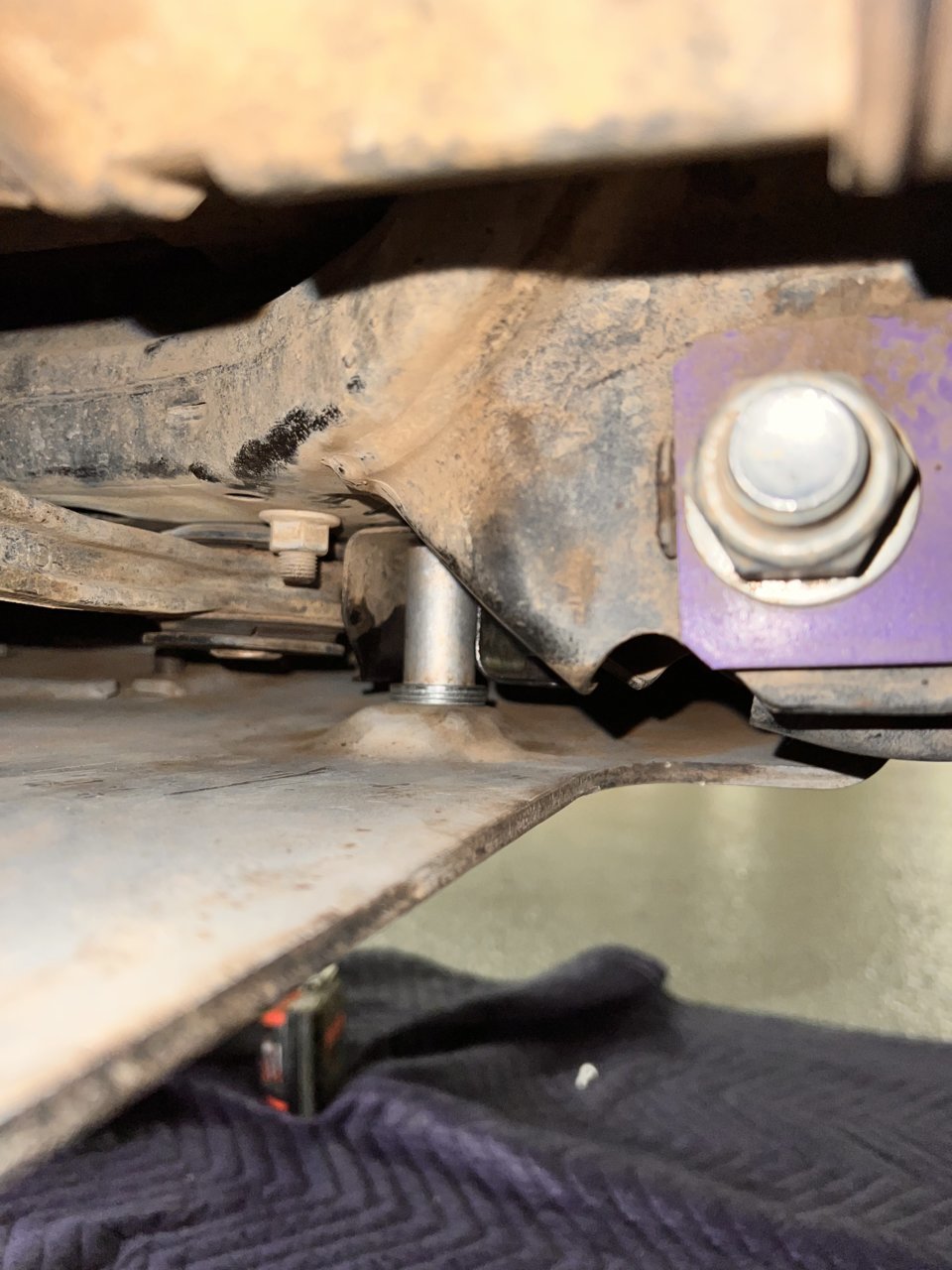

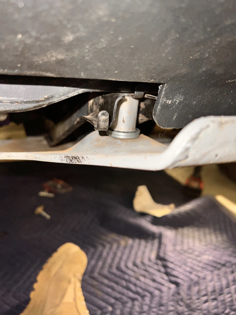

    So I was having the same issue I was pretty sure it was my steering rack, but ended up being the skid plate binding with some frame and diff mount parts. Mind you this started happening after my TRD Pro skid plate got banged up and became crooked… so here are some pictures for anyone having same issues.
    I basically added three washers on each side where the middle is (closest to the diff mounts)
    And two on each side on the most front ones.
