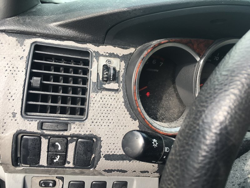

    The truck I bought came with this dumb interior stickers and I'm trying to remove them but the issue is the residue, I've tried good gone, a blow dryer works but takes up a lot of time and a heat gun is too hot and starts to warp the plastic pieces.
    Any other recommendations?

    I'd use goof off, goo b gone or similar stuff designed to dissolve glue residue. Available at most hardware stores

    yeah...you have to let the residue get soaked with the goo gone. I use a paper towel ... get it good and soaked in a spot and just hold it on the gunk for a bit....reapply as needed. It's a pain but it will work

    It's the whole dash that has it

    Man, what the hell did the last owner do to it? That looks nasty.

    Stick on wood grain dash kit. You can see remaining pieces around the silver gauge rings

    Another thing to consider...Goo-Gone, Goof Off, WD40, PB Blaster, whatever, are gonna stink up the interior something fierce, especially if it gets into the pores of the vinyl. You will be smelling it for months afterwards.
    If a hair dryer works, you might be best just taking the time to do it that way.

    They sell a citrus pure fresh orange air freshener thats really good at loosening sticky goo.It really works removing plastidip also.

    Spray,let it sit,sponge soft side,wipe off.

    I would think anything that will remove that residue, will also destroy the finish.
