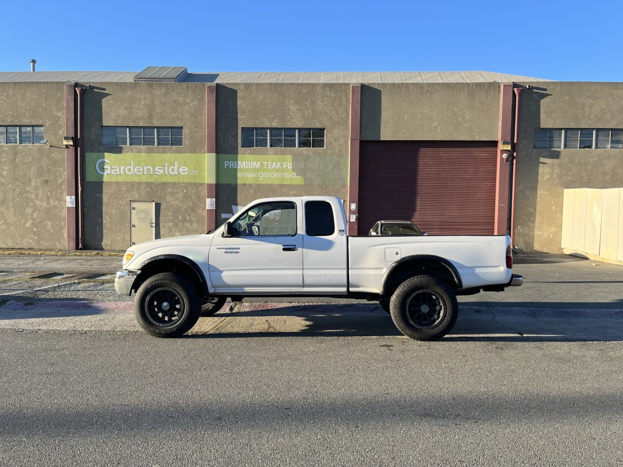

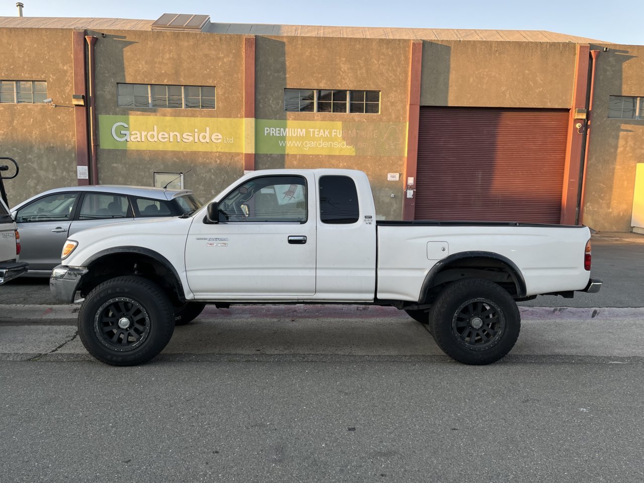

    Quick update for anyone interested:
    Got the front 5100s in at the middle setting.
    leaving the rear alone for now. Thinking I may just replace the shocks with some new bilsteins to fit the 2” blocks (apparently the 5100s are only for 1-1.5” according to bilstein manufacture)
    I was torn between the 0” and the 1.25” setting for the front 5100s. Ended up going for the 1.25 but now wondering if 0” would have been better to get some more rake
    what do you all think of how it now sits / looks?
    will be putting my snug top camper shell back on soon - hoping it will remain raked or at least level.
    Thoughts on the way truck is sitting now compared to before? Noticeable difference?
