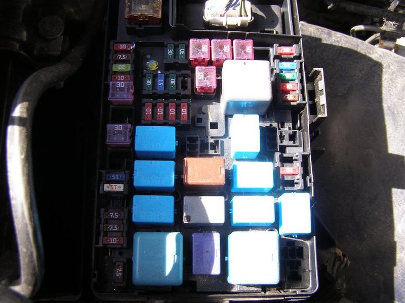

    Thanks, which number is it? 16?

    I moded 1999 Taco so much it had turned to Land Cruiser
    That should be it, it should also say on the relay box cover.. :thumbsup:

    Thanks. I see that, but in the diagram and looking at the actual box contents, I can't seem to determine which one is specifically the one to test. So on the diagram posted, page 24, it's number 16 on the diagram?

    Here is the pic of relay box, its a purple one, in first row from fender (bottom of the picture)

    No, it's not 16. 16 would be the one above the purple one in Bluet's picture.

    Gotcha. Thanks. If it happens again and I have someone with me, I'll give it a try.
