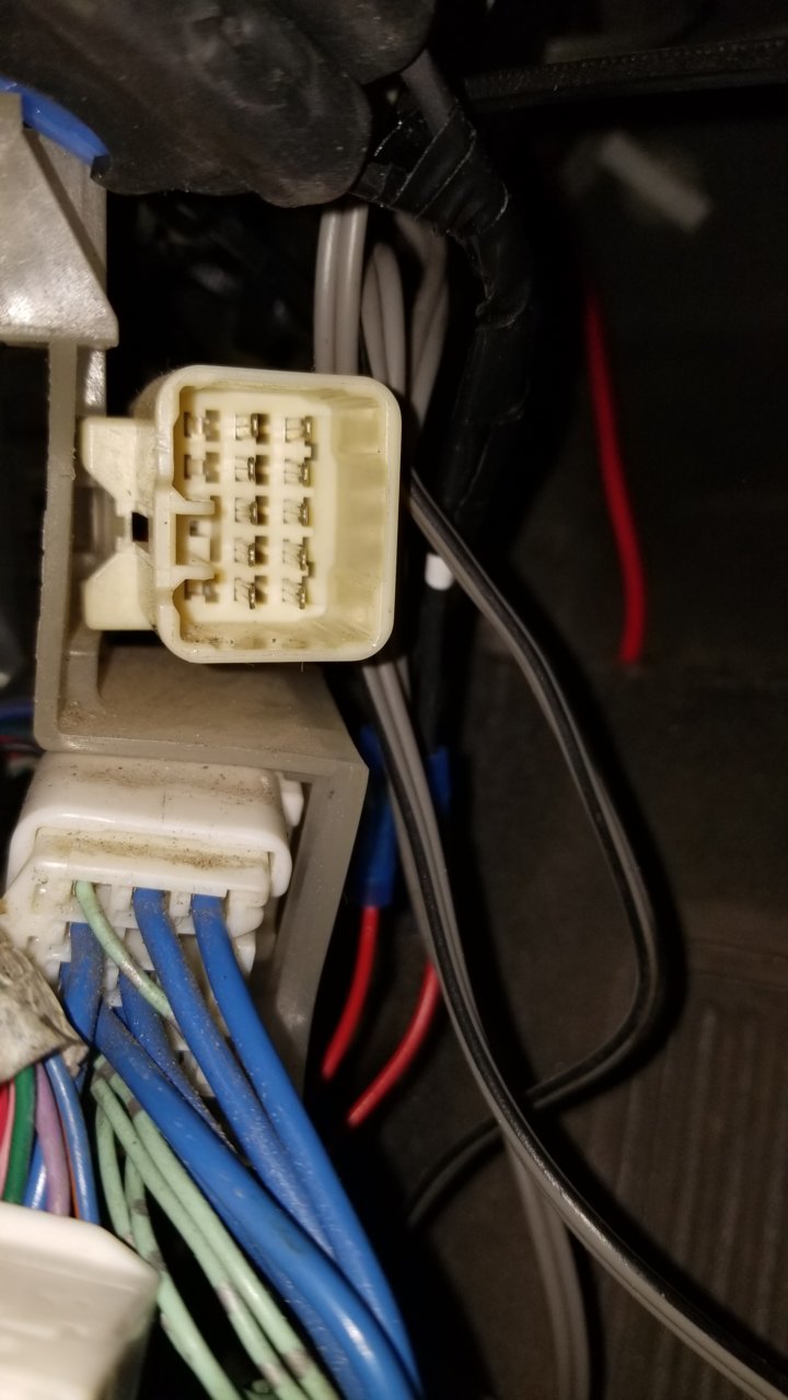

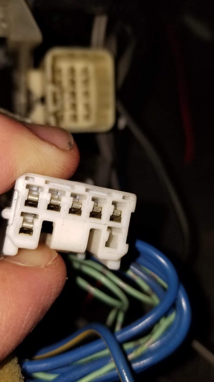

    So I got a 2003 donor door with electric windows. Score, I thought. One of the two plugs from the door are not the same and I dont know why. I spent 10 hours working on fixing the truck and this was the last thing. Am I going to have to swap the WHOLE wiring harness over? 20181209_184946.jpg 20181209_184939.jpg
  11. Dec 9, 2018 at 6:57 PM
    #31
    Shiki Shabazz
    Shiki Shabazz [OP] Well-Known Member
    Jan 29, 2012
    #71694
    369
    Tulsa, OK
    2003 Tacoma Dbl Cab TRD
    There are two rows of connections on my truck and just the single row from the donor door
  12. Dec 9, 2018 at 7:29 PM
    #32
    Spoonman
    Spoonman Granite Guru
    Sep 11, 2011
    #63328
    9,810
    Jamie
    Alberta
    Doeswap the harness from the door. It’s easy
  13. Dec 9, 2018 at 10:19 PM
    #33
    tony2018
    tony2018 Well-Known Member
    Feb 24, 2014
    #123866
    5,285
    swap door harness, not that hard really. no need to stress over something that small.

  14. Dec 10, 2018 at 3:31 AM
    #34
    Shiki Shabazz
    Jan 29, 2012
    #71694
    369
    Tulsa, OK
    Ok, just wish I paid more attention, would have been a LOT easier before I mounted the door. Thanks guys

  16. Dec 10, 2018 at 4:09 AM
    #36
    nzbrock
    nzbrock Well-Known Member
    Jan 6, 2013
    #94572
    3,251
    Noah
    San Marcos, TX
    99 TRD Prerunner 3RZ
    SAW 2.0 Coilovers Wheeler's 5 Leaf + 3 AAL Bilstein 5100s LCE long tube header Flowmaster Delta 50 Muffler FJ Trail Team Wheels 4Runner overhead sunglass console 4Runner leather seats All LED lights Red/Clear Tail Light Tundra Brakes HID Projector Retrofits 4Runner Auto Up/Down Windows Bullet Liner Cargo tie down system E-locker axle swap w/4.56 Gears ARE MX Cap Prinsu Toprac Custom heated turn signal/puddle light mirrors Volant Intake Tube
    You can remove the pins from your new door harness and put them in the old connector. You just need to put them in the correct spots.

  18. Dec 10, 2018 at 7:59 AM
    #38
    Shiki Shabazz
    Jan 29, 2012
    #71694
    369
    Tulsa, OK
    Well, Im just going to have swap the entire harness. The plug on the "new" door doesn't have enough pins. there is an entire additional row of pins on my old door on that clip.
  19. Dec 10, 2018 at 8:57 AM
    #39
    frizzman
    frizzman Well-Known Member
    Sep 25, 2013
    #113212
    5,348
    Pittsburgh, PA
    04 XCab 4x4 TRD/OR
    OME 2.5,Tundra 17s,Falken Wildpeak AT3W hitch w/ 7-pin, ARE cap, JVC HU w/BT, HID/LED lights
    probably due to the "new" door being from a single/ext cab and yours is DC with additional wiring for rear windows
  20. Dec 10, 2018 at 9:56 AM
    #40
    Shiki Shabazz
    Jan 29, 2012
    #71694
    369
    Tulsa, OK
    OHHHH I didn't even think of that. Ok then. Thanks!
