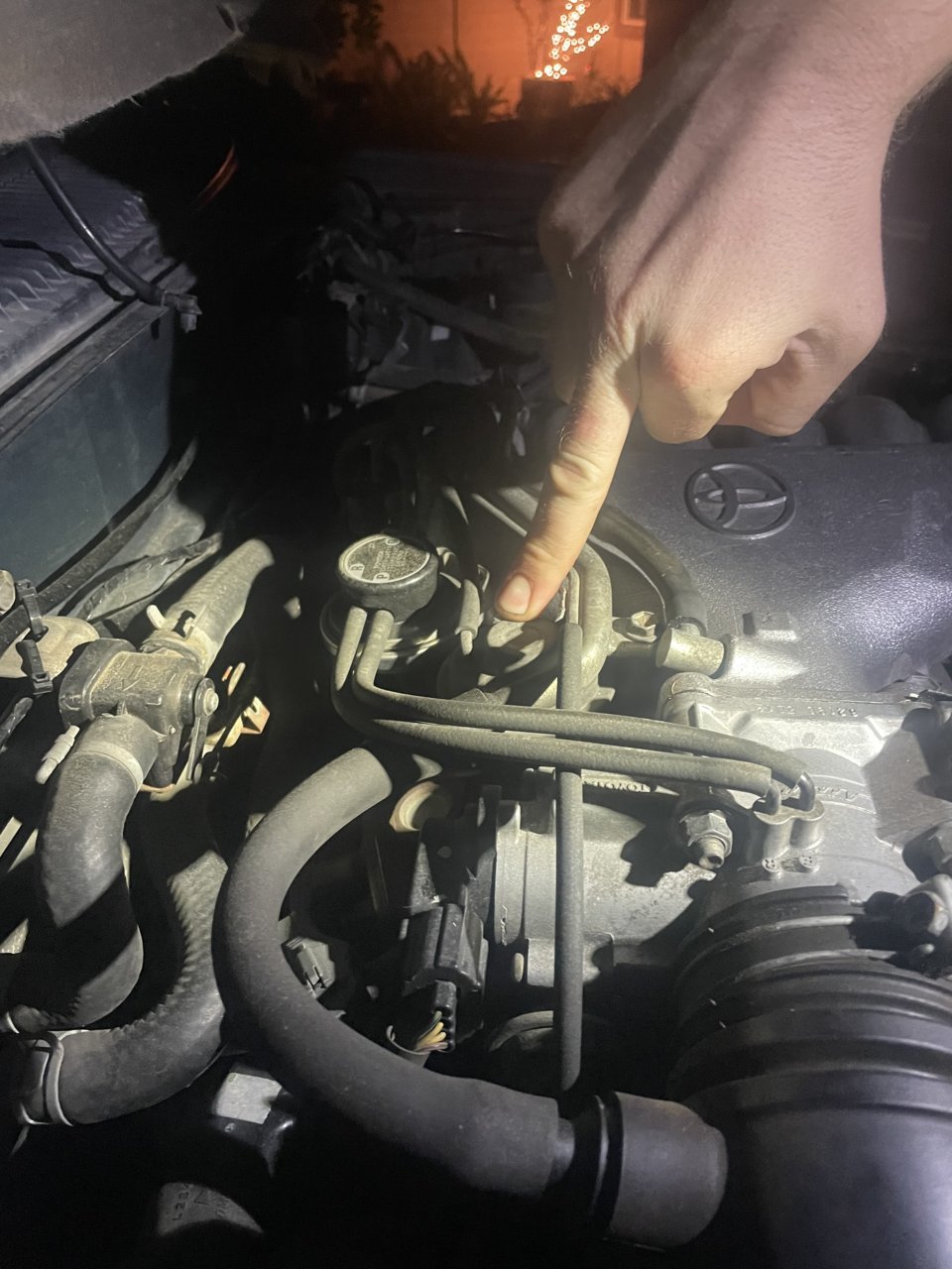

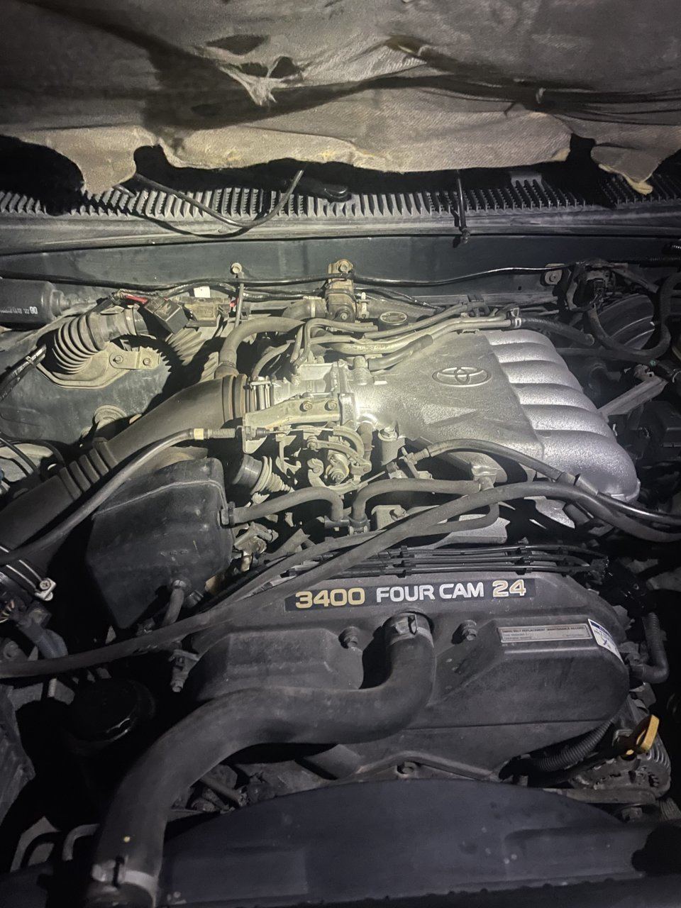

    My sons 1995.5 3.4 absolutely has a EGR valve. It is also OBDII but stupid CA doesnt believe it... The smog guys do, because its right there, but the CA database wont let his be tested as OBDII. Like someone said, you have to dyno anything older than a 2000. His is due soon and we are scared.

    GoodDogRUGER
    I am afraid you are very mistaken and putting out false information. Earlier one had it later ones do not. I know and have experience with both. First hand, hands on. It would be great to not put out ideas, opinions and maybes as fact. Here are pictures taken right now. IMG_3918.jpgIMG_3920.jpgIMG_3919.jpg

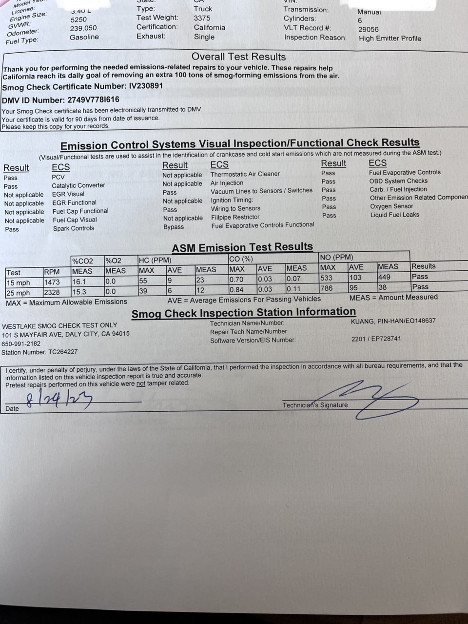

    Posting an update here for anyone else who may encounter this. I passed smog today, my results are posted below.
    To prep for the test:
    New upstream denso o2 sensor
    Ngk double electrode plugs
    Ngk plug wires
    Cleaned MAF
    Replaced PCV, gasket, and hose
    Ran a can of sea foam through a vacuum hose before the plenum
    Ran a can of sea foam through gas tank
    Drove the truck like a teenager for an hour before the test (WOT pulls on the highway)
    Kept it idling and reving it for 30sec increments at 2k rpm while waiting for the test
    Filled my tank with premium
    Oil and filter change
    Aired up rear tires to 43psi
