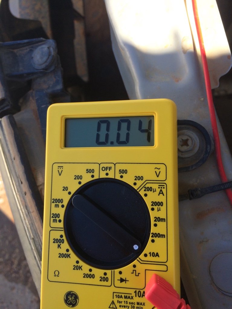

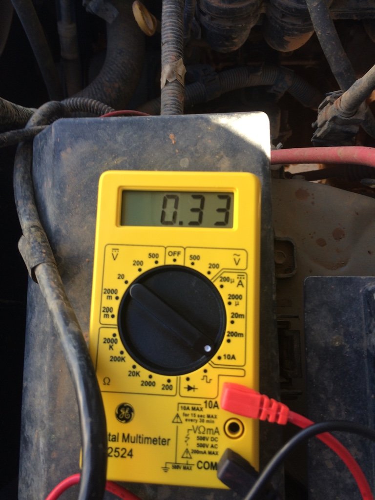

    I think I found the culprit that kills my battery. I will test again later tonight
    Original test after 30 min drive
    Pulled my OBD2 wifi adapter that my phone hooks up too and it dropped way down.

    Access cab with child seat in the back, yellow wire mod, diff breather relocated to tail light, engine block heater, Leer topper with Yakima tracks and rack, Yakima rack on cab, Ride Rite air bags with Daystar cradles, CBI hidden front hitch, wired for winch front and rear Warn quick connect, Warn x8000i on external carrier, sway bar delete, trailer plug relocated to under bumper, Pelfreybilt IFS and Mid skids, BAMF Tcase skid, ECGS front diff bushing, ARB CKMA12 compressor, 255/85/16 Backcountry MT 3 load E tires on stock steel rims, Toyo M55 tires (same size) on another set of stock steelies, Up2NoGood heated mirror kit, Husky X-act Contour front floor liners, Northstar AGM 24F battery under the hood, Northstar 27F in the cab, Redarc 25 amp DC to DC charger, Pelfreybilt bolt on sliders with kickout and top plates, TRD Pro headlights, Depo smoked tail lights, Energy suspension body mount bushing kit, OME Dakar leaf packs with AAL, OME rear shocks, OME 90021 front shocks with 885 coils, SPC LR UCAs, Up2NoGood 2wd low range mod, 4 Wheel Campers Grandby slide in camper, 4xinnovations high clearance rear bumper, Uniclutch 800 lb/ft clutch
    Interesting... I keep my OBDII wifi adapter hooked up all the time, but rarely use it. Now that it's getting cold, I might start paying attention to the battery reading. Which model do you have?

    Check battery voltage now with it plugged in and come back in 2 hours and check it. Or unplug it and see if truck starts in morning, if it does leave it unplugged until you get a CEL. Glad you finally have some answers

    I'm just gonna leave it unplugged and see what happens in the morning.
    Idk exact model but it was only like $15 on Amazon. I opened up the brains part of the adaptor and there was some kind of white powery substance all over the circuits. And it also looked like the wifi antenna was shorting something out

    Truck started up fine this morning. Looks like the wifi adapter was the culprit
