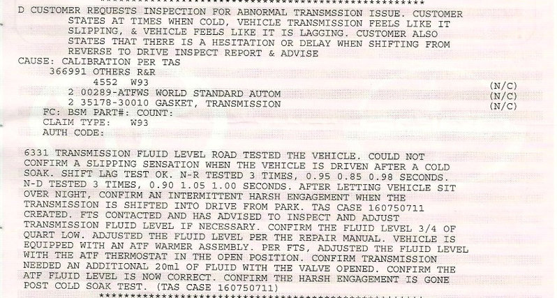

    This.
    My service advisor kept giving me updates about the other issues I brought my truck in for, but not so much with the transmission. When I finally got an update, I was told they couldn't duplicate the issues (no surprise to me) and was told that the servicing checked good through techstream. I told him no, it has to be checked through the overflow plug and that was my main reason I brought it in to them was because it seems nobody wants to check the level properly.
    They finally checked it through the overflow plug and sure enough, was about a quart low.

    Here's a pic of my work order:
    Thirdgentacoman likes this.

    According to my work order, they later replicated one of the issues and they opened up a TAS case. This is the exact reason I wanted to take my truck in rather than checking the fluid level myself. Hopefully there will be more volume of this and a TSB or recall will be put out to have the transmission fluid level checked for all '16's.
    However, there are dealerships out there that will check your transmission fluid level without much question. Another member posted about a dealership near me so I gave them a call and they were going to take my truck in to check the fluid level. They had no issues doing the job and didn't ask how my transmission was operating. After being frustrated with the dealership A that had my truck, I picked it up and setup an appointment with dealership B. Dealership A calls me the next day after I picked up my truck and told me my transmission was low on fluid so I took it back to them and cancelled my appt with dealership B.
    Had I known about dealership B prior, it would've saved me a bit of a headache. Then again, not sure if that would've helped with the motions for a TSB or recall in the long run.
