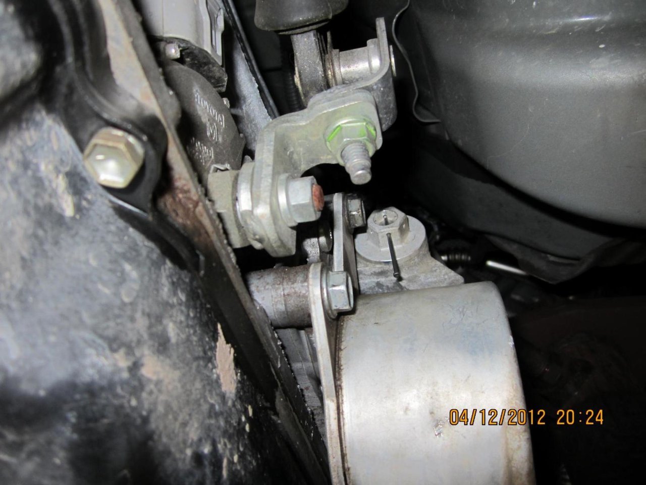

    Needs to be pinned open to insure fluid has filled the cooling system on the tow package.
    I checked mine last weekend without pinning it.
    I'm checking it again pinned this weekend; drive it around the block/purge air.
    I'm going to keep checking until I get a good drip out the check hole without having to add fluid.

    Mine was checked and needed about 3/4 qt to form a slight trickle. I did not pin the thermostat as was not told to do so on the PDF. Now you got me thinking it needs to be done again with it pinned open this time.
    Here is a pic of it on the tundra which should be about the same on tacoma (shown pinned) Press in then insert a pin to hold

    Thanks for the info. This suggests pinning the t-stat isn't needed but, if either of you two that had plans to pin it do proceed with doing so please let us know your observations.

    Now I'm thinking the correct procedure is; pin it from the start and unpin after check temp has been achieved.
