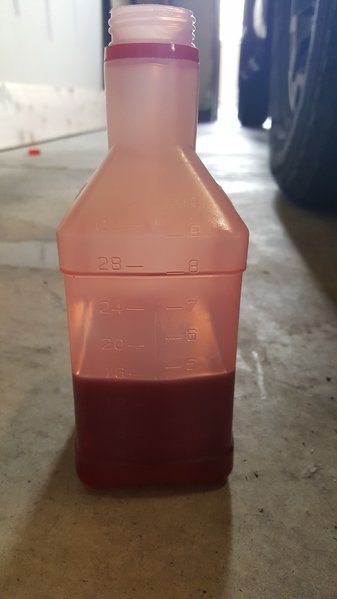

    Checked mine... .55 quarts low. This was an unopened bottle.

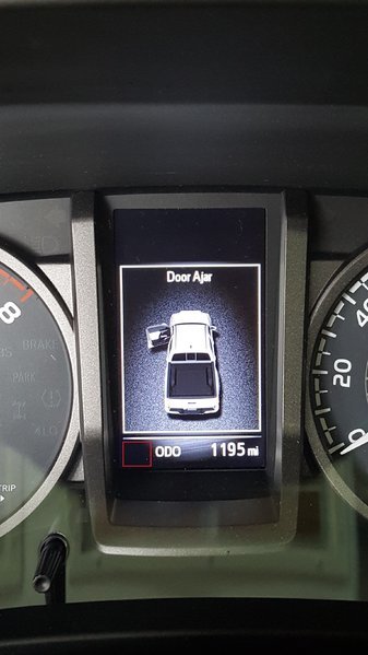

    The directions I had didn't mention exactly where the solid "D" would appear when the temperature hit minimum.
    It shows up where the square red box is in this pic.... (I edited the pic to add the square box)
    Also, I would advise anyone doing this to remove (or at least break loose and unscrew to the end) the filler plug FIRST so you don't accidentally burn your left forearm on the exhaust pipe :( AND so it's ready to quickly add before reaching max temp. If you don't need to add, then tighten/install the plug... no big.
    (NOTE: The 5mm hex head check bolt says "check" on it, the filler nut (passenger side of trans) says "WS" on it)
