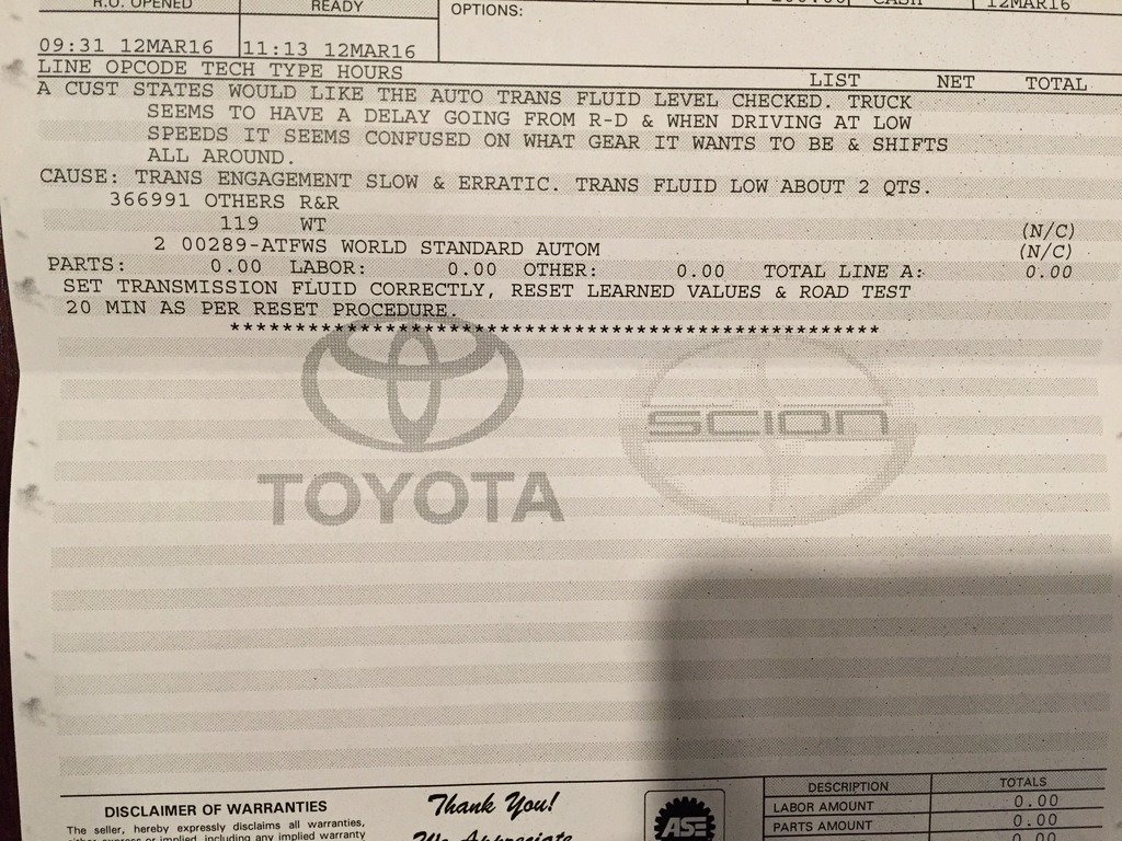

  16. Mar 15, 2016 at 3:26 PM
    #136
    16TacomaSport
    16TacomaSport Well-Known Member
    Mar 2, 2016
    #179972
    748
    Jon
    Pittsburgh PA
    2022 Camaro SS 1LE 6spd
    says leaf spring bolts. Any chance he may have been talking about the ones on each end of the springs. not the ubolts themself.
    I just dont get the issue with dealers not wanting to check the fluid and making a big deal. I guess I had a nicer dealer that gave me no hassle took it right in and checked. Also the tech did note on the wrtieup he did feel the hesitation from R-D so guess he was able to recreate it.
    Oh here is a photo of my service write up.
    In case some others want to start printing these out and taking to other dealers giving them issues showing alot of others are having problems
