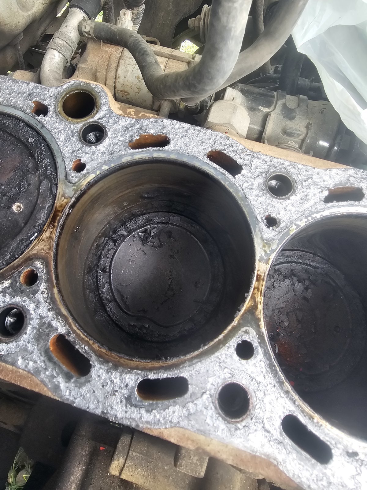

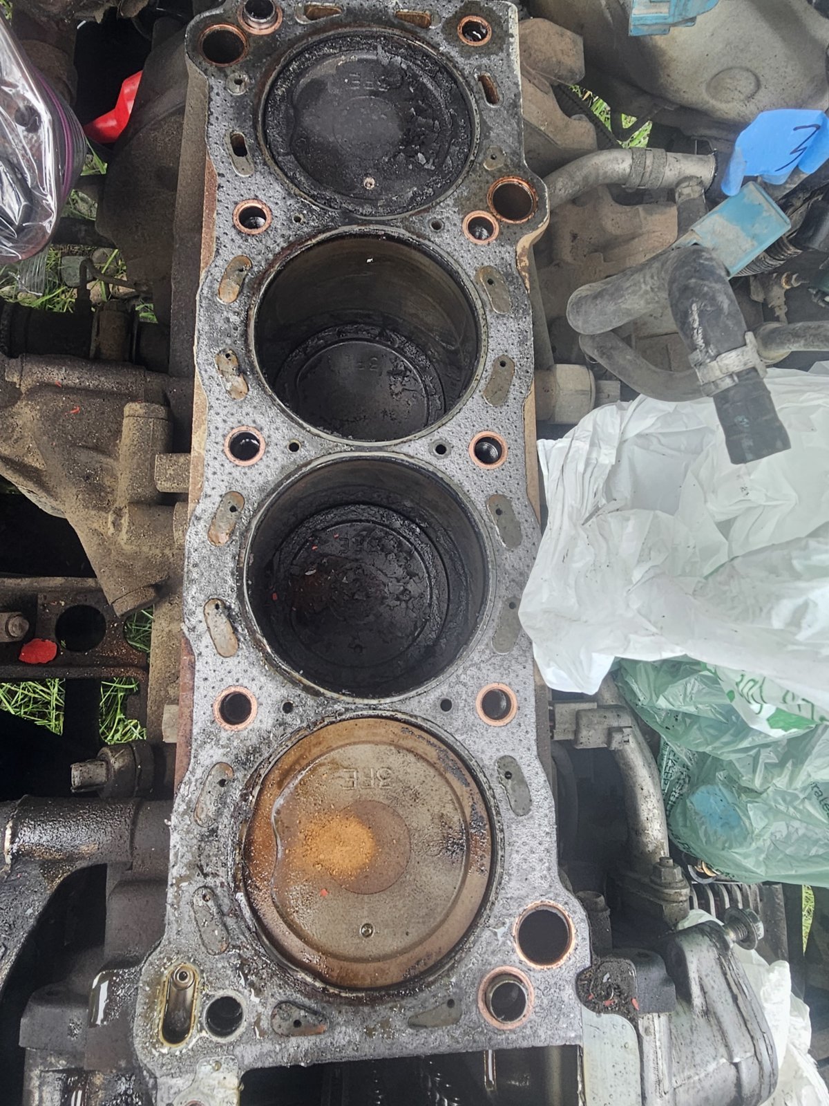

    after inspecting the head gasket it failed on all four cylinders torn all the way around. i will include pictures, but this is where i am really in need of some advice.
    cylinders 1-3 are heavily coated in carbon build up and residue. pitch black flakes.

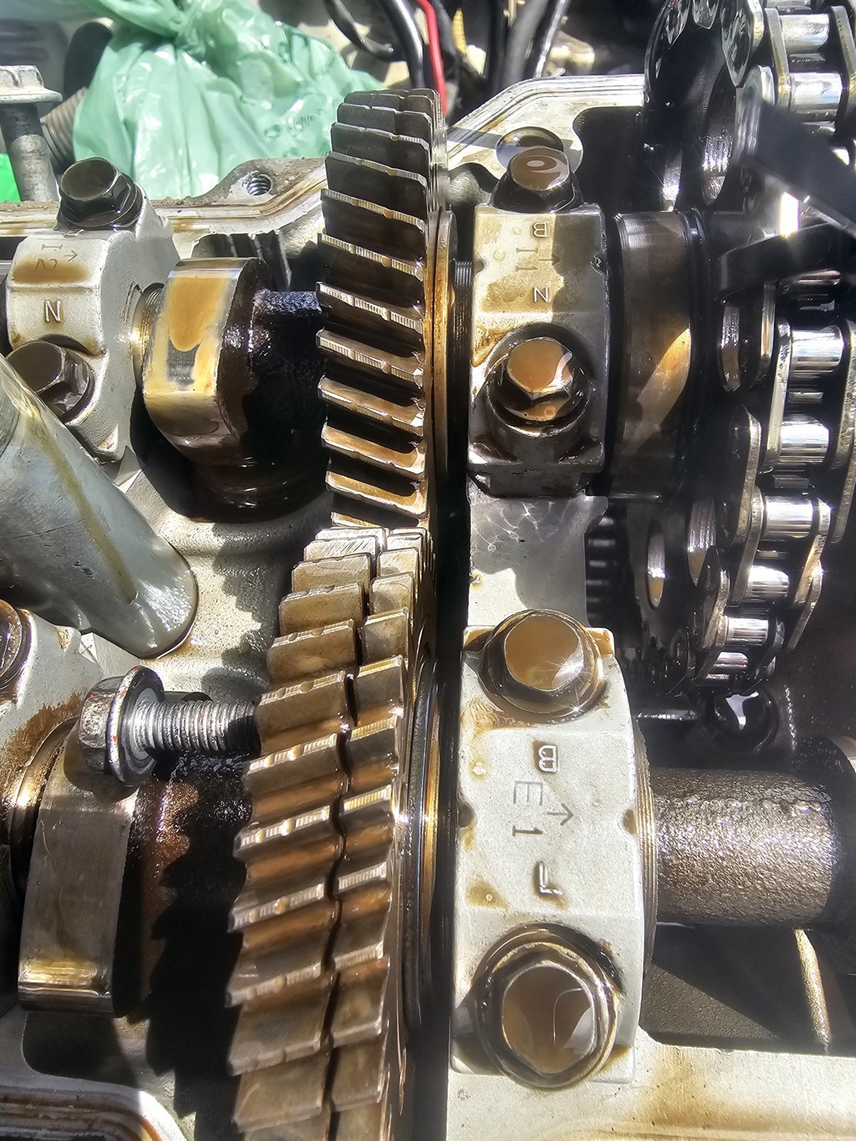

    i also had questions about my cam shaft gears. looks like theyre torn up pretty bad. get new cams?
    the whole engine was majorily out of alignment which likely put all this into motion.

    Looks to me like only one cylinder failed - the clean rusty one. The rest look normal to me
    As far as clean up goes, plug all the holes you can and start scraping. Try not to scratch the block too bad. Don’t use abrasives or anything that can come apart and leave grit in your engine.
    What makes you think the cam gears are bad?
    What is an engine out of alignment?

    thats good news! i only started the engine once when all this happened so it hasnt ran for more than 3 mins in the course of a month and half. i plan to start cleaning everything tomorrow.
    it was simply a speculation about the cam gears as i saw what i thought was grinding. im not 100% sure about that.
    when i started roatating the timing chain the engine wasnt in line on dead center before i started working on it. maybe the valves werent aligned properly because i have heard small tickings for the last 4-5 months i would say.

    How many miles on that block......
    it looks the oil ring has failed......which is the first one to go.

    I notice the head looks way cleaner than the block.......wonder if its on its third head gasket.....or even replaced.

    Look at the honing in the cylinders.....still see cross hatching...
    see any shiny or wear paths in the walls?
    clean em up and look real good......post anything questionable
