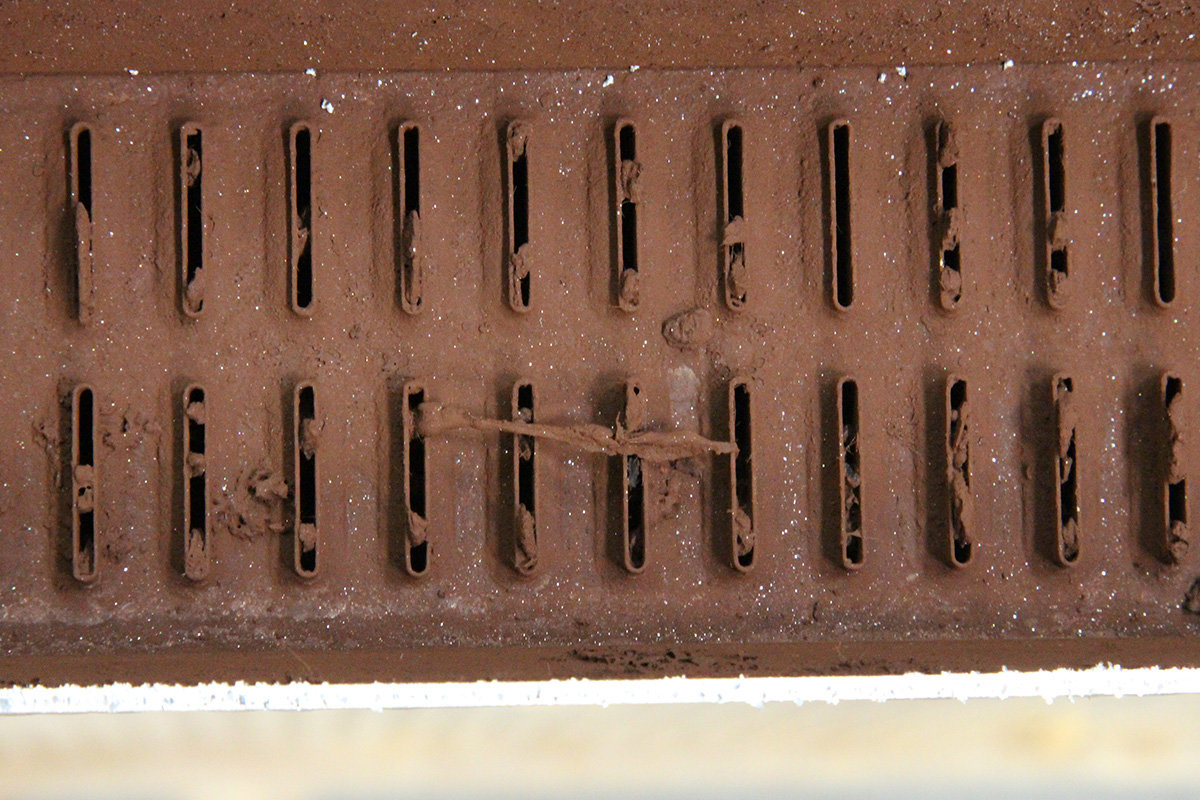

    The way I found out the red.....I tried to flush it out in a new motor that was 6months old.
    It took about 8 or 9 hot flushes to get it out.....cold water didnt do anything.
    it just kept coming and coming and coming staining the clean water...
    probably the heat bleaches the red out of the coating eventually...
    For those set on the red....its not gonna kill you.....just change it more often...like you would with regular anti-freeze....
    Here's what red looks like after 6mo in a new engine...
    https://www.youtube.com/watch?v=Fa5CYRtga9Y
    that is messed up.....

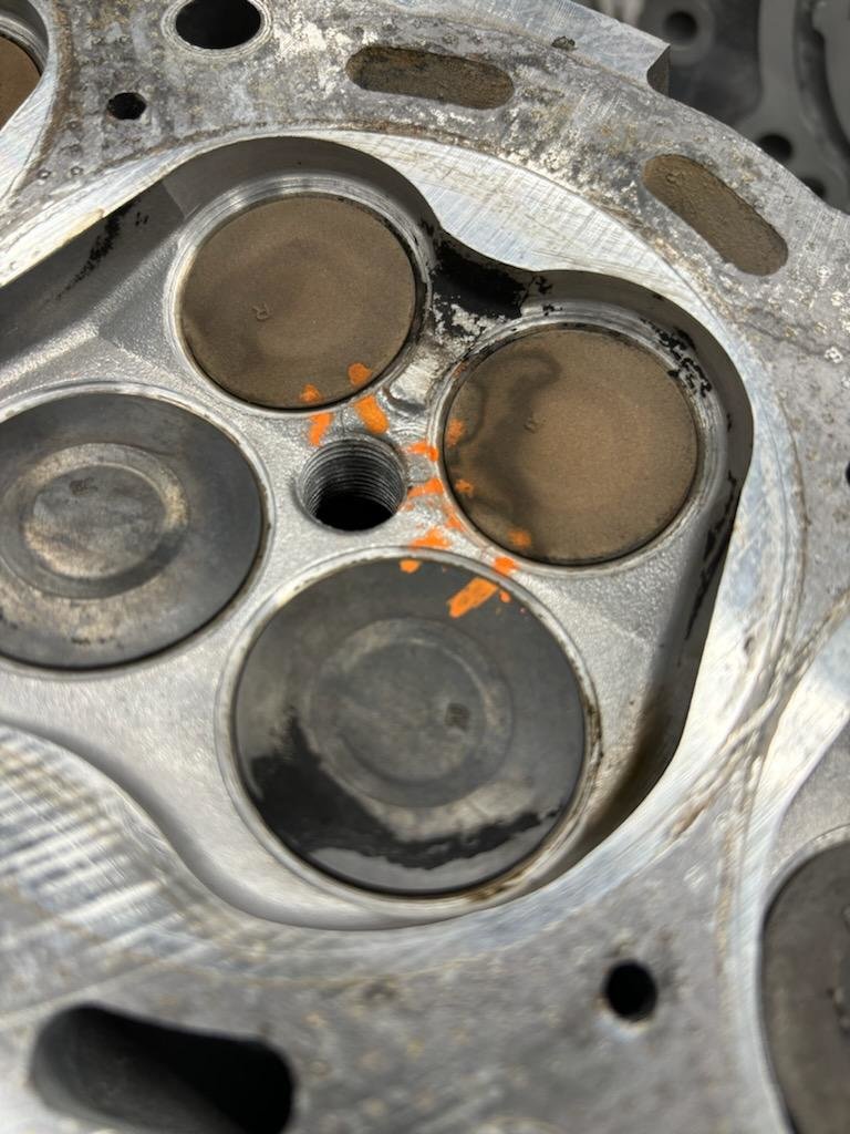

    todays the day. got the head back from machinist in town, he charged 50$ and took off .05 of the head.
    got everything cleaned on the block and it looks and appears to be in near pristine condition.
    working on reasembly of the head and timing today, hoping to start her up tomorrow!
