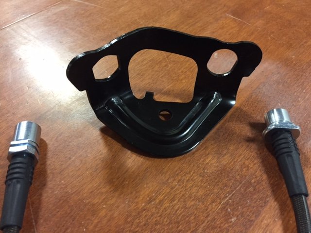

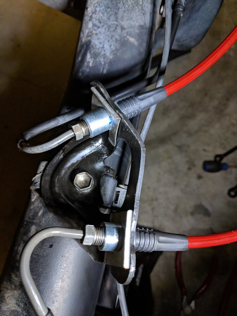

    Got from and rear brake lines from Wheelers off road. The rear has 2 different fittings, driver's side has 1 notch and passenger get side has 2. Fitment was a little off but I managed to get the clips in. I'm concerned that the driver's side fitting is shorter than the passenger get side and the metal brake line coming from the front doesn't screw in as deep as the one in the passenger side. It feels like it seats well but I haven't bled the system yet to check for leaks.
    Anyone notice this on their wheelers extended lines? Fittings we're hand tightened with the mounting brackets loose which makes me pretty sure it's not cross threaded.
    @Wheeler's Off-Road Inc can you chime in if you have any information too?
    Thanks guys, always appreciate the feedback.

    Having read and then viewed the photo, what am I looking at? I'm planning on picking up the same brake lines, I can't see what you're talking about though really. :confused:

    I think he’s talking about where the new line threads onto the male threads of the hard line fitting. The bottom one in the pic appears to not be threaded on as far.

    It looks like you got it. Just check for any leaks. But you should be good to go.
    The bracket itself has two different style holes in it. Which requires two different fittings. You basically just figure which side is which, plug, and play. :thumbsup:

    As @Rujack said, the 'male ends' from the stock metal lines thread into the the extended brake lines. In that picture, the topmost line (which is passenger side) threads in further than the one on the bottom (driver side). I wasn't sure of it since it felt like I only got 3-4 turns until it seated. Stock lines seated much deeper and got almost the full tread depth.

    Ah gotcha. yes, the fitting there is smaller but still seats well and should not leak one bit due to the rubber bushing inside seating the actual inner line. :thumbsup:

    I didn't match up holes but followed the two pieces of instructions that came with the kit. Both said to use the '2 notched' fitting on the passenger get side and the '1 notched' fitting on the driver side. I think they are oriented correctly. My concern is if there is enough bite from just 3-4 threads on the driver's side fitting since stock uses quite a bit more. If this is normal and people run this without issue then I'll just watch it for a bit. It already blows my mind that even the stock lines can handle that much pressure to stop that much weight. My naivete in braking systems makes me question a fitting that screws in with fewer than stock threads.
    I would normally just make sure it's tight and be done with it. I am planning a multi State road trip soon so I would like to find any issues sooner rather than later. I'm taking the whole family in the truck and don't want to worry about brake while we are gone.

    No worries at all! Tested and proven. There is enough bite there for the bushing to properly seal and transfer the brake fluid. :thumbsup:

    I supposed I should ask why one is indeed shorter? Why is that in the design as oppose to equal sized fittings? Curious, thanks.

    Great question: Just something the manufacturer deemed best due to the matching fitting having a deeper inset and having leaking issues by bottoming out the male oem piece equaling too many threads. So they went the slightly shorter route ensure fit and seal.
