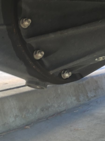

    Lookie what is going on with my 15' again...
