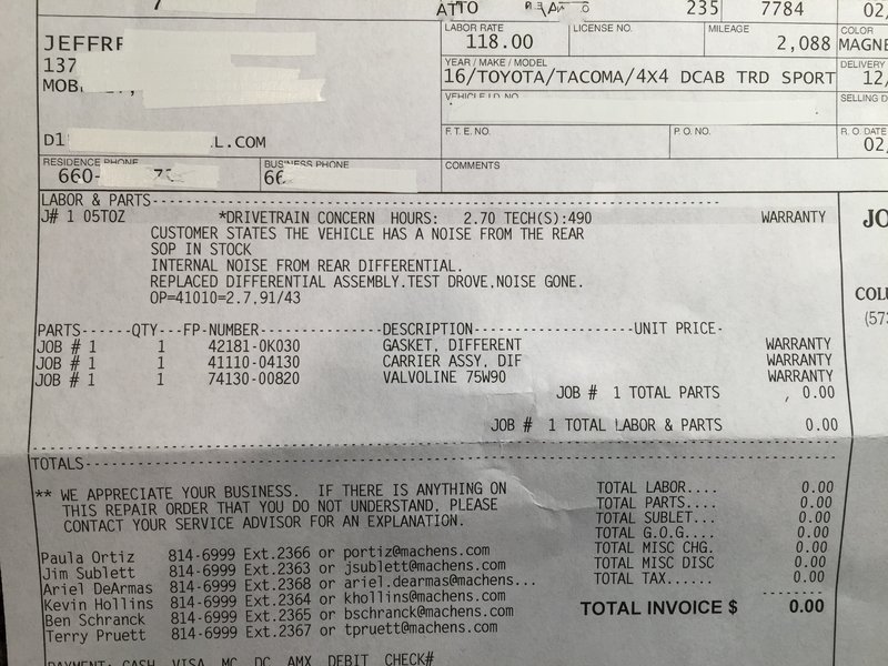

    I got mine fixed through Toyota manager getting on the phone with the factory. It's a differential gear that the tolerances were a few thousands of an inch off only on certain models/packages. They shipped the upgraded diff gears to our dealership and swapped them out for free. Noise is gone.

    yup, that was me. I posted the information for smitty99 to check out, I included the Toyota parts list too.

    Thank you so very much for posting this. I really think it'll help me prove that the sound isn't normal when I go back to the dealer and talk to the manager on Tuesday.
