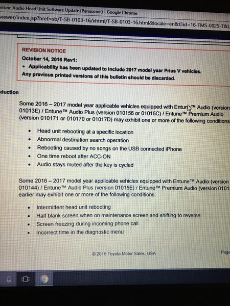

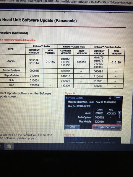

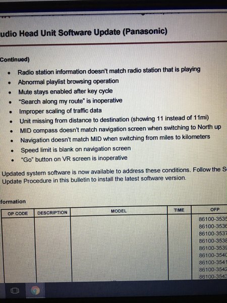

    get the radio updated at a dealer for free.
    see quotes from another thread.(there are dozens about this easily fixed issue)

    Copy that. Just found more threads with the info you mentioned. Thanks.

    There was a forced over-the-air update a while back (a few weeks?) do you think that would/should have performed the update mentioned in the TSB or was it something different? Mine just reset for the first time a couple days ago.

    That was entune. The radio update is separate, unfortunately.
