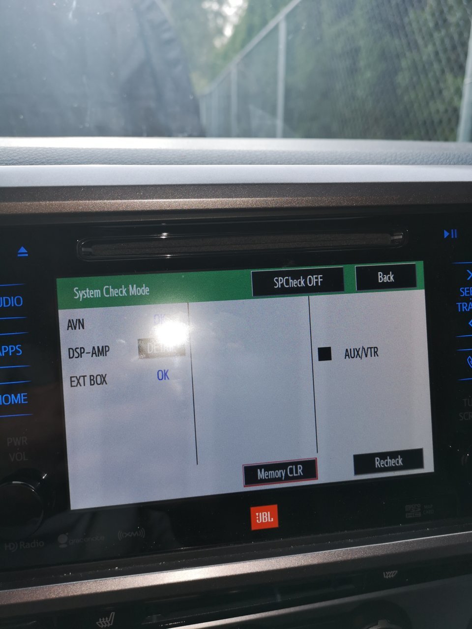

  11. Apr 15, 2019 at 5:47 PM
    #131
    Newtaco2018
    Newtaco2018 New Member
    Apr 15, 2019
    #290267
    Aram
    2018 Tacoma limited
    I realize this is an old thread, but figured I give it a shot. I put in an aftermarket amp and sub. Shortly afterwards I was unable to adjust my volume. I went into that hidden menu, and when I turn off the speaker check, I can adjust my volume again, only problem is that as soon as I leave the menu, it turns on again.is there a way to keep it off permanently?
  12. Apr 16, 2019 at 5:07 AM
    #132
    redbullrr
    redbullrr Well-Known Member
    Feb 29, 2016
    #179739
    113
    2016 Tacoma TRD Sport
    Since last update it has not done this to me anymore. However I don't have the JBL system.
    Newtaco2018 likes this.
