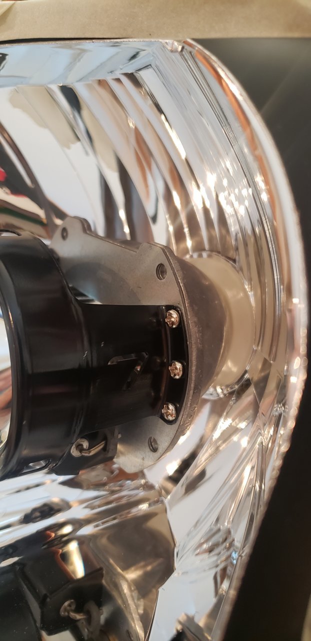

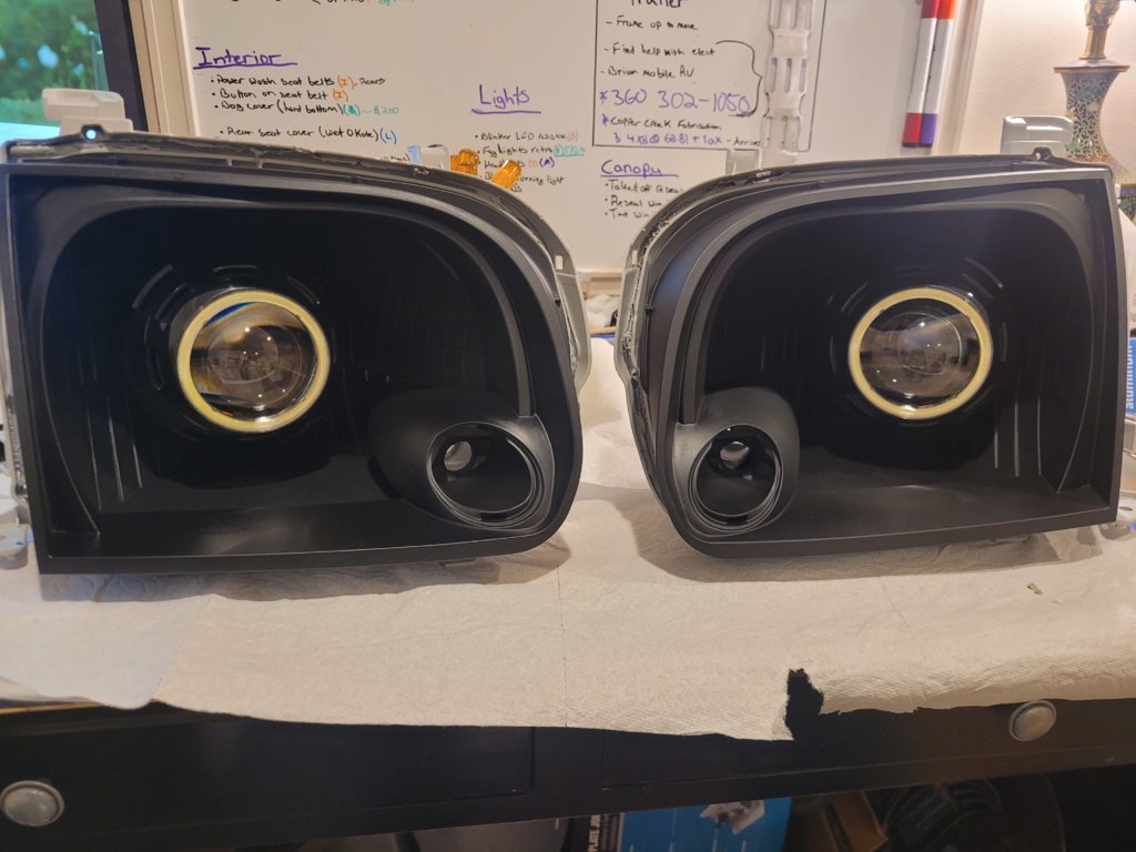

    @FlyinHawaiian21 when you built your retrofits did you have quite a bit of space behind the shroud. It looks like I need to trim but wondering if maybe it is supposed to be this way.
    This is my first time doing them and want to make sure I get it right. Any help or advice would be appreciated.
    Below you can see where the silicone ring fits against the housing but there is a significant amount of projector still showing, even once the shroud sits over it. You can tell it doesn't sit flush in the 2nd picture.

    looks fine to me. The shroud shouldn’t be near the housing. I have the Morimoto D2S projectors and they have a decent gap as well even with a larger shroud.

    I appreciate it! My shrouds are roughly an inch or more from the housing so it didn't seem right, but seems like it wouldn't be noticable once finished and sealed, just want to make sure I'm doing it right. Doesn't appear to need and trimming in the housings either. Is that your experience?

    yep! Same experience. Once you get them mounted and aimed, seal them up and you’re good to go.

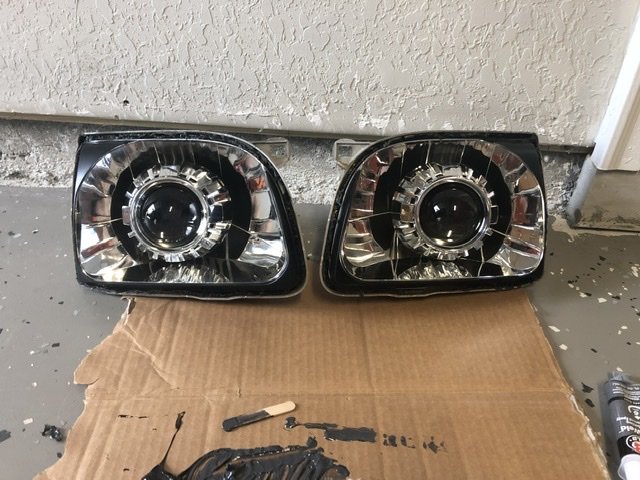

    here’s what mine looked like when they were in progress. No trimming of the shrouds and it’s hard to tell but there’s definitely a nice gap between the shrouds and housings.

    Thank you! Any chance you have a picture of the back of one?
