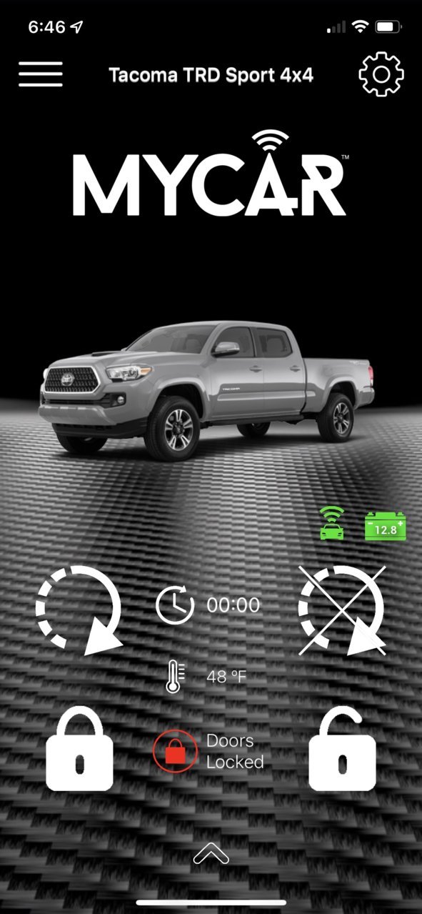

    Anybody update their cellphone module from 3G to a 4G module? Update per the replacement program in app. Remote start does not work from app. MyCar app shows good connectivity and battery voltage. Even the GPS location works. I do have a green and red light on module.Any idea’s?

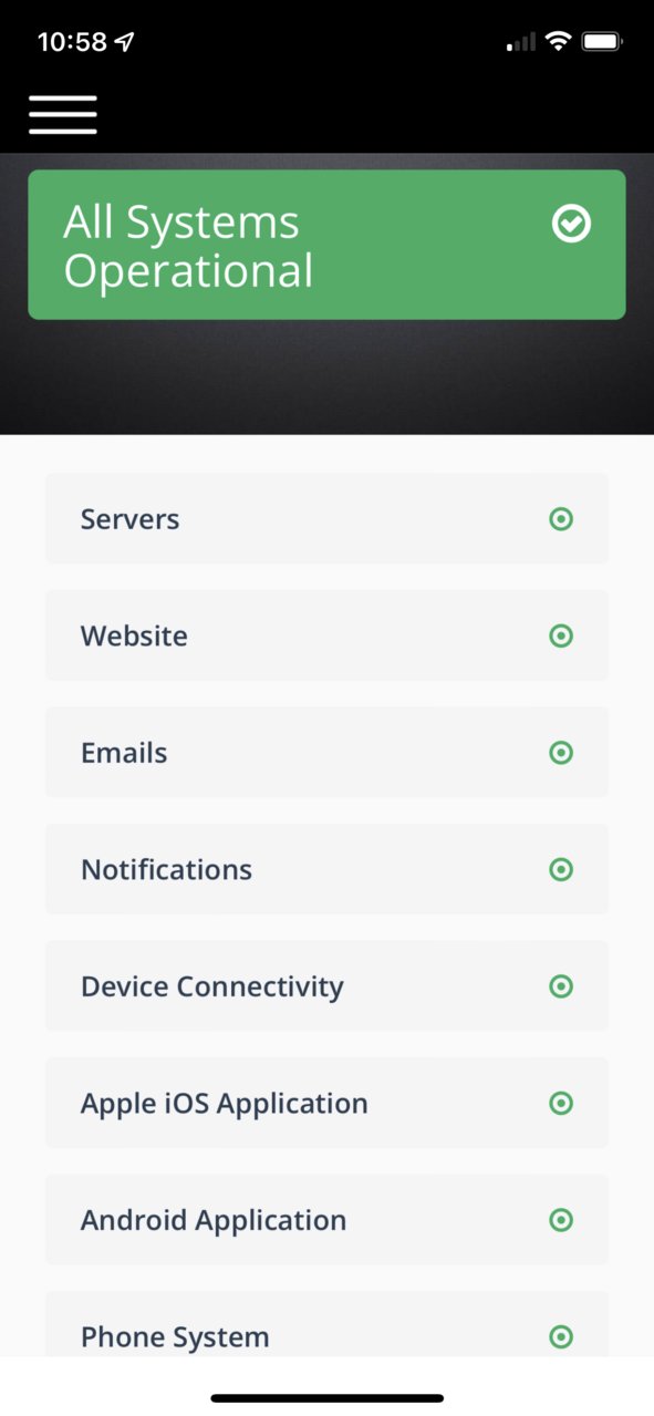

    In the status screen. Shows everything in the green.

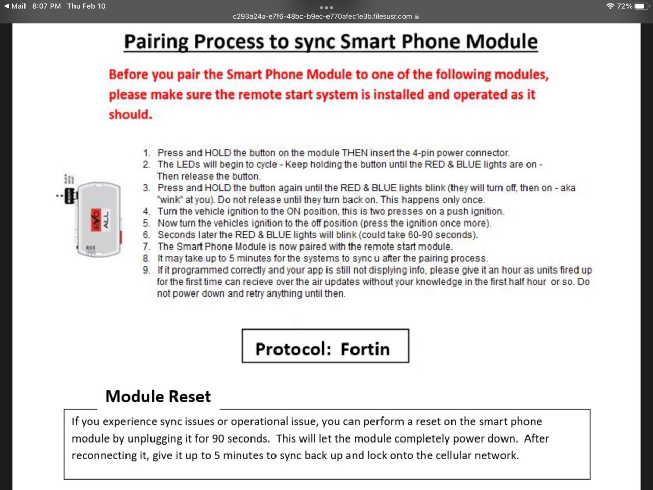

    2BE71C00-49ED-4039-BF83-5E415E729A92.jpg After getting in touch with N2 Design. Had to re sync the cellphone module to remote start module. Works like it is supposed to now. Thanks to N2 Designs for their great service..:thumbsup:
