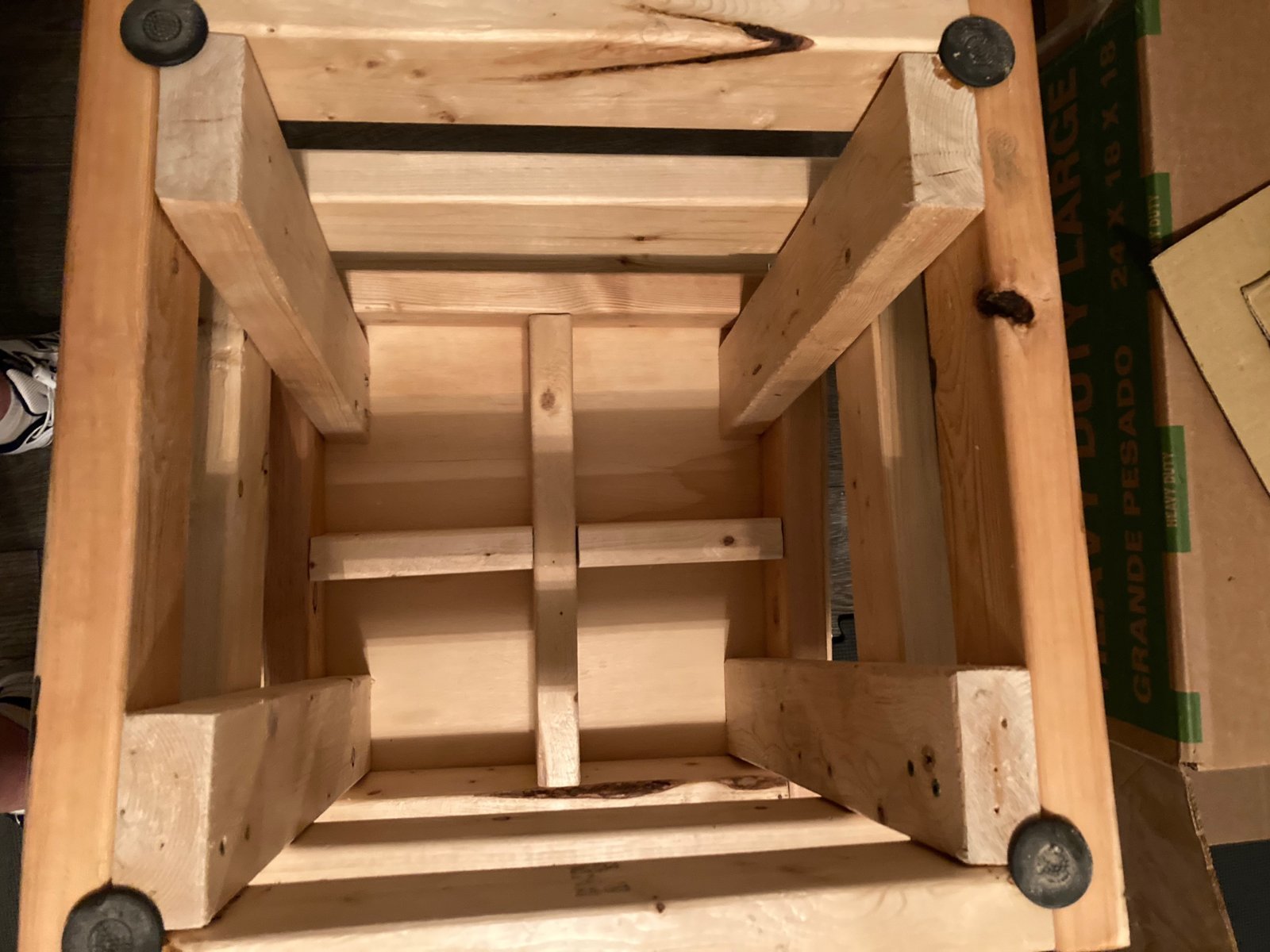

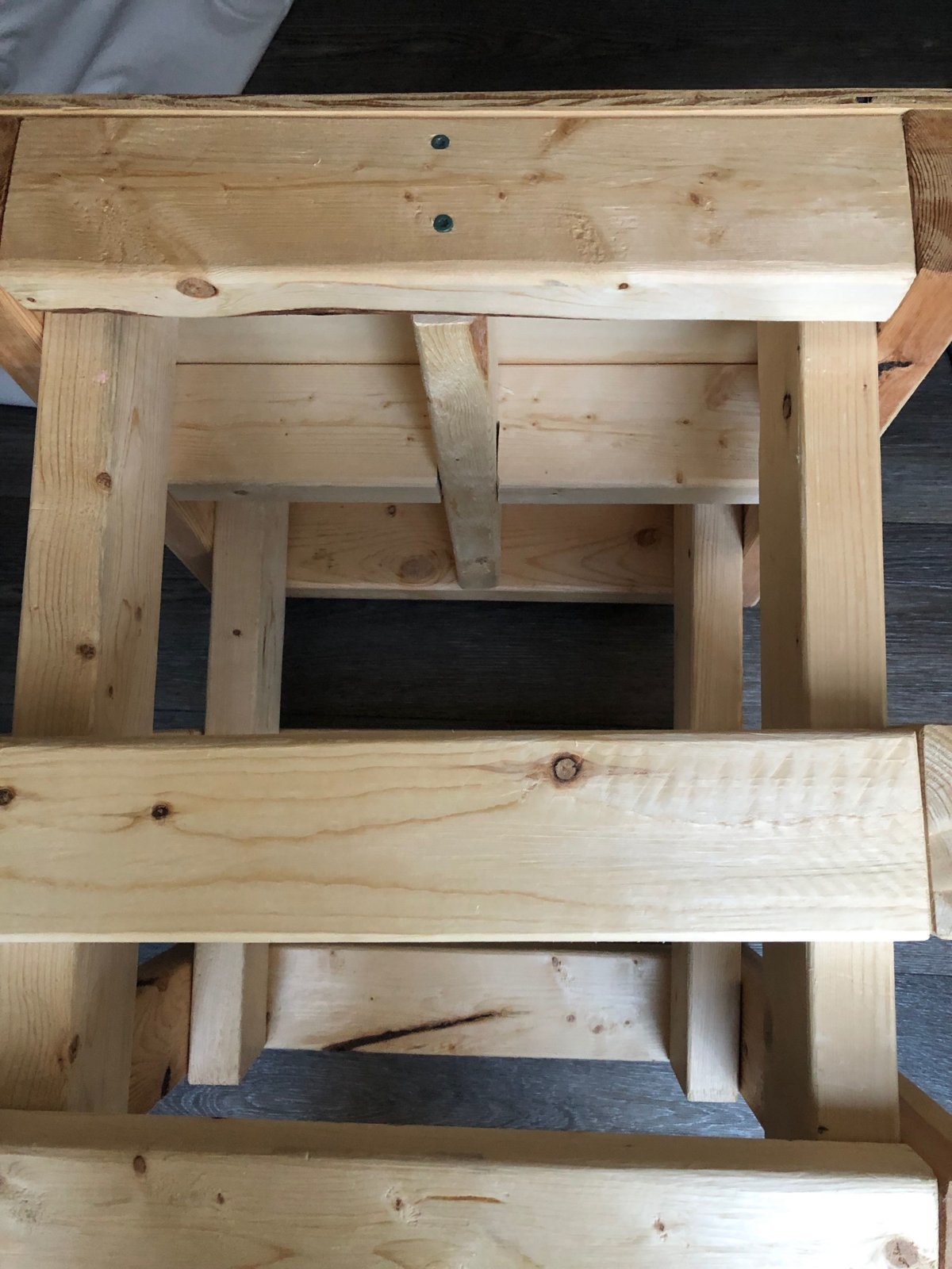

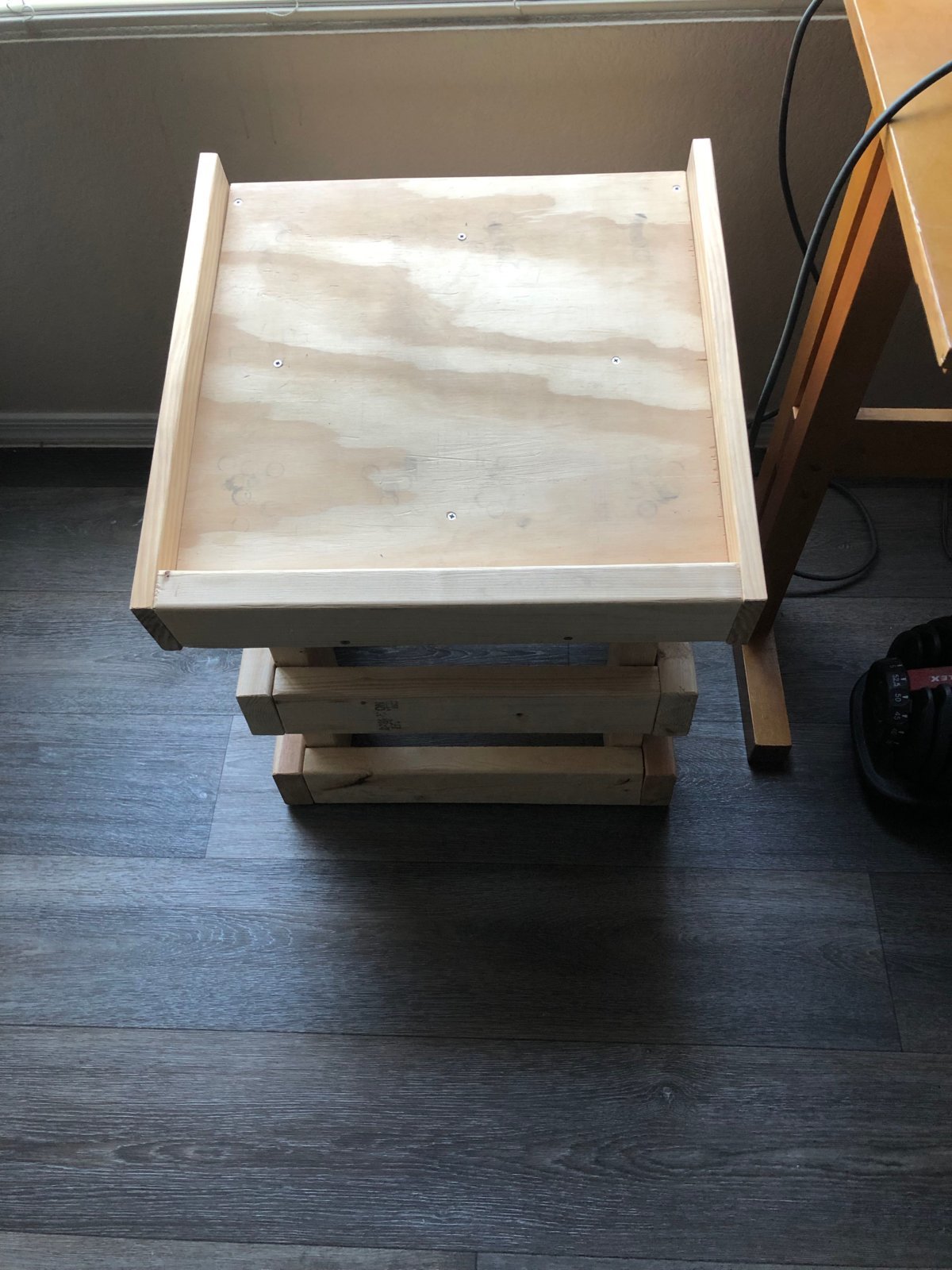

    This is a workout weight holder ... 20 inches tall, 21 inches square. 2x4s except for 1/2 in plywood on top of the crossed/slotted 2x4 support structure under the plywood.
    2x4s screwed together form a solid frame, top is 1/2 pine with 2x4s at 90 degrees with 1/2-through cuts. I can stand on the top panel without it breaking, and it holds 100 lbs of weights for 1+ hours of workouts.
    If you used 2x6s instead of 2x4s and used 2x4s as a bottom plate you *might* get away with your small laundry basket, but I would just accept the "all is just frame".

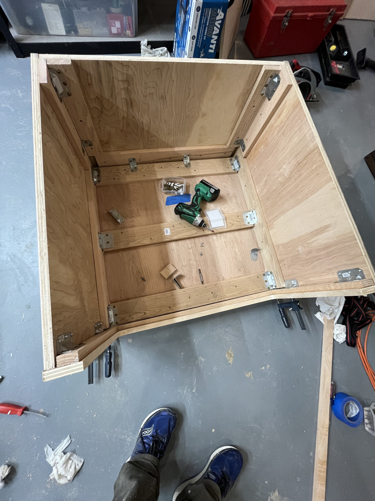

    Update, I was THIS close to buying a metal universal one off Amazon and figured I would always regret it... Ended up getting it done just in time for delivery of the washer (So delivery crew could put it on the stand instead of me sucking bad trying to do it).
    Ended up making 5 individual panels from 3/4" birch plywood with 3/4" oak reinforcement and Simpson Strong-Tie hardware. So far so good; time will be the true test... Next up: Now that I have the 29" clearance I wanted/needed; a freestanding laundry tub. I'll have to figure out how to tie the supply and drain lines into the adjacent washer plumbing.
