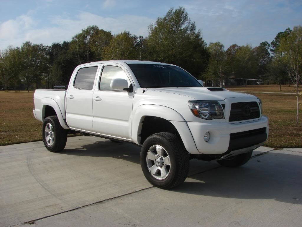

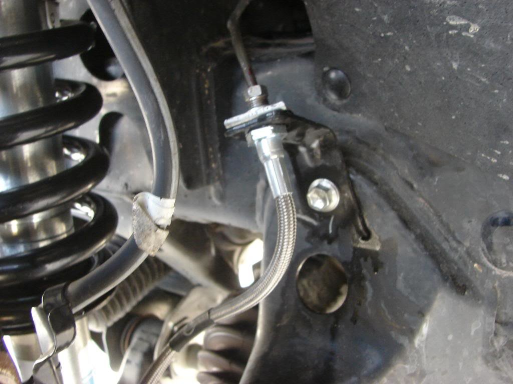

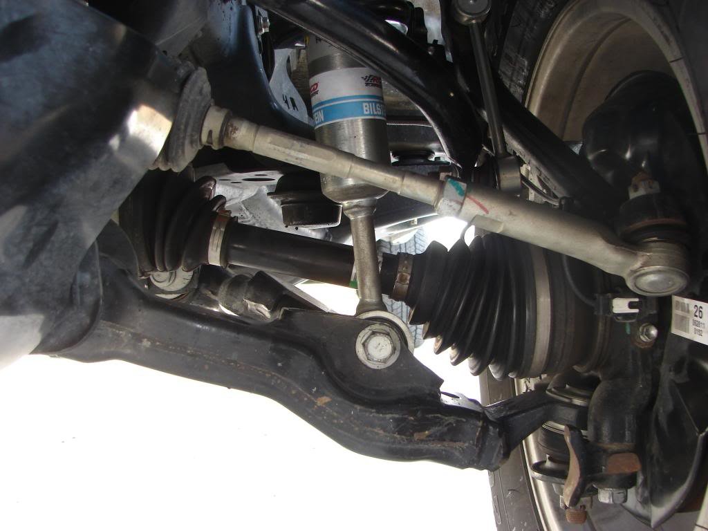

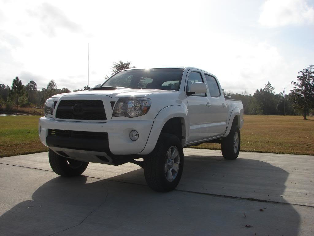

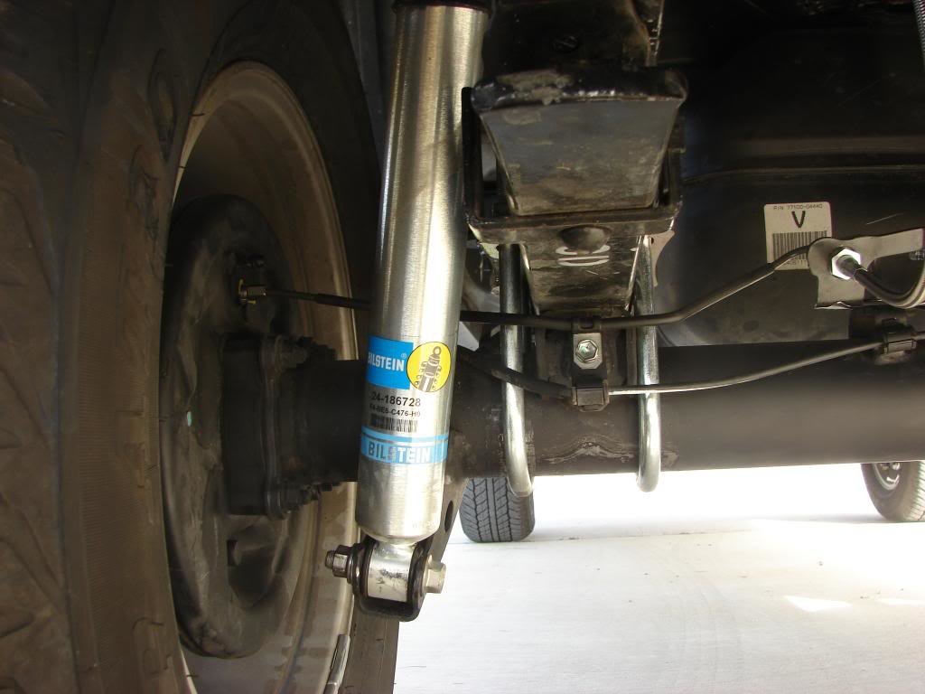

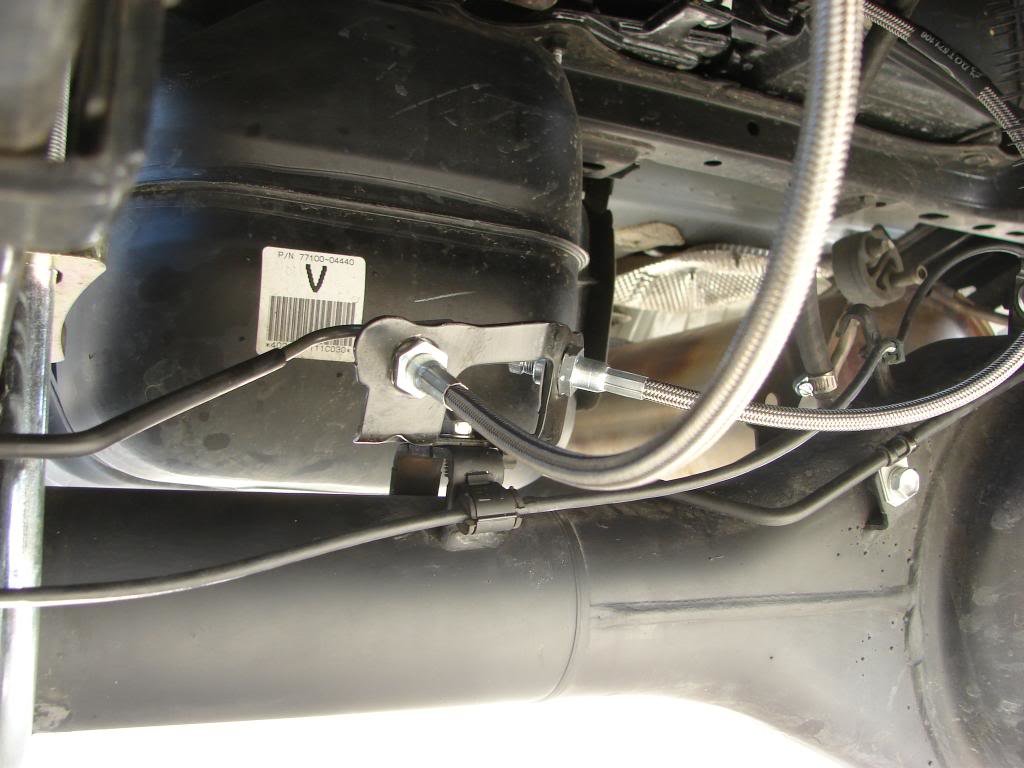

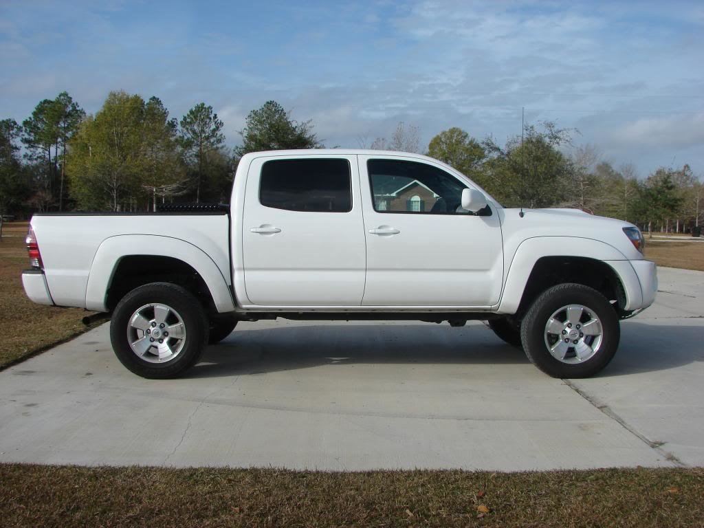

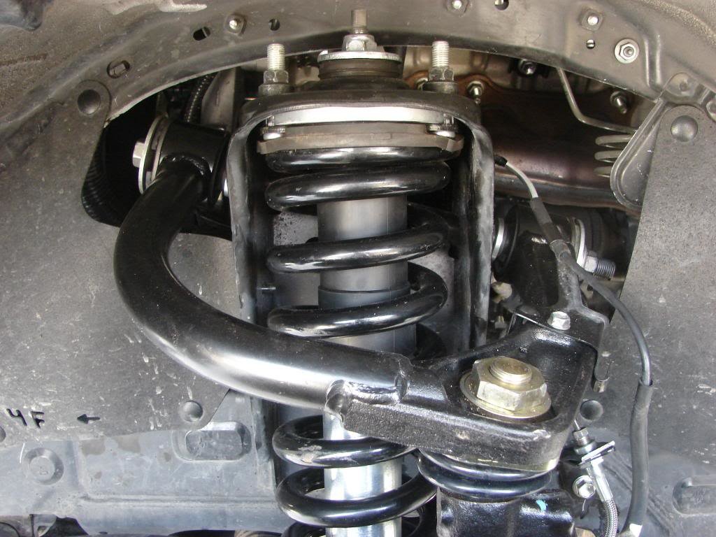

    Since I created a build thread, I decided to delete everything out of the original post. I'm leaving the pictures and specs of my lift since people are still trying to figure out what is wrong with my measurements. Thanks for any help.
    LIFT:
    -Bilstein Adjustable 5100's set at "0" (Front/Rear)
    -OME 885x Coil Springs
    -ToyTec 1/4" Top Plate Spacers
    -Light Racing Upper Control Arms
    -All-Pro U-Bolt Flip
    -All-Pro Extended Brake Lines (Front/Rear)
    -ToyTec/Deaver 2" Add-A-Leaf
    -ToyTec Carrier Bearing Drop
    -SpiderTrax 1.25" Wheel Spacers (Front/Rear)
    -ToyTec Axle Shims (Not Installed)

    From the center of the wheel to the bottom of the fender, my truck is at 24" on all four corners.

    Ok, a few people have said something now about my measurements. Let me make sure I'm doing this right.. Don't I just put the tape measure at the center of the wheel (dead center of center cap) and measure to the bottom of the fender flare? If that's how I'm supposed to do it, what should my measurements be at?

    Truck looks good, do you have any vibes after the lift? Also, are your cv boots rubbing at all? I have the same lift on order, but I think I'm going to skip the 1/4 spacer just to reduce the cv angle a bit.

    Quoted from ilovetacos in a thread back in '09. Shows he's at 23", while I'm at 24" :eek:
    What's going on here guys!? Had it installed last Wednesday, so surely it's not going to settle much more, and definitely not an entire inch!

    24" up front is huge , that's like 3 1/2 - 4" of lift over stock .
    Do you have a 4x4 OP ?

    Haven't really had it long enough to notice of the boots are rubbing. Only vibes I've noticed are a very slight one when coming to a stop, around 10-15 mph. I do have the ToyTec carrier bearing drop installed, but I don't have my ToyTec axle shims installed yet. As far as the 1/4 spacer, I ordered it because I was under the assumption that the 885's provide a little over 2" of lift, and the spacer provided the remainder needed to achieve 3" of lift.

    But in answer to the question, I do have 4x4. And I just can't figure out what's wrong. I'm reading that I should be at roughly 23". Is something wrong that y'all can tell in the pictures?

    Something doesn't add up .
    I measured my truck before and after installing 885's and I got 2 1/2" with no top spacer putting me at 22 1/2" hub to fender .
    You added the 1/4" spacers which should get you another 1/2" , theoretically putting you at around 23" hub to fender for 3" of lift , but you are a full inch higher than that at 24" .
    Any chance the billies are set at .85 ?

    Just went outside to check. There are THREE visible notches on the 5100, which means the spring perch is resting on the fourth notch, correct? Isn't there only 4 settings on them? Or is the one it is sitting on the .85" setting?
