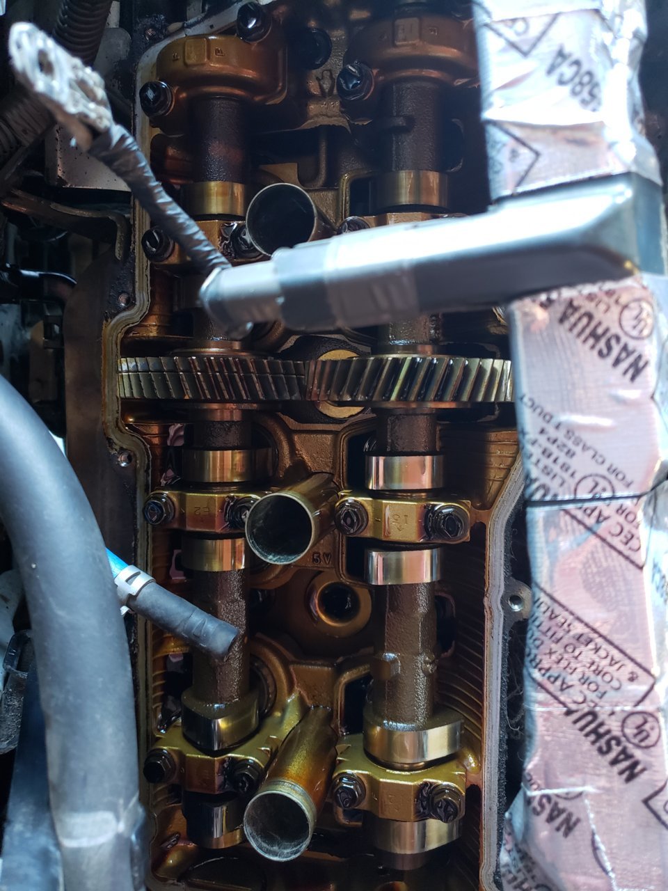

    I am TOTALLY a Mobile 1 engine oil guy. That stuff is consistently rated #1 by all kinds of publications... And after recently doing my valve covers at 290k miles. I believe the results speak for themselves.
    The heat varnish is not at all due to Mobile 1. I believe it's due to the fact the my truck ran hot all the time until I replaced the radiator last year.
    There is absolutely no build up or sludge or anything bad whatsoever in my valve train.

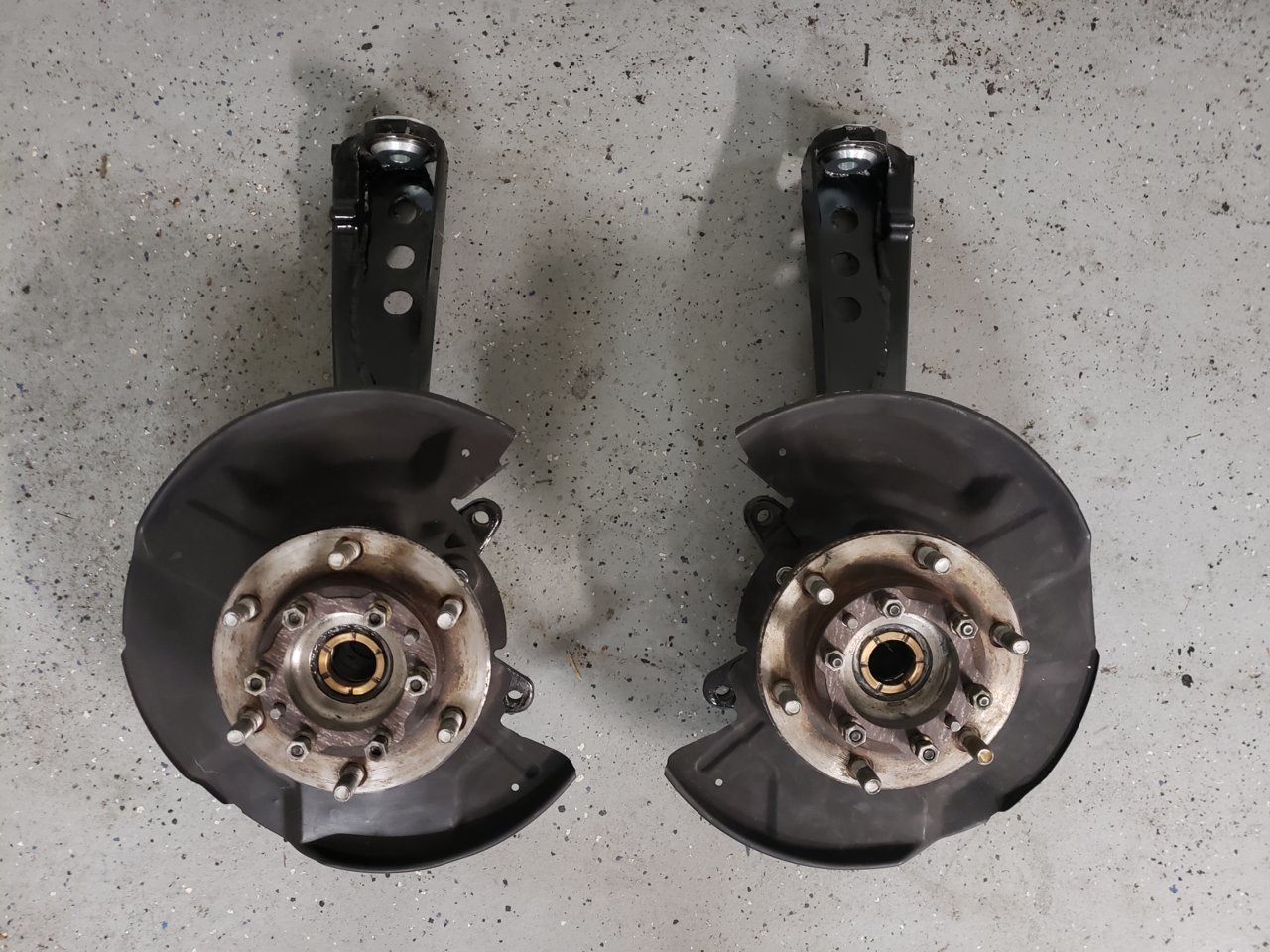

    Got the bearings pressed and the hubs torqued yesterday. Thanks to @foxrcing07 :thumbsup:

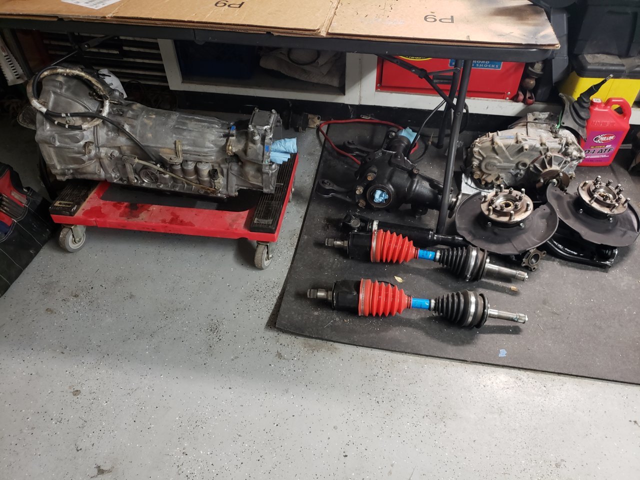

    Dropped the rear driveline off to have it balanced. (Will be able to pick it up before this weekend)
    Valve body gaskets got here today. So I was able to reassemble the valve body and close up the transmission.
    Little by little it's coming together :thumbsup:
