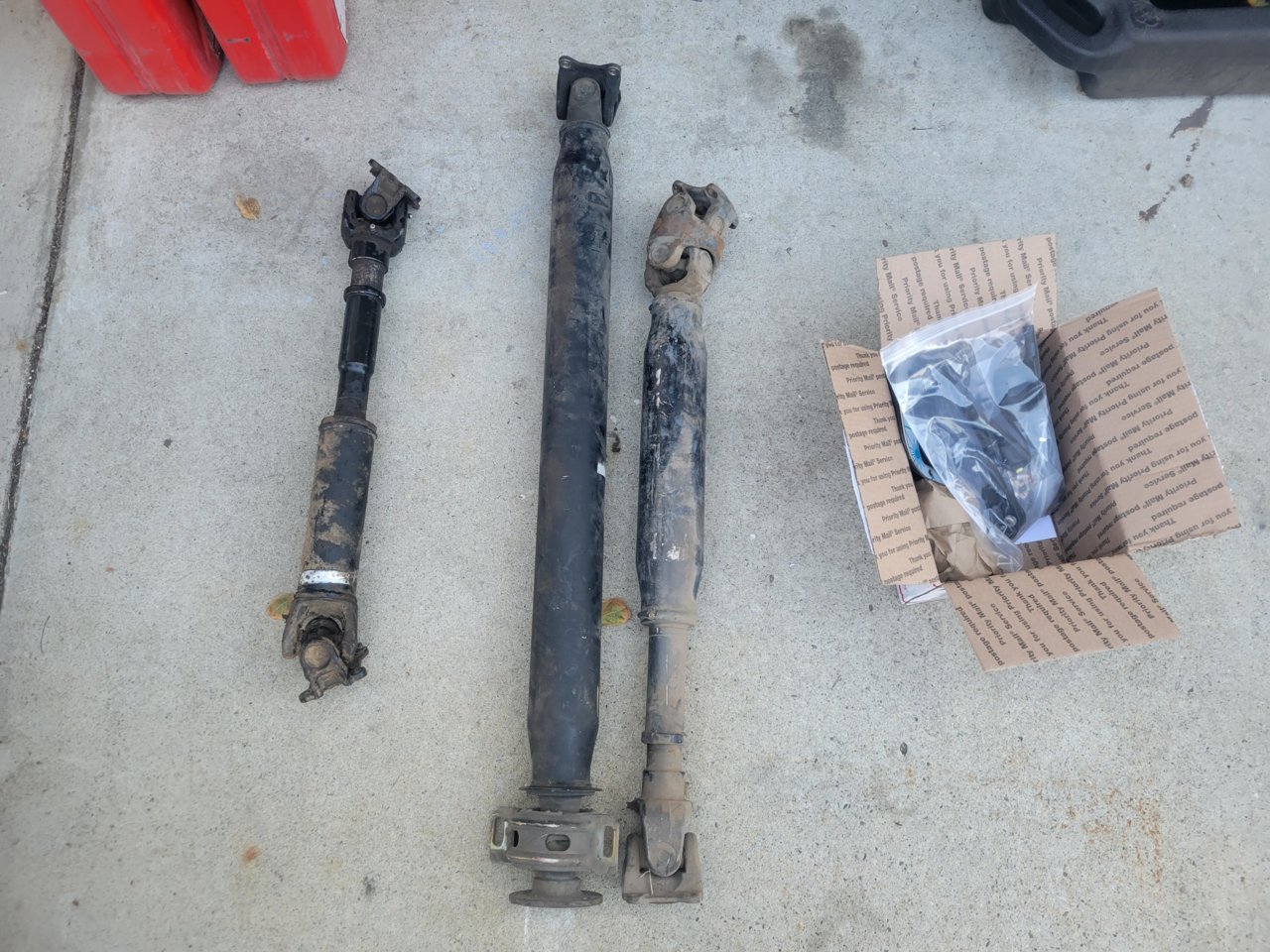

    So... 4 years later I'm dusting off this thread to add some new stuff. Not entirely sure what I'm getting in to, but I'm formulating a plan LOL.
    I'll be removing the front driveline this weekend, to get it ready to go to the driveline shop and get lengthened.
    Fortunately, I have a spare rear driveline. I'm ordering up a couple new U-joints and a new carrier bearing, just to freshen them up before I have the rear driveline shortened.
    U-joints = https://www.amazon.com/dp/B000CKR6RS
    Carrier Bearing = https://www.amazon.com/dp/B00GAPFD2E

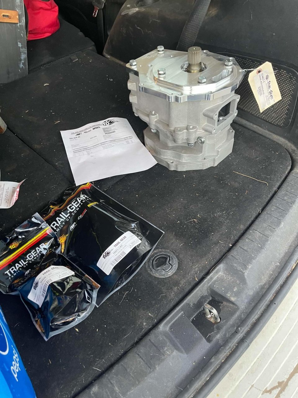

    Just 3 tons of fun!!!
    My buddy picked up from Trail Gear for me. (So, I don't have to drive down to Fresno on a weekday.)

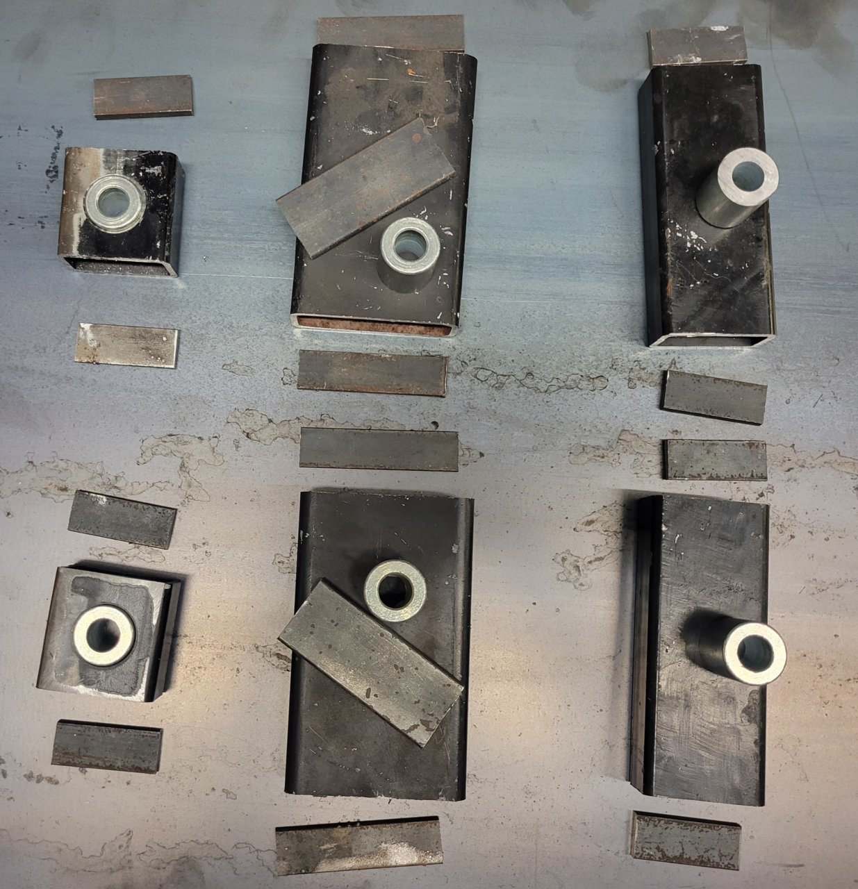

    Made some progress on the dual cases. Not a lot, and in a round about way. lol
    Removed the front driveline (to take to the shop and get lengthened)
    Found my Pre Runner Drive line front section in a pile of parts, got the back section out of the truck (kept in there as a spare) (to get shortened)

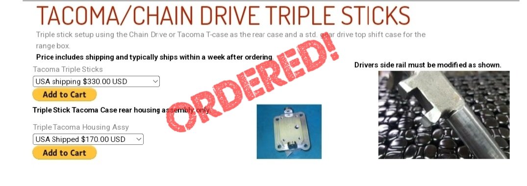

    The Triple Sticks arrived, as did a new Carrier Bearing (I'll put the new CB on before taking the DLs down to get cut and balanced)

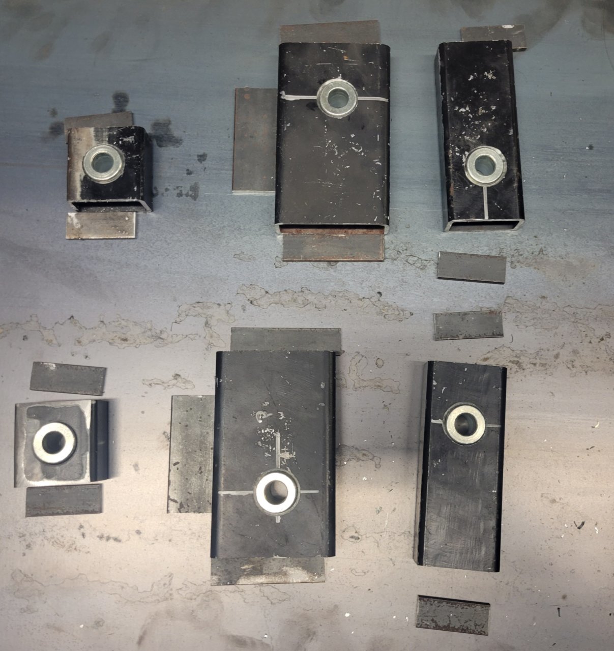

    A body lift is going to be part of this adventure. Should give me more room to work. And make it so the holes in the floor board don't have to be AS big.
    A body lift isn't needed for a dual case... but it'll also be useful for other future plans. I've had a Daystar body lift on the shelf for over a year. Just needed a good reason to put it on... now I have a few.
    The blocks for the bed body lift are a little on the small side for the weight I carry, so I needed to make up new (bigger) ones to distribute the load better.
    I got the measurements I need, cut the blocks and the camps for the blocks, and drilled out for 2 of the bushing sleeves yesterday.
    Got side tracked with some other stuff today. Needed to clean up the garage cause I was tripping on shit all day yesterday. But still managed to get the rest of the holes drilled for the bushing sleeves.
    Now I just need to grind the sleeves flush and bevel them, clean everything up, and zap them together.
