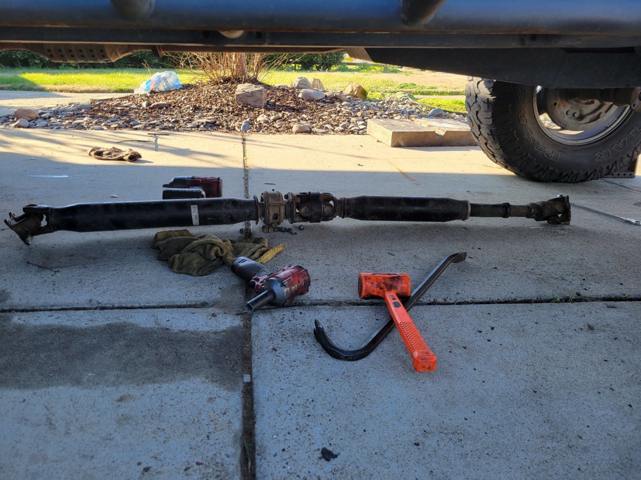

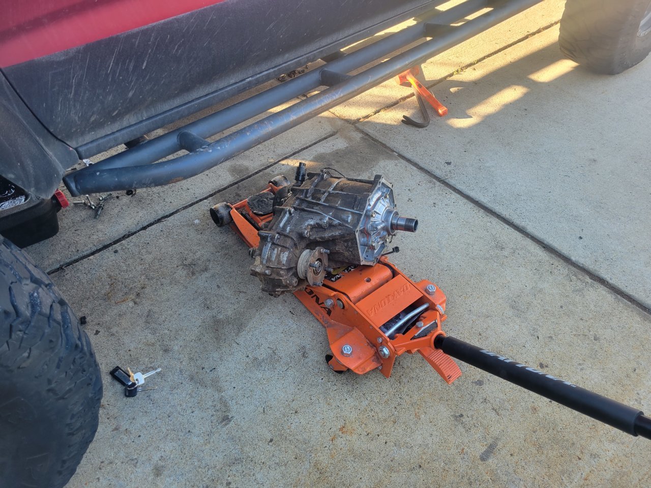

    Little bit more progress.

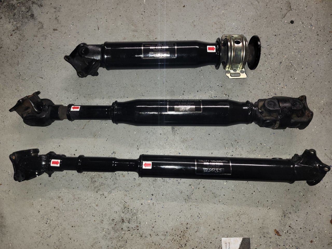

    Step one and step two are complete

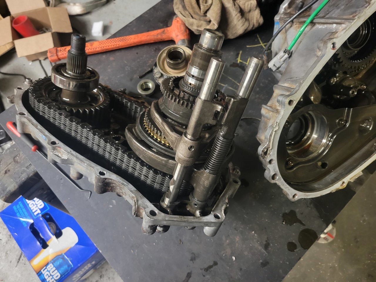

    So... I'm assuming the cut shift rod in the stock case is referring to cutting the area near the shifter to make it so you can use twin stick.
    Because the shift rail pictured in the instructions is not in the stock case. That rail (you have to cut 3/8 inch off of) is in the gear drive case. Being that the gear drive case is already assembled, that step does not apply here.
  19. Jan 22, 2023 at 2:19 PM
    #359
    El Taco Diablo
    El Taco Diablo [OP] Professional Pinstriper
    Nov 6, 2017
    #235223
    13,979
    Matt - KN6DZP
    Hughson, CA
    Impulse Red DC, 5vz-fe, 4wd swap, LT, dual case, F/R locked
    Just 3 tons of fun!!!
    So.... I opened the J-shift case for basically no reason... lol.

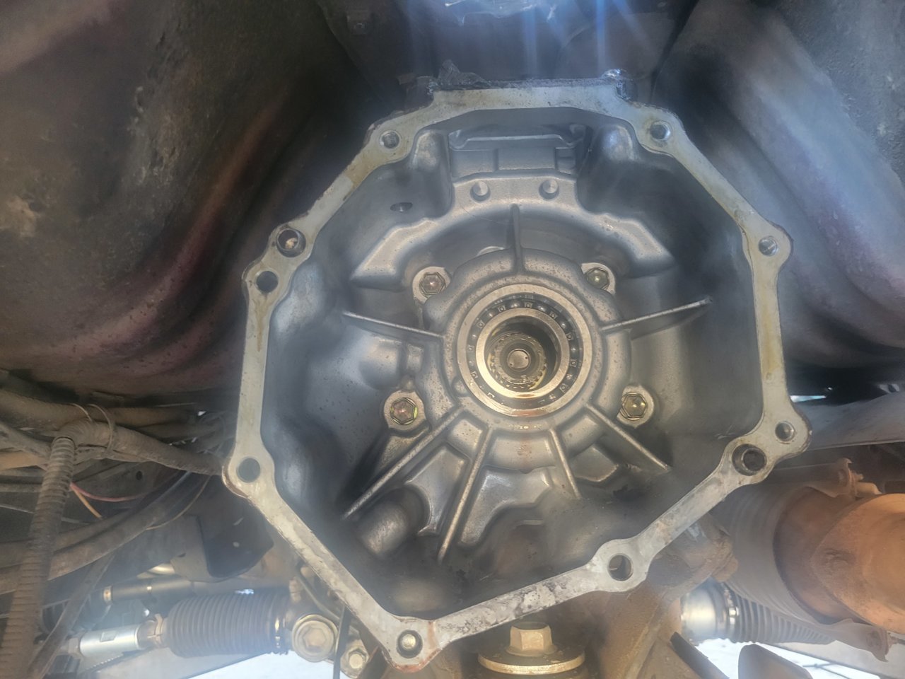

    Next item...
    The coupler doesn't fit through the output bearing on the Transmission.
    The transmission shown, I believe, is manual. Mine is Auto... which shouldn't matter.
    Even if the provided coupler fit in the trans... it wouldn't fit in the provided seal either.
