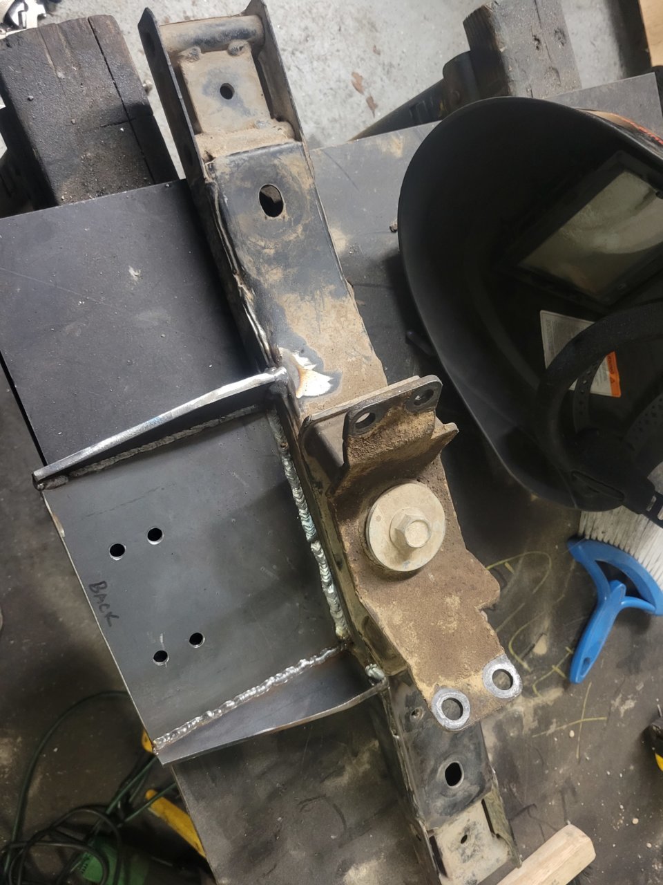

    Crossmember mount is done

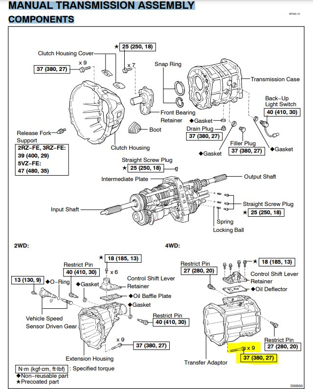

    Anyone happen to remember the torque spec for the tcase adapter to trans bolts?
    Edit... got it... 27 ft lbs

  9. Jan 24, 2023 at 6:13 PM
    #369
    Area51Runner
    Area51Runner Well-Known Member
    Jun 26, 2014
    #132748
    11,995
    Northern California, Bay Area
    02 3.4 DC TRD PreRunner 4WD SWAP
    I was looking at the AT specs :facepalm:

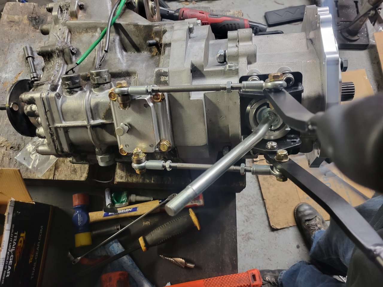

    Mated the cases to check the shifting etc.
    Glad I did, cause there was a problem getting it to go in Low on the Jshift case.
    I believe I got it all worked out. The jshift is shifting properly now. I'll mate them back up tonight to double check.
    I got the tcase adapter off and the bearing out. Tcase adapter went back on, all sealed up.
    Hopefully I can get the crossmember back on tonight and start getting some forward progress on this project tonight.

    Forgot to follow up on this.
    The Trail Creeper transfer case comes with Trail Gear's shifter. Complete with new heavy duty spring.
