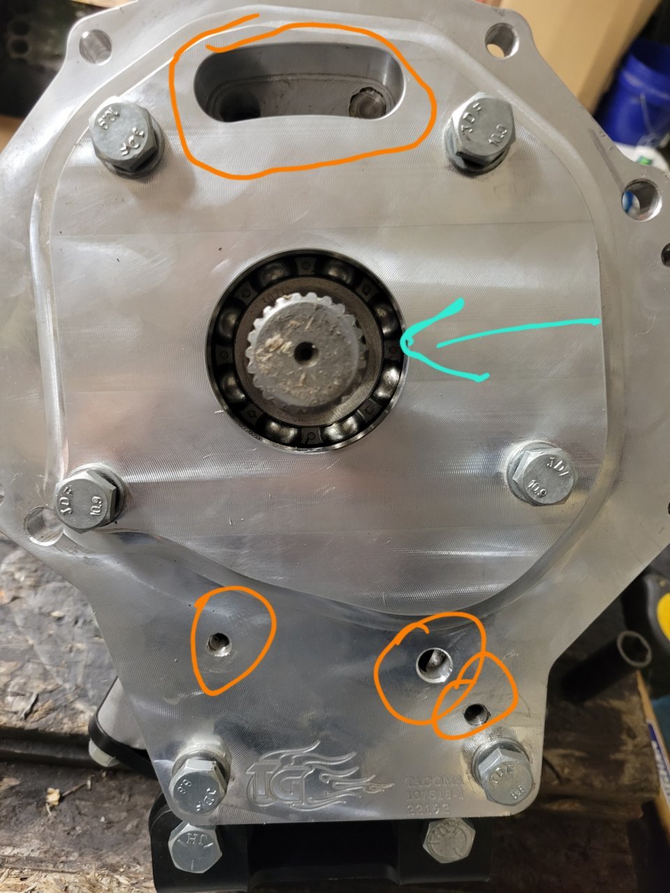

    Lower bolts circled in red bolt your transmission extension housing to that TG adapter. Bolts start on the trans side and thread into the TG adapter plates holes. Middle orange circle larger hole is an oiling hole. Right behind that is the lower bearing for the cralwbox. TG adapter to transmission extension housing must now be sealed with rtv because that cavity now fills up with fluid for more oiling capacity.
    Upper orange circled area is for the shifter shift rails to move back and forth. Just add some anyiseize or the like to prevent dry shifting when first putting together.

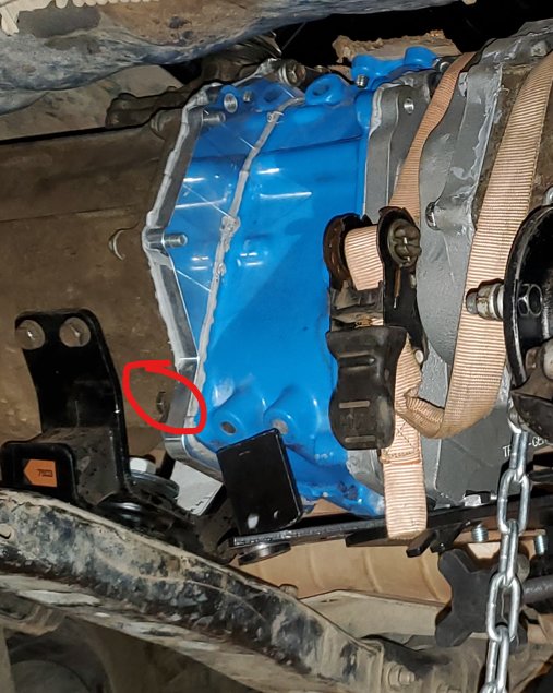

  2. Jan 26, 2023 at 10:53 AM
    #382
    El Taco Diablo
    El Taco Diablo [OP] Professional Pinstriper
    Nov 6, 2017
    #235223
    13,979
    Matt - KN6DZP
    Hughson, CA
    Impulse Red DC, 5vz-fe, 4wd swap, LT, dual case, F/R locked
    Just 3 tons of fun!!!
    There's no way to use those bolts to bolt to the trans extension housing.
    A) There's no holes in the trans extension housing to put those bolts through.
    B) If there were holes in the trans extension and I bolted the tcase to the trans extension from the side inside the trans... there would be no way to bolt the extension housing back on to the transmission.
    I think the bolts that go there are just, basically, plugs... BUT I'm seeing (I think) on @theesotericone write up on T4R that he had studs threaded in those holes.

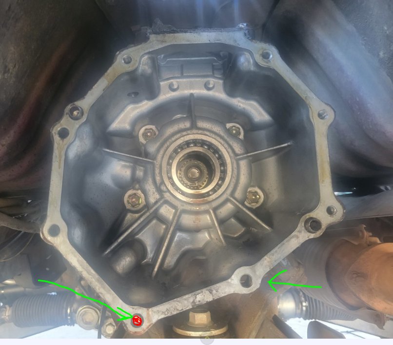

    You havn't finished all the "unmentioned mods" to fit the crawlbox. You need to drill out a hole, marked in red. Both green arrows are where the bolts start (these are flange on the transmission extension housing) that line up with your adapter. Both bolts fit through these holes (where the green arrows are, bolt go through the extension housing and thread into your adapter.) Both are accessible when the transmission extension housing is bolted into place.

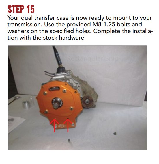

    I'm thinking the adapter is the same whether it's for Manual or Auto and you just plug those holes with the bolts.
    The instructions (the new instructions sent from Trail Gear) appear to show the same plate for Manual or Auto
    https://trail-gear.com/media/downloads/pdf/instructions/107517-1-INS.pdf

    OK... Now THAT makes sense.
    What a fucking cluster fuck... why wouldn't they mention that IMPORTANT little tid bit in their instructions? Even the "NEW" instructions they just sent me. Or, the email they just sent the link in.
    For real bro... I owe you a beer. You, Matt, Ian and others... I really appreciate your help here.

    No worries, I enjoy building these and there are some gaps in knowledge even in the instructions. **Because these thread into your adapter and will be emerge in oil, you'll need to coat the bolts in RTV/FIPG to have it seal properly or you will have leaks.**
    You will also need to scuff that powder coat orange mating on the adapter surface for RTV/FIPG to seal properly.

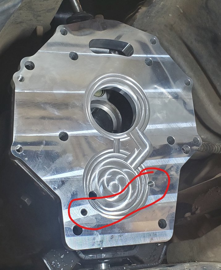

    Oh the joys of installing these LOL!!! Imagine how shitty the instructions were in 2007 when I first built mine, none, LOL!! A few more unwritten tips: coat the splines of your tcase in anti seize, this will prevent fretting corrosion which will strip out your input shaft. Also drain the fluid evrey 6months, and if it's red, drop the cases because your input is rusting and fretting out. If that was covered earlier ignore me.
    I also only use permatex "the right stuff" to seal everything, I had horrible luck with ultra grey. DO NOT goop that shit on thick, it can fan out and cover up oiling holes in the adapters.
    If it doesn't say in the instructions, you are going to have to cover the trans mount holes with JB weld so your fluid doesn't leak out those holes in the trans cavity.
    I have built a bunch of these and a lefty, feel free to ask away.

    Interesting to see how that works. I would be worried it somehow comes off the coupler and clogs up some passages in the crawl box. I used some STUPID expensive hi temp moly grease on one of mine and it flung off into the case. Anti seize has been going strong since 2008.

    I'll be another test subject on the RTV coupler.
    Cause I RTV'd the shit out that sum'bich last night.
