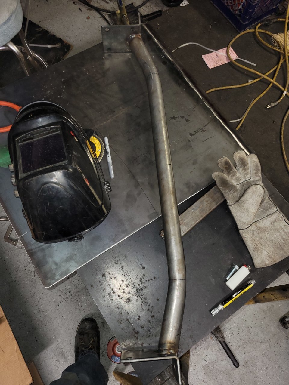

    Started making the skid plate for the transfer cases, and a crossmember to bolt the back of the skid.

    Who bent the tube for you

    Went and bought a Harbor Freight bender. I probably wouldn't use it on a bend past 45° but I knew I was dealing with bearly any bend, so I figured what the hell, I'll try it lol.

    Did a bit more to the cross member.
    And finished the transfer case skid.
