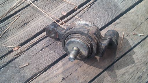

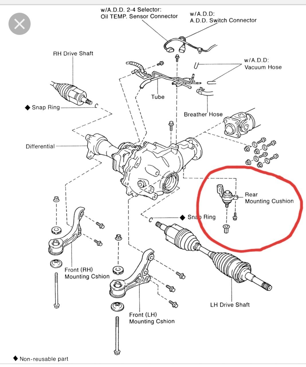

    Checked another piece off the list today thanks (again) to @Tour991.
    My diff was missing the rear mounting cushion (circled below)
    Reached out to James... and sure enough he had the part! Thanks brother!

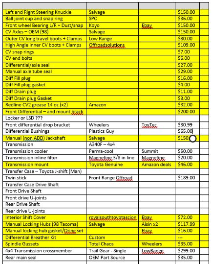

    Wheel bearings, clips, and dust caps came in... More pieces to the puzzle are now in the box.
    Here is the updated "List." Items highlighted in Yellow are the pieces I have.

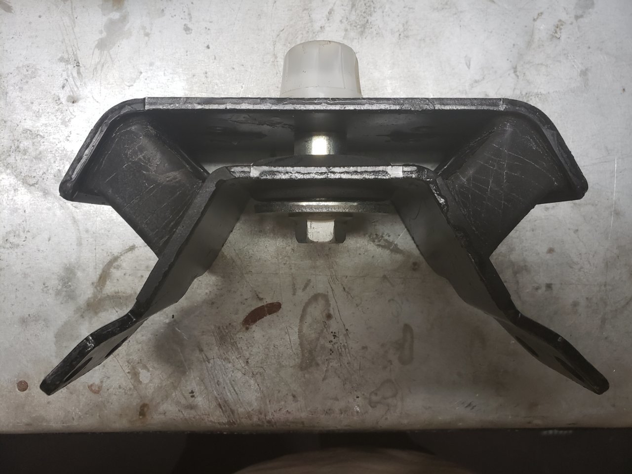

    The transmission mount arrived. Looks like it'll work. Haven't looked at the one on the truck, but I'm sure this one looks a lot better than it does.

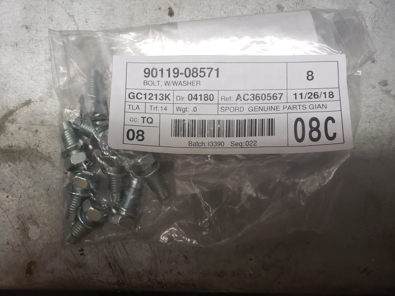

    Ordered, and recieved, all new brake splash guard bolts. When we took the old ones off @foxrcing07 and I both thought it would be a good idea to replace them.

    ok im not crazy. i bought those bolts too. everyone gave me funny looks when i spent money on bolts like that instead of just going to the hardware store. lol
