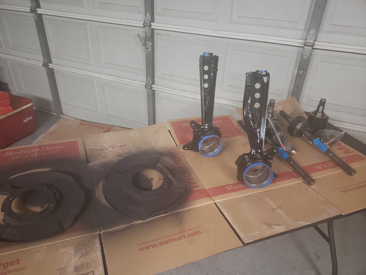

    So... Some work is commencing on this thing.
    Started painting the spindles today.
    The Por15 sure doesn't dry quickly so I started looking for something else to do.
    Before
    After

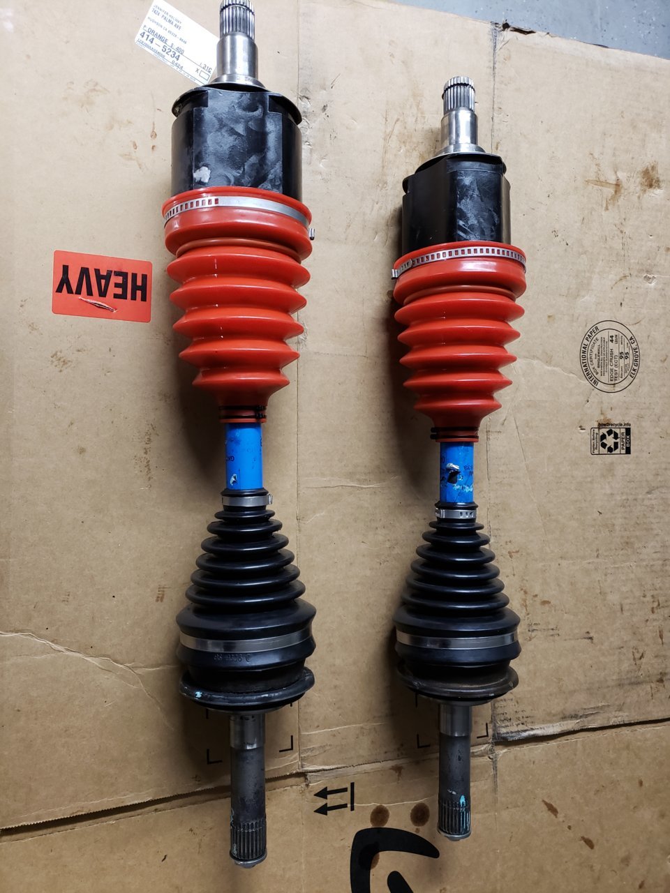

    Ended up pulling the CVs out to re-boot them.
    Fun times :puke:

    Well I got this far today...
    Positives = The Por15 finally dried. And at least the worst part on the CVs is over. Just have to reassemble when the (correct) outer boots arrive.

    CVs are rebuilt :thumbsup:
    And thanks to @Twizted for picking up the rear driveline that @foxrcing07 spotted on Craigslist for me.
    Now, when I do the swap, I don't have to worry about down time, while I wait for the shop to cut and balance my rear driveline.

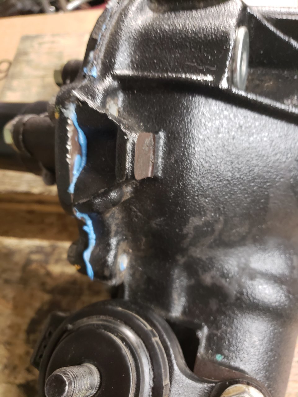

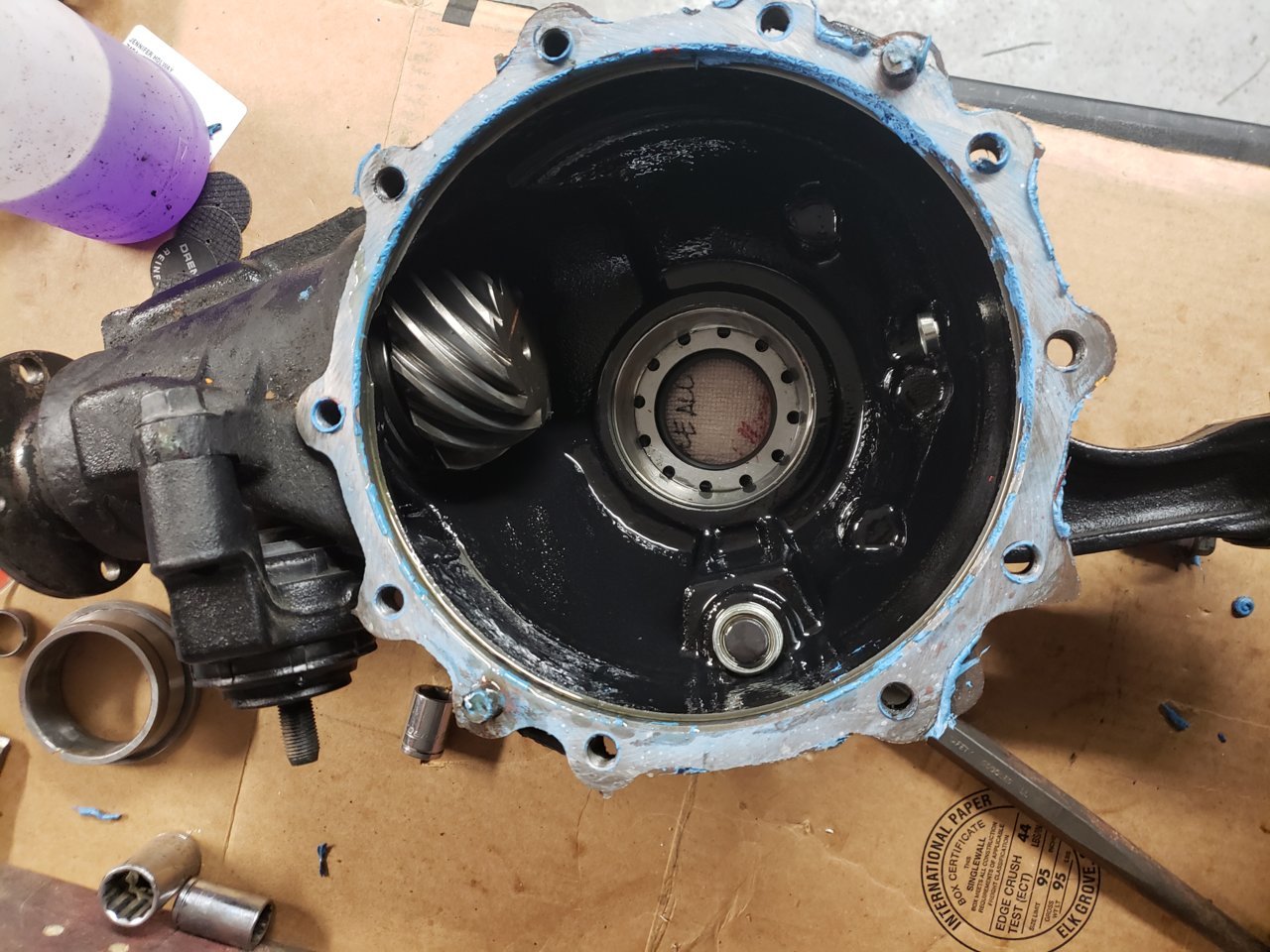

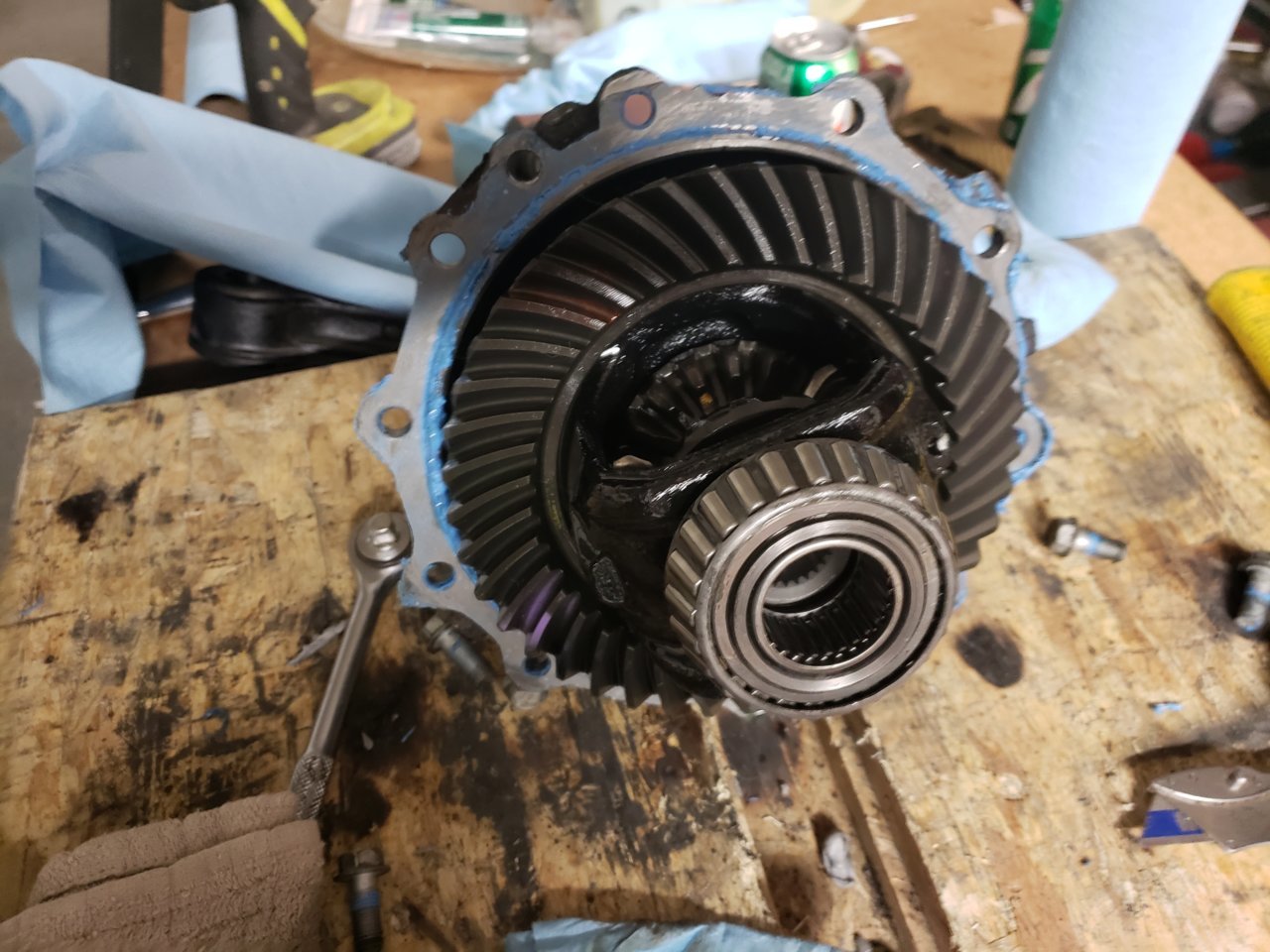

    Little bit more progress on the 4x convert tonight.
    The blue gasket maker has been bugging me. I've never seen blue gasket seal that is for diffs or for contact with gear oil.
    So I decided to crack her open. Good thing I did. I'm pretty sure, even if the blue RTV was ok for gear oil, this thing would have been a leaker. Almost no RTV on the mating surface. It appears it all got squished out.
    Took a while to clean everything up. But we used gear oil compatible gasket maker.
    Put everything back where it goes, and just bearly snugged the bolts. I'll let the gasket maker set up over night and torque the bolts tomorrow.
