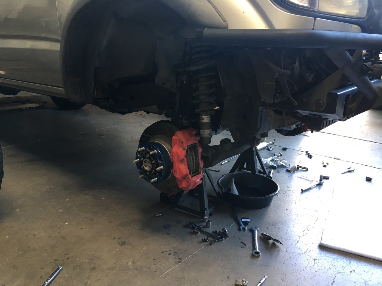

    So... The Spidertrax "Hub centric" spacers just became, basically "Lug centric" spacers. To make room to run them with Manual Hubs.
    I made a jig to keep things from getting too far out of control.
    And for the record, to get the All Pro extended thread lug nuts to fit, you have to drill out the 1/2 hole to 5/8.

    Pittsburgh, Pennsylvania
    Flux Capacitor
    What were you doing with the wheel spacers? Lil’ confused with what’s going on there.

    Impulse Red DC, 5vz-fe, 4wd swap, LT, dual case, F/R locked
    Just 3 tons of fun!!!
    Hub centric spacers won't work with manual hubs because the inner ring hits the bolts that hold the hub body on. Had to rout out the inner ring to clear the bolts.

    Tyler
    Flux Capacitor
    Ah I see. Why are you running spacers out of curiosity?
    Because it looks more badasser :burp:
    Also, because the gussets on the spindles may not clear... and I'm dinking with the idea of eventually outboarding my rear shocks.
    Main reason... Because it looks more badasser.

    2003 Prerunner TRD
    4wd conversion
    I was lucky enough to already have a set of those before I did my swap haha. Got them a while back to clear my tires and it just worked outC75970C3-89AE-4E85-A404-108870BF3011.jpg

    Tyler
    Flux Capacitor
    Got a pic with the wheels on? I need spacers for my 3rd Gen wheels since the Backspacing is so bad.

    Flagstaff, AZ
    2003 Prerunner TRD
    4wd conversion
    Probably the best recent picture I have that shows the wheel spacing on the front
