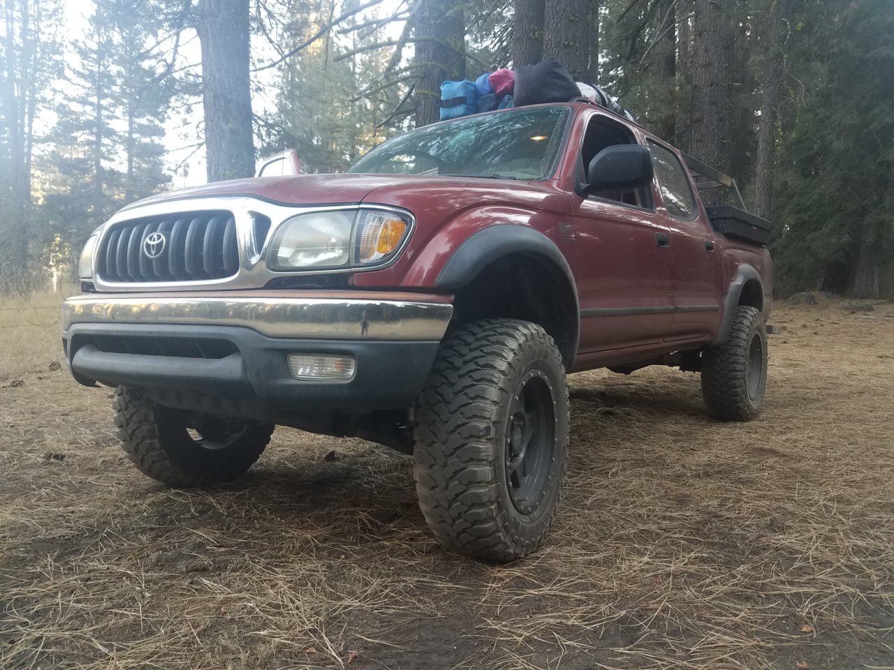

    How recessed are the manual hubs?

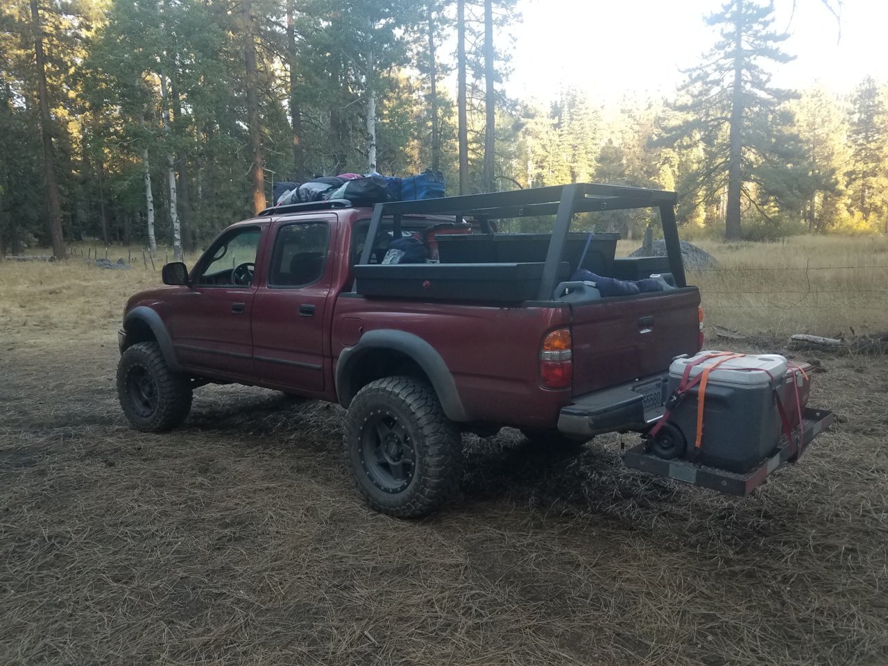

    @BartMaster1234
    This my truck with 1.25 inch wheel spacers.
    Wheels are 17x8.5 with 4.75 backspace
    Tires are 265/70R17
    TrentonTDG likes this.

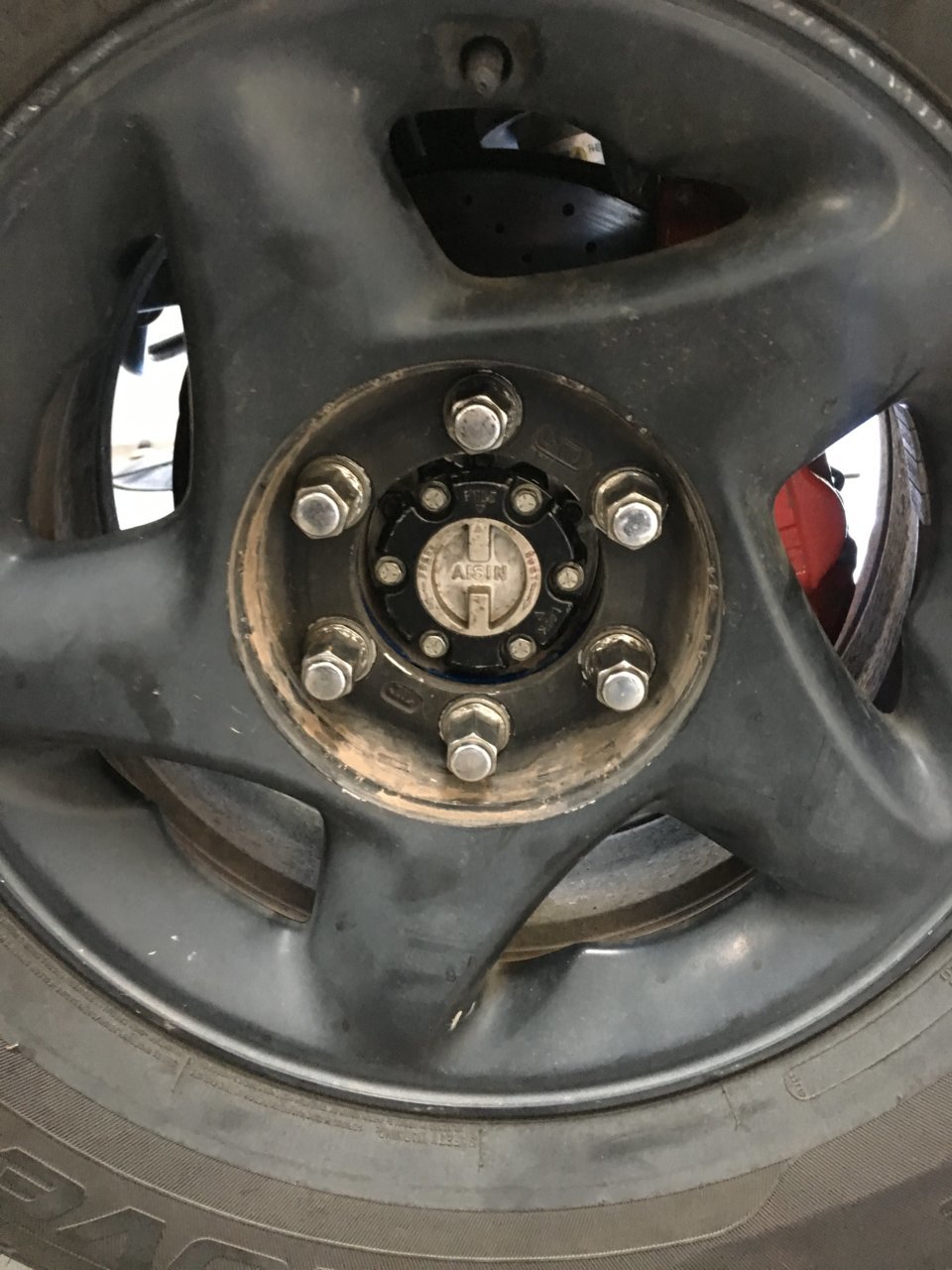

    Don't remember the BS on my wheels, but as you can see they sit very recessed into the wheel wells.

    28,286
    Dan
    Northwest Indiana/Chicagoland
    5.25 or sinthing like that

    They’re decently recessed, but definitely still easy enough to reach and actuate. My front spacers are 1.5” for reference

    Hmm, that doesn't look too bad! It's like it was designed to fit those hubs. You can probably put the center cap back on.

    Yep! I can leave them off, but I like the stealthy look when I keep the covers on. Then when I want to go wheeling, I pop them off, lock the hubs, and slap them back on at the end of the day

    If you want to use spacers, and don't want to have to modify them like I did, get All Pro or Trail Gear lug centric spacers for the front and get All Pro, Trail Gear or Spidertrax Hub centric spacers for the rear.
    Get the All Pro extended thread spacer lugs for the front.
