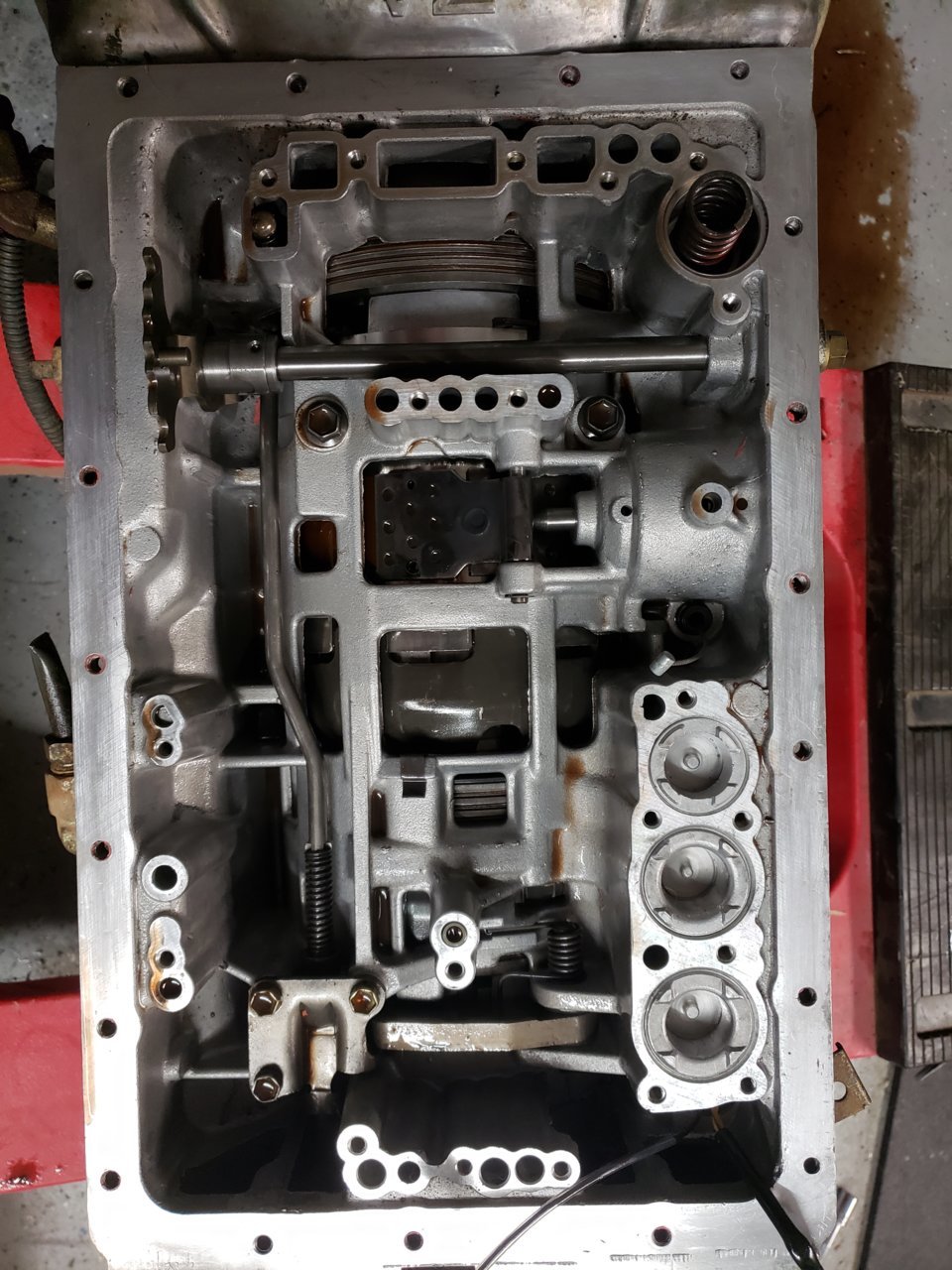

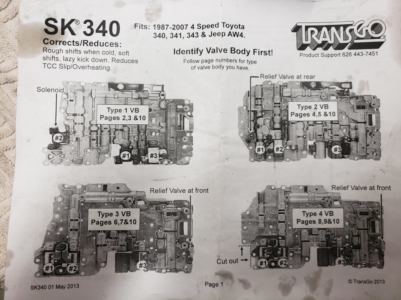

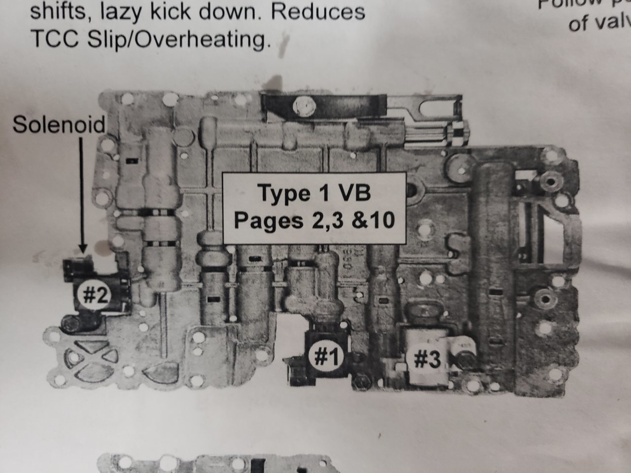

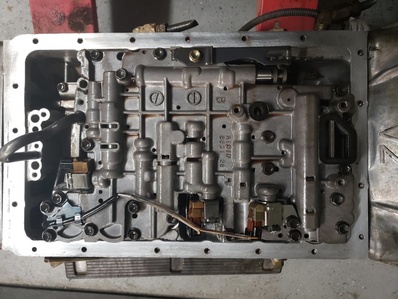

    Well, the shift kit went better than I thought it would.
    The instructions pretty much explain everything. You just have to read through them a few times to understand what they are trying to say.
    Started out by Identifying my transmission (the kit covers 4 variations)
    Mine happened to be Valve Body #1
    Here's my VB
    TrentonTDG likes this.

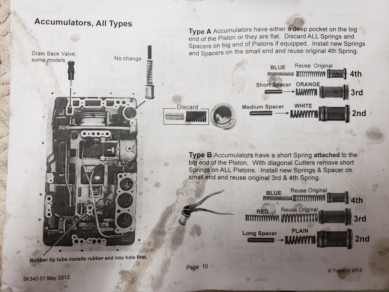

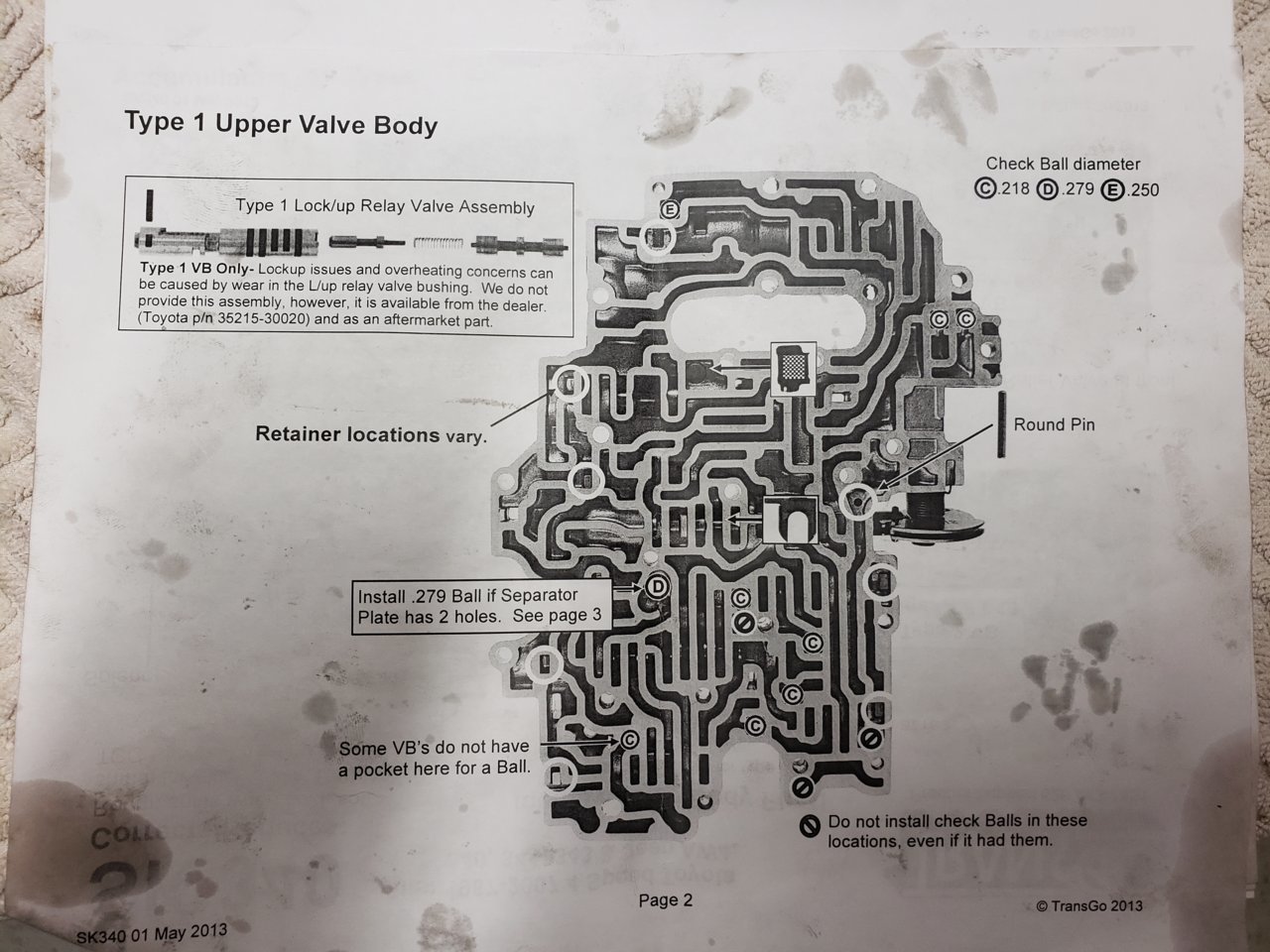

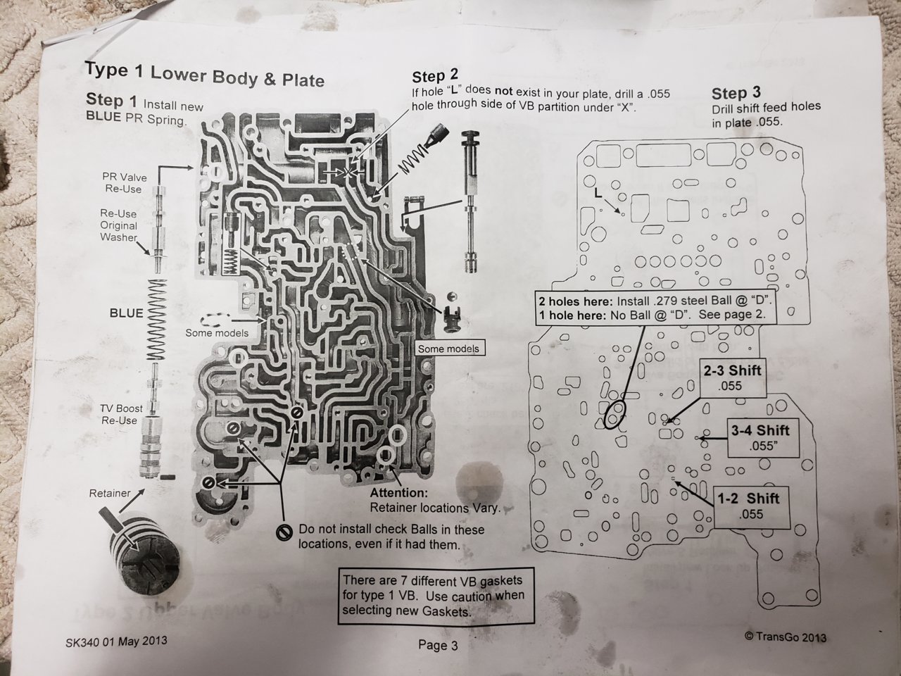

    Here are the instructions that applied to my trans.
    Page 2
    Page 3
    Page 10

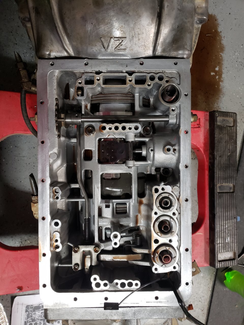

    I started with page 10.
    The kit required removal of the springs in the big end of my accumulators. And replacement of the springs under the accumulators.
    Before
    After

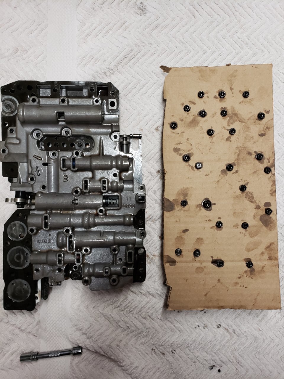

    Then I moved on to the valve body.
    The bolts on the VB are not all the same length. I (half assed) mapped out where the bolts go, in relation to the VB.

    Be careful when you open it up. There are a few things that can fall out. I had it flat on the table and lifted the top side off carefully. Nothing jumped out at me.
    I had the VB on a towel to catch springs / balls that could fall out.

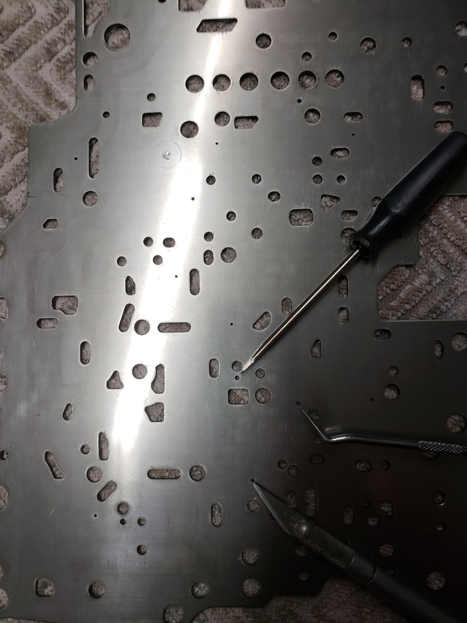

    Had to drill these holes out with included but... It bearly removed any material actually.

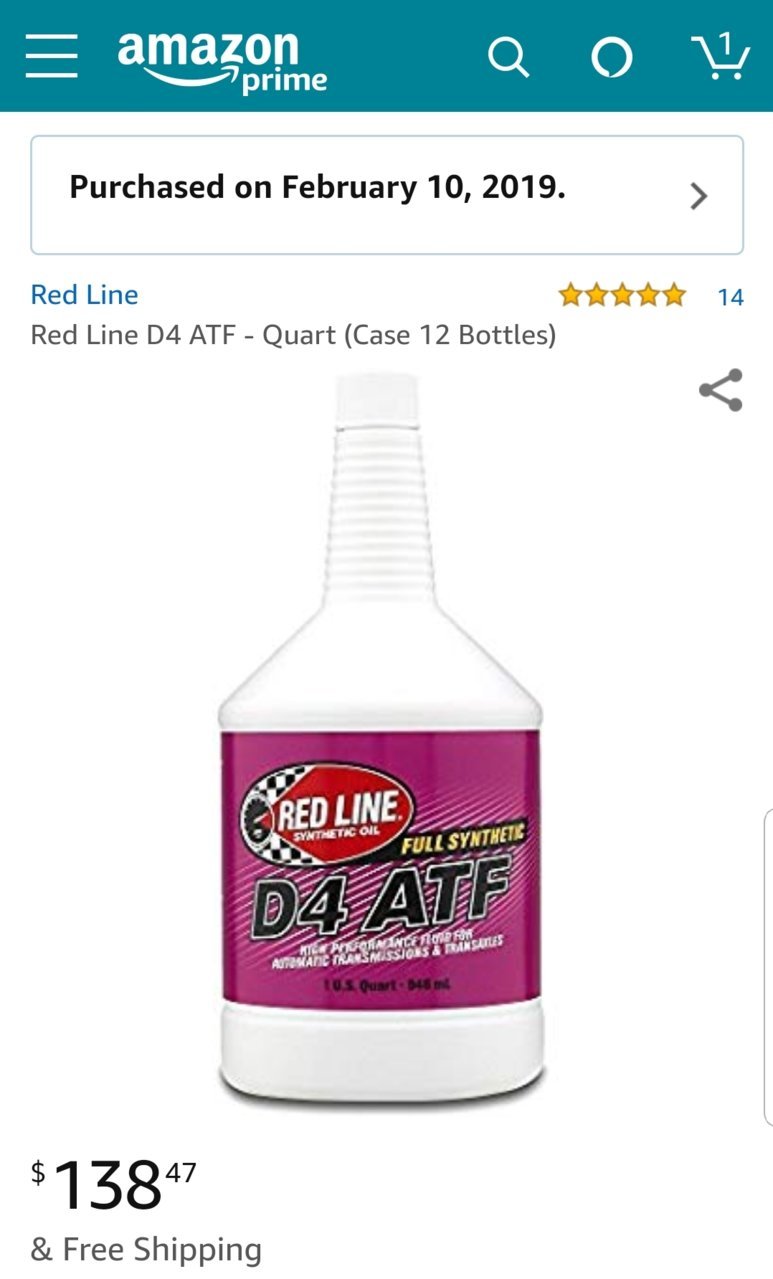

    I went with Toyota ATF and thought that was expensive.
