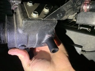

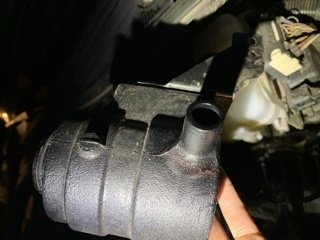

    To those with garages, be thankful. I am attempting this fix right now out in the street in 24 degrees.
    my reservoir doesn’t look cracked, so I’m hoping this will fix my issues with the lower.
    mas for the upper, it is leaking a little bit as well as shown by the crusty coolant there.
    00675FF5-2AA5-48F6-BE0F-FCA5698B447C.jpg F51162A1-1F7E-4DF1-93C9-8F3310A078CE.jpg

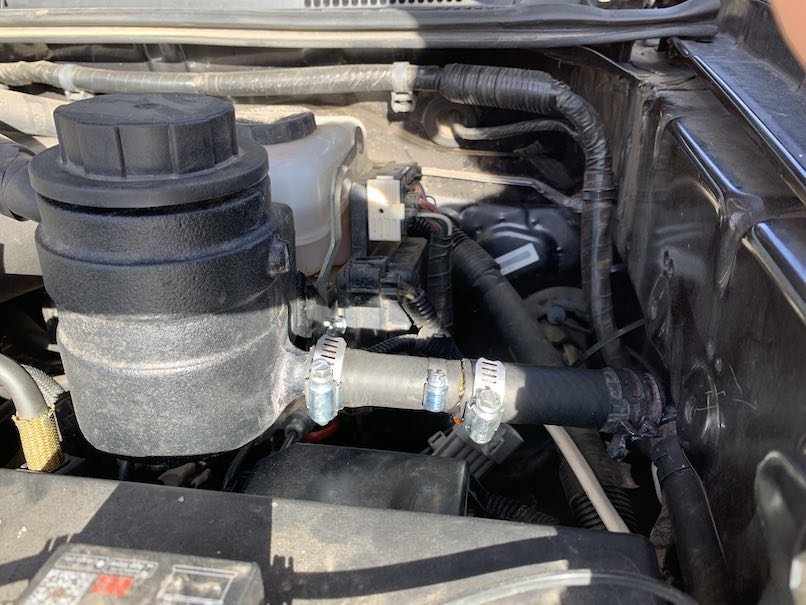

    Well, there was a puddle of coolant a few days ago after the truck had been parked overnight after a drive the morning before.
    Seems as though I was being overly cautious with the clamps on the brass coupler as if it were the fragile plastic reservoir. I have since cranked down much harder at the coupler... No leaks yet as of 3 days of not driving.
    You can see a drip of coolant at the bottom of the coupler/hoses between the clamps:
