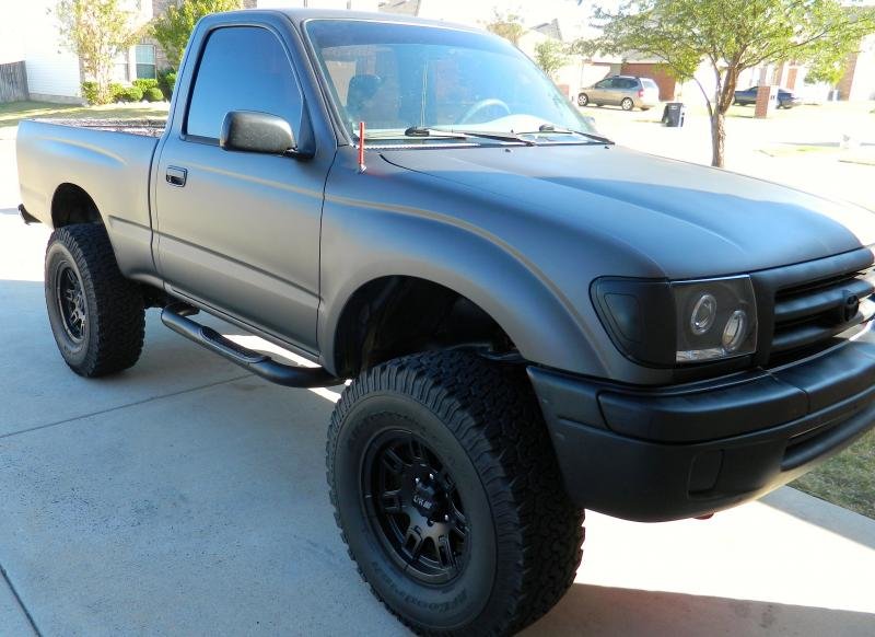

    Okay...New member and its been awhile since I posted....busy working on my truck. Just completed some minor upgrades to the 98 taco...she rides better and looks a little better now.

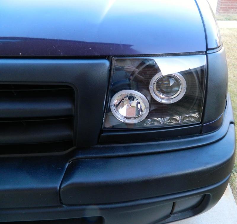

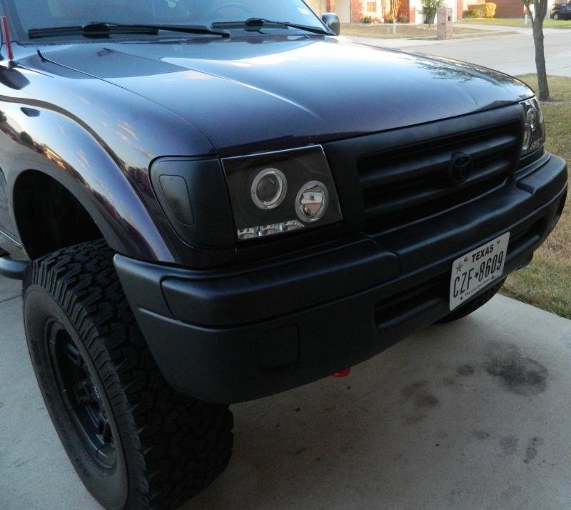

    Put some New Spyder Headlights ...And plasti-derped bumpers

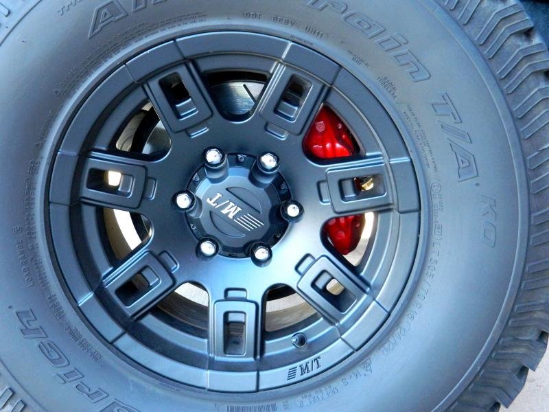

    New Power Stop Front brake pads and rotors ...Painted Calipers..Along with new drum pads and painted Drums

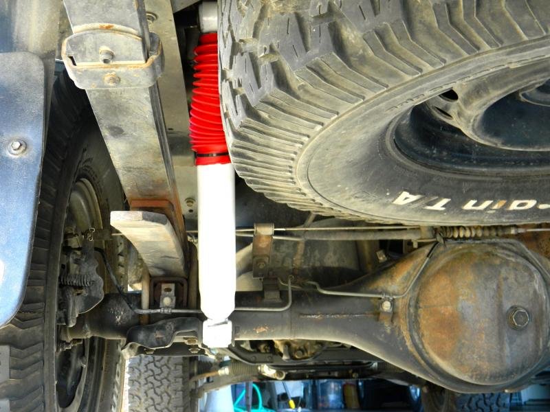

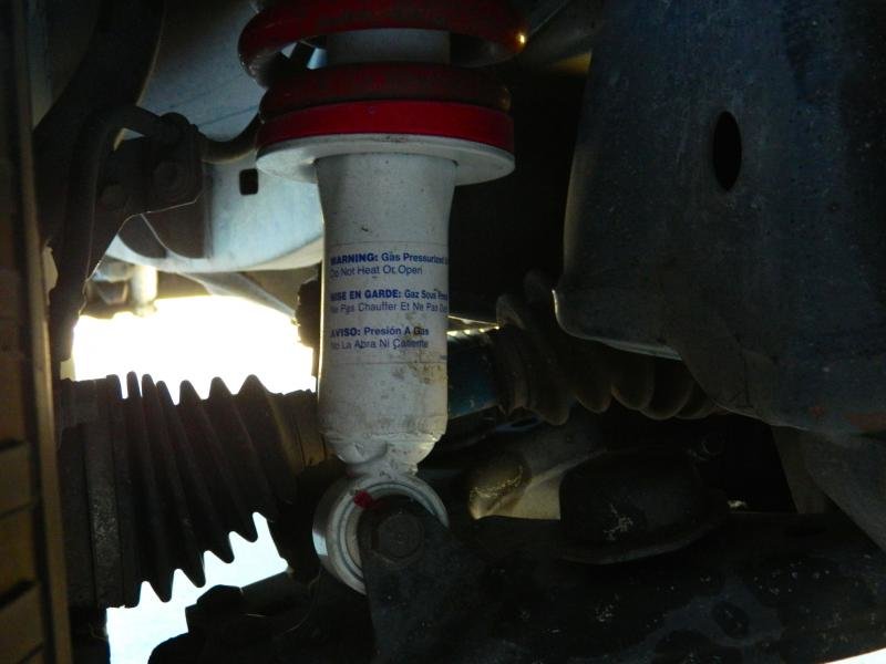

    New Rancho shocks and struts (I am on a budget)

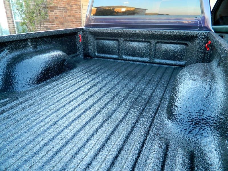

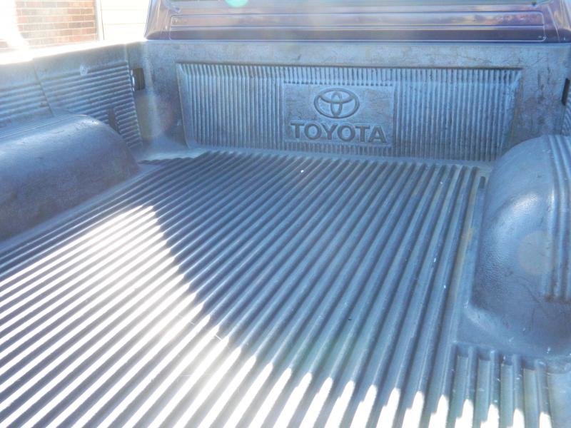

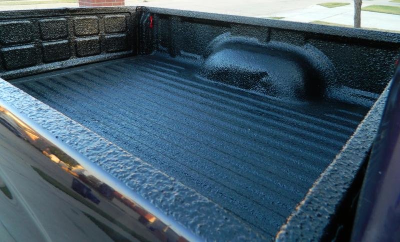

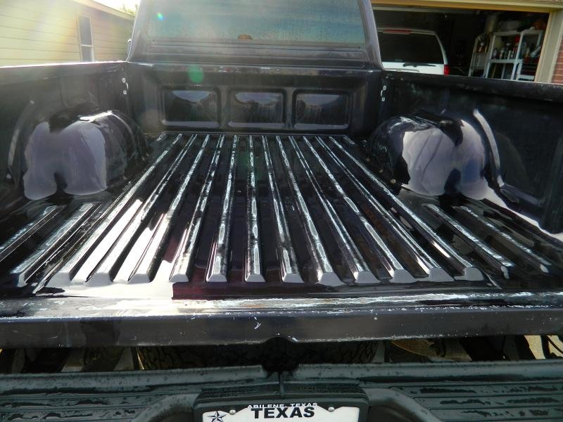

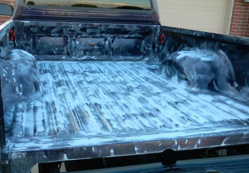

    Finally....took out my nasty drop in bed liner and did the DIY Al's bed liner spray...Turned out better than I thought considering it wasn't an easy spray job....Put some rubber crumb for the rough non slip look and feel. Had to scuff the whole bed and clean it.
    Yeah I know tailgate is bent...Thats character
    Cleaned!!!
    Scuffed!!!
    Sprayed out
    Not perfect..had a couple runs and used two gallons of that stuff but its on thick

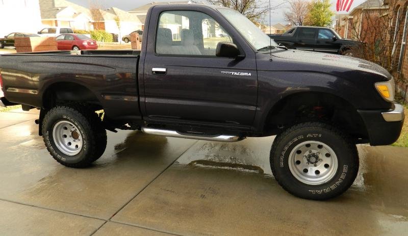

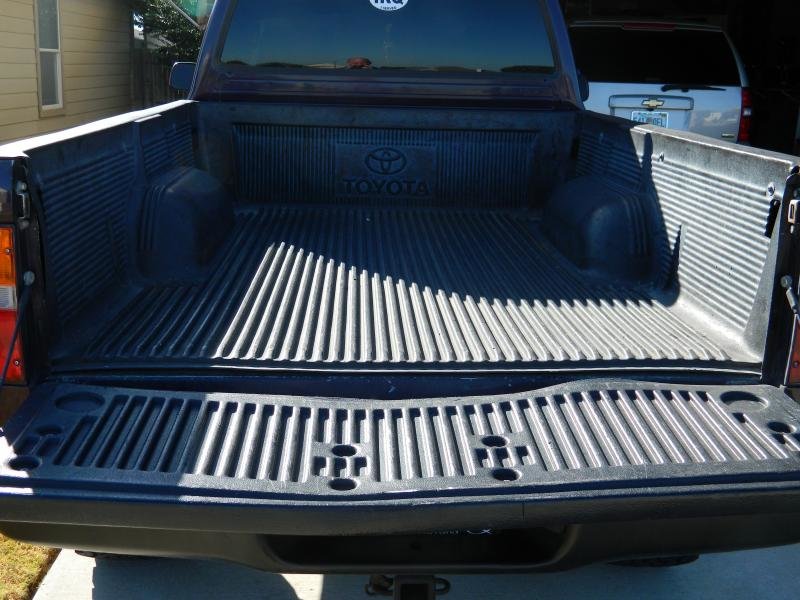

    Coming along pretty good since I bought her ...here are some pics before i started

    Nice bed spray, I will be doing that come summer. You used 2 galloons though? Isn't 1 galloon recommended?
    One gallon was recommended, but after loading that one gallon in thier awkward hopper you only have about a 15 minute pot life. I was not use to the gun so I started sprayingwhat I thought was a resonable coat and by the time I got towards the back of the bed I had some thin spots. Let it cure for a day or two.... tthen cam back and covered thin spots as well as layed thicker coat on wheel wells and tailgate. Much happier with the out come from two coats. I also added the rubber crumb to mine which I thought was harder to spray. Good luck with yours..

    Thanks man , yeah if you go 35s regear is a must though , the plastidip came out nice , I've always wanted to try to dip mine all matte black , did you use the sprayer that they sell and how many gallons?

    Matte black is probally easiest way to go...almost went matte black on mine, but changed my mind at last minute. Definately use the DYC sprayer it worked great laying down the right product each coat. Dipyourcar youtube channel has two good videos on the sprayer itself .(a must watch before spray) After each coat you have to wipe excess dip off the threads and check a few things to make sure it is spraying evenly. Easy job if you take your time to tape off good and use fonzies technique.

    4 total gallons gave me a good six coats in case I want to peal it down the road. Total cost for everything from thier site was aabout $450
