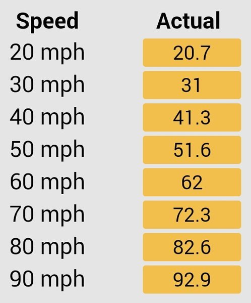

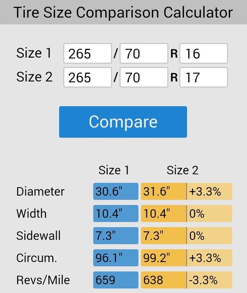

    @DeadEyeWI here is a couple charts showing exact difference in size between 265/70R16 & 265/70R17 and also the difference in speedometer .. hope this helps
